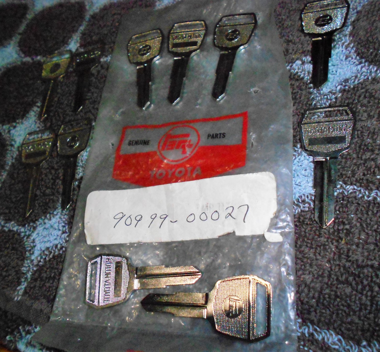

Toyota Japan created the reversible ( 2-Sided ) passenger vehicle key and filed the original Patent on it too ,
the 1967 FJ55 used the short and stubby
90999-00027 ,
the 1967 Publica , Corona & 1000 car models used a slightly longer version from the squared off right angle shoulder step to the front tip
90999-00028
