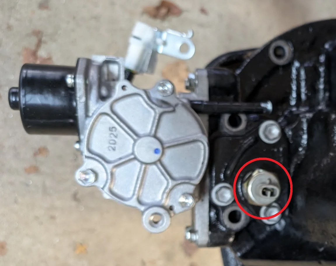

Are you sure the rear is still locked? It could be the position sensor is sticking. If it is still locked try driving in a figure eight pattern.
You can't hit the differentials hard enough to move anythg inside them without breaking into them. Don't try; it's not a starter solenoid.
I'd look seriously at the sensor. At least unplug it and clean the terminals. If that doesn't work, pull it out and make sure it works.
I replaced my rear acuator and sensor last year. It's really not hard at all. Hardest part for me was breaking the rtv seal on the acuator. The sensor is real easy to get to and remove for inspection.

Can anyone post a picture or schematic to help me find the sensor please?
Sensor is circled.
