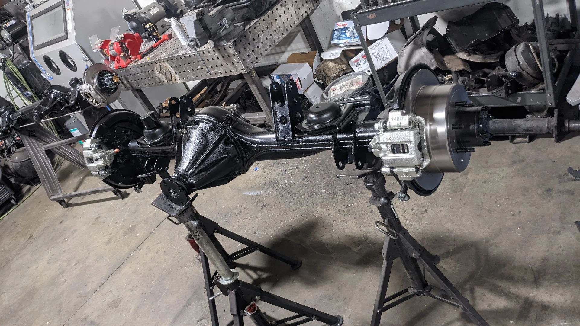

I have OEM style 80 series (same coil dims as 100 coils) new stamped lower coil buckets. You would need to radius them to match the 100 axle profile, but easy enough.
I can send pics on Monday of them.
150.00 a pair plus 15.00 shipping to AK via USPS Priority.
(THESE ARE MODIFIED FOR MY REAR COIL CONVERSION KIT FOR A 60)
