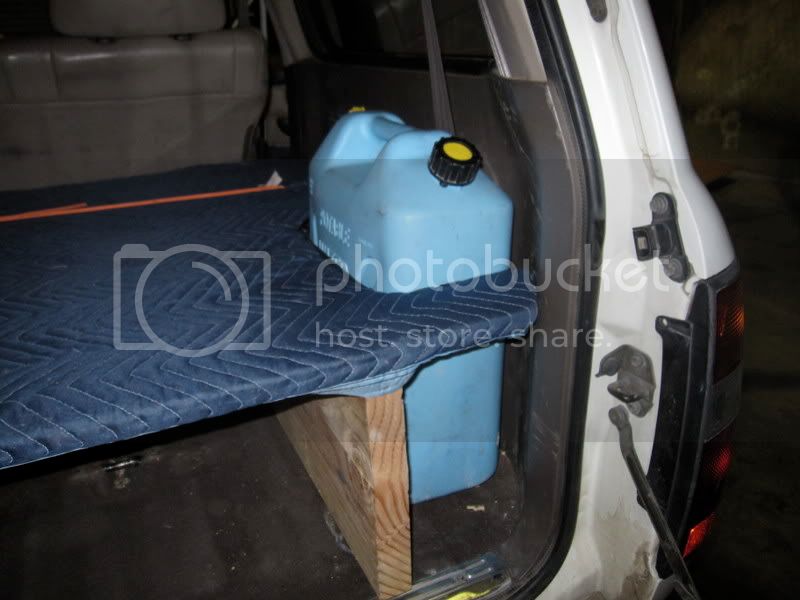

I got out the measuring tape and started counting. Went to Home Depot, and bought a sheet of 3/4" plywood, one 2"x12"x12', and a blue quilted packing blanket. Cost: $53.29
Then, I went to Target and bought two plastic bins, 34"x16"x6", suitable for packing wrapping paper or some such nonsense and stowing under a bed. Total cost: $16.53

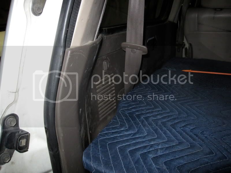

I cut the plywood in one 41"x57" sheet, then cut the 2"x12"x12' into three equal, 41" sections, and screwed them on so that they ran along the space just inside the wheel wells, then creating two equal sized 19" wide, 12" tall, 44" deep compartments. Spread the packing blanket over the top and voila, instant smuggle space, with room to sleep on top.

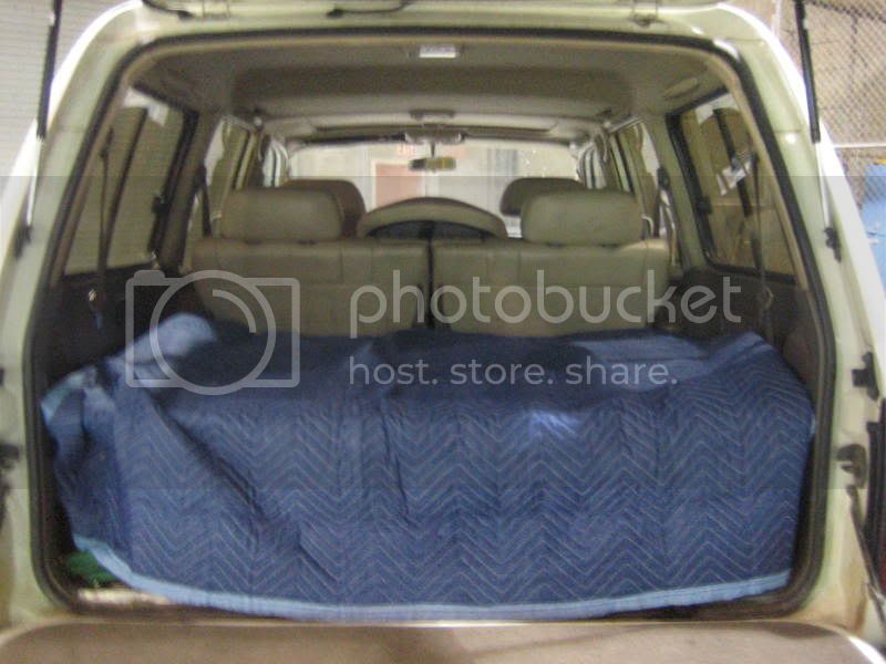

View with rear tailgate closed:

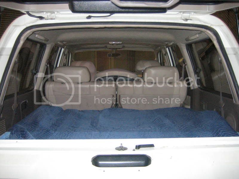

View with tailgate open:

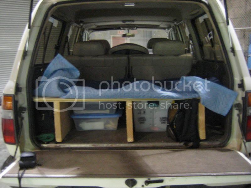

View under blanket:
Two of these 6" tall bins from Target ($7.99 apiece) stack and fit very snugly into the compartment, with a little room to spare.
My plan is to do a couple of cutouts in the wheel well area, to fit the Gerry can, and to better utilize the space behind the wheel wells. I will also upholster the entire thing, using the packing blanket and a staple gun. I considered painting it, in case of fluid spills, but...well, I'm lazy. I will also put some kind of anchors, ie eye bolts or rings of some sort or another, to more easily strap things to the top.

man, that is beautiful. As long as you anchor it well so in an accident it doesn't move (at all) you're good to go. You may want to frame out the end that abuts the rear seats with scrap 2x4 just so the three legs don't sway when you have weight on top. Never overlook the power of ghetto-fab!

Jerry can? with water I hope?
Oh yeah. I don't do gasoline inside the vehicle, ever. It freaks me out and I hate the smell.

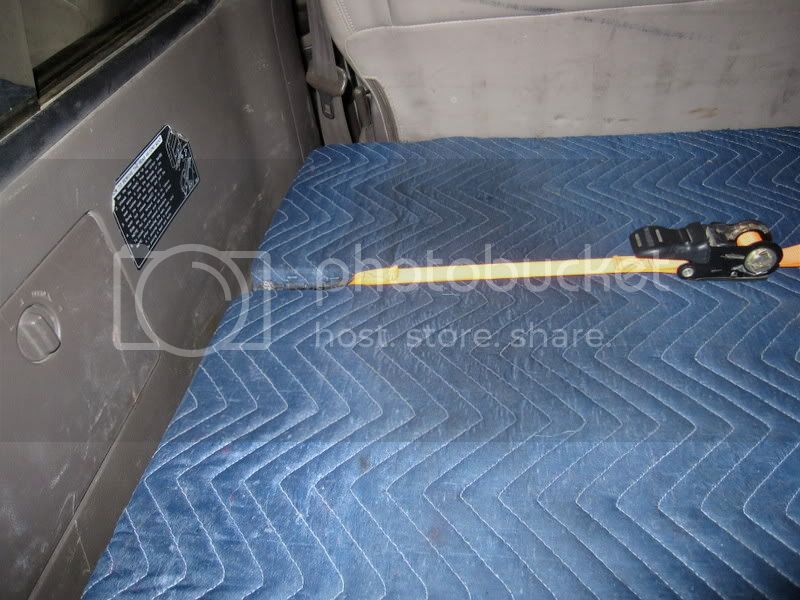

I'm going to do some cutouts , to do some ratchet straps to the third-row seat brackets, maybe a turnbuckle to the cargo tie-downs. To get it in, the thing had to be turned and twisted, in order to get past the thinner entry at the tailgate. At its widest, the cargo area is something like 60" wide. As you move forward, the cargo area thins again at the back seats. The "monstrosity" fits rather perfectly, nestled between the four points fore and aft the cargo area.

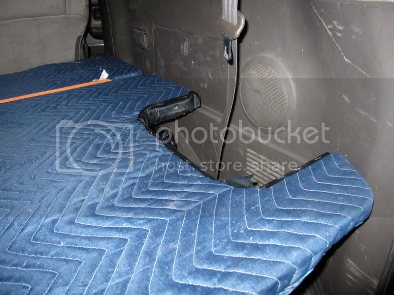

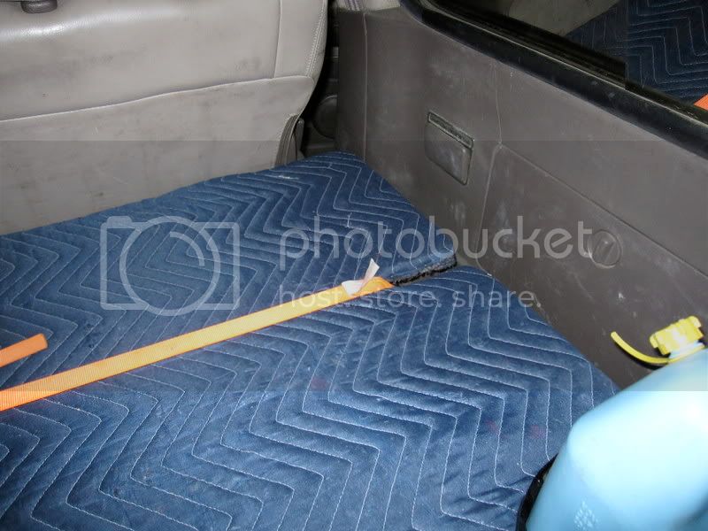

After removing the unit from the Cruiser, I traced the outline of the geri can to fit just aft the third row seat brackets, against the passenger's side rear speaker, and cut the outline out with the jigsaw.
I then trimmed a couple of inches off the driver's side tool bag and jack access door, to better maneuver my hands into that space.
I cut two four inch grooves, rounded, into the mid-fore section just between the geri can stowage, directly over the third row seat brackets, in order to run a more stable and direct line with the strap.
I then trimmed the packing blanket and folded the excess underneath, where I went a little crazy over-stapling the crap out of it. This tightened the blanket enough to keep it from snagging on equipment or door latches. I lined the geri can stowage with gaffer's tape and stapled it down...eventually, I'll get a rubber seal or something for it. For now, it works!

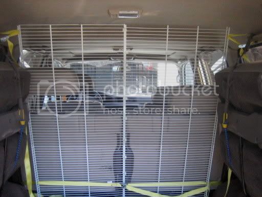

The best ghetto cargo system I've seen yet! Add a cargo barrier and you'd be set.
How about a ghetto cargo barrier?
Yeah but you gotta use chain link fencing for the barrier.:hillbilly:
Well, I did use Home Depot wire shelving. Actually, the system is about half the size now. I use just one shelf, and I've turned it sideways, so that it just covers the space above the seats.
Good God, I am a cheap-ass.
The chain link fence would've been ghetto but the shelving is approaching... marketable. :hhmm:
