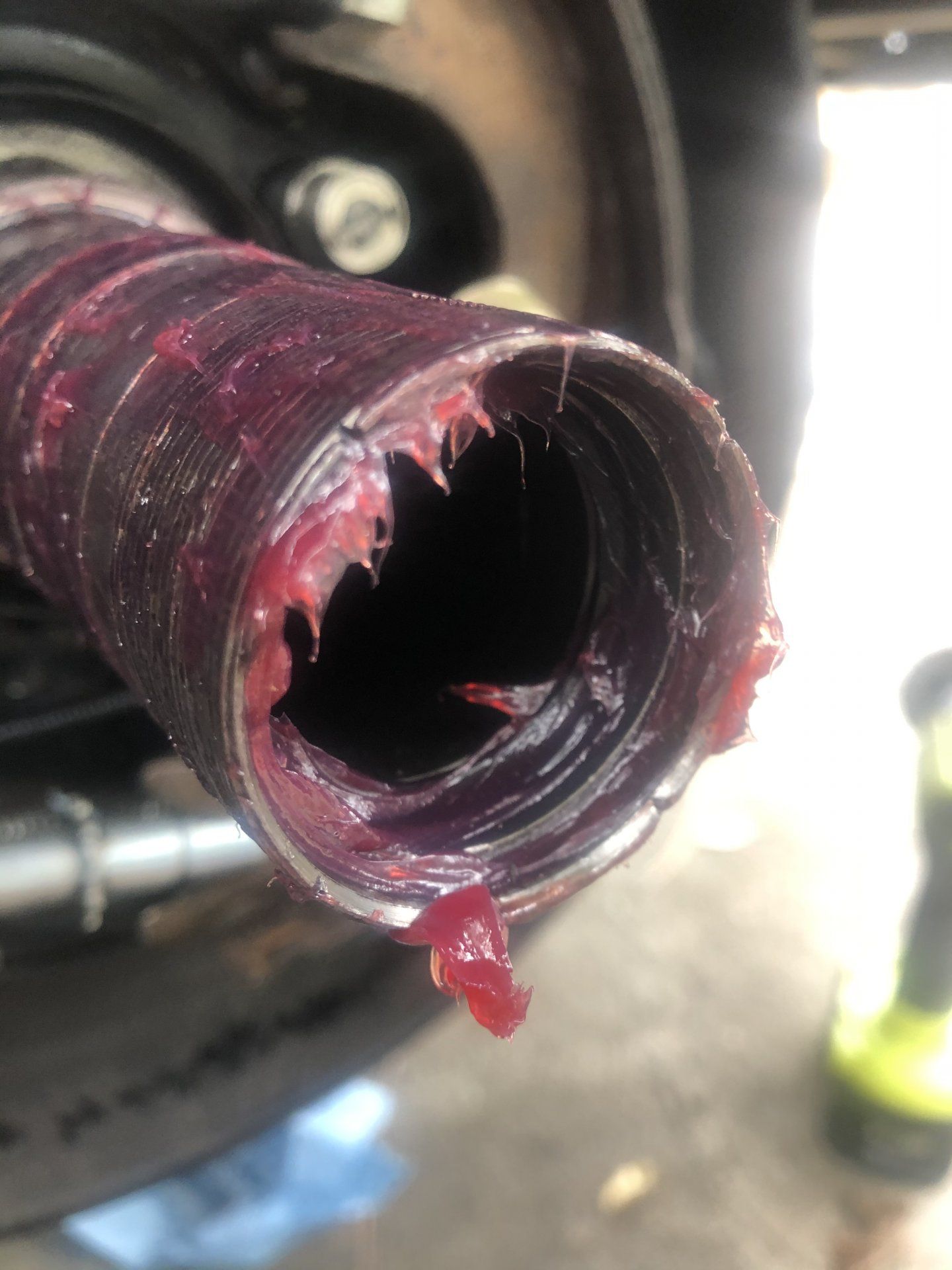

So I double checked what you recommended. The bearing goes on normally and seats all the way when I removed it from the hub. I was just clearly mistaken. I thought the hub needed to close the gap with the brake shield if that makes sense?

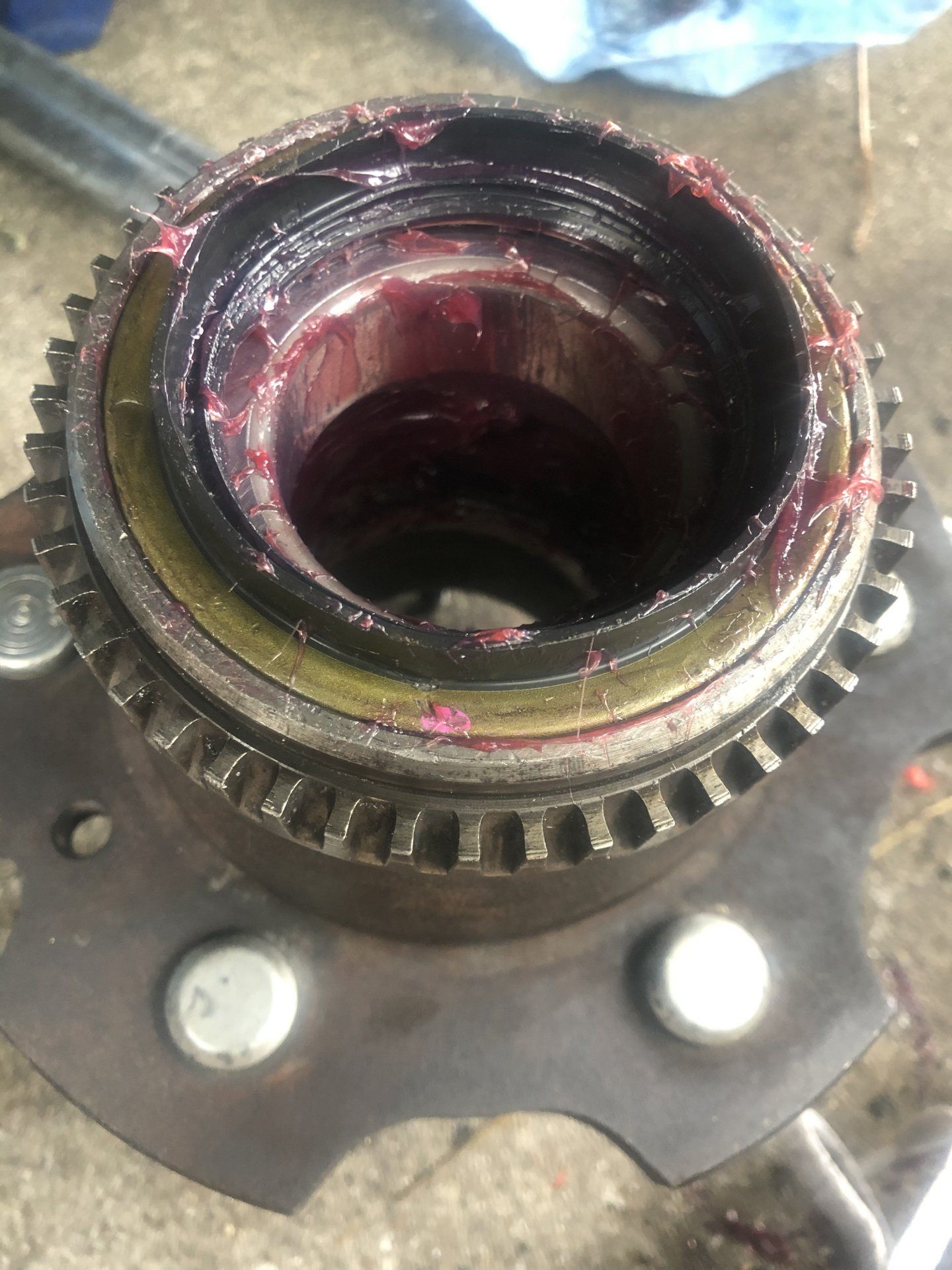

There’s about a 1/4 inch gap between the brake shield and the inner seal on the hub. But the bearings and races are all properly installed. I will attach photos of the seals, hopefully you can give the thumbs up and verify they are both going the correct direction!

It looks like you're hitting the long edge of the seal on the back part of the spindle before it can seat. I'm basing that on the visual on the seal where it is deformed on the wide lip part. It's not damaged, it's just deformed from pushing on it.
Install the outer bearing in the hub while you slide the assembly on, and push with your fingers against the outer bearing to seat the hub. This insures that the hub is going on straight. Also, rotate the hub as you push it on to allow the seal to slide over the seal surface more easily.
The inner axle seal looks fine.
You need more grease BETWEEN the bearings in the hub. Should be about 2/3 full between them. This way the grease doesn't liquify and run out without a "pool" of liquid grease being on the bearings.
There are a few here that have encountered an incorrect bearing part number that has a different edge on it. It does NOT look like that's the case here, but since you confirmed your outer bearing fits, make sure that you inner bearing is the EXACT same number and letter designation as the outer.
