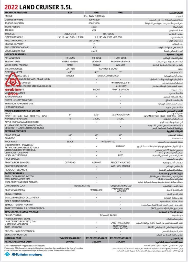

These are the three trims for the UAE on the 3.5L twin turbo. Note that the EXR and GXR come with center and rear diffs, whereas the VXR comes with a torsen LSD (and I presume a center diff lock as well). I'm curious about the other markets. Paying a premium only to get the LSD instead of a locker seems subpar.

VXR has always been the more city-oriented version so the LSD would provide better overall handling than an open-diff. Rear lockers are usually in more off-road oriented models. Yes all models have center diffs as standard.
in the LC200, you can get a GXR with a rear-lcoker (pre-2018), but VXR never had rear lockers.
Is the LSD mutually exclusive with a rear diff lock? And in what way is handling better than an open diff out of curiosity? The Nissan Patrol seems quite popular in the UAE, and they all come with rear lockers as far as I'm aware.

Mechanical Rear lockers & mechanical LSDs are mutually exclusive as the differential internals are different. Some examples, such as the 2009+ Tacomas had auto-LSDs which are essentially ECU/ brake operated (i.e. fancy traction control) open diffs - so you can add mechanical diff lockers in this particular case.
The VXR rear torque sensing limited slip differential is a step above open diffs in managing torque split when you have low traction surfaces (i.e. gravel, snow, rain, sandy road... etc.) where you cannot use diff lockers. Off-road, LSD beats open diffs, but diff lockers are best.

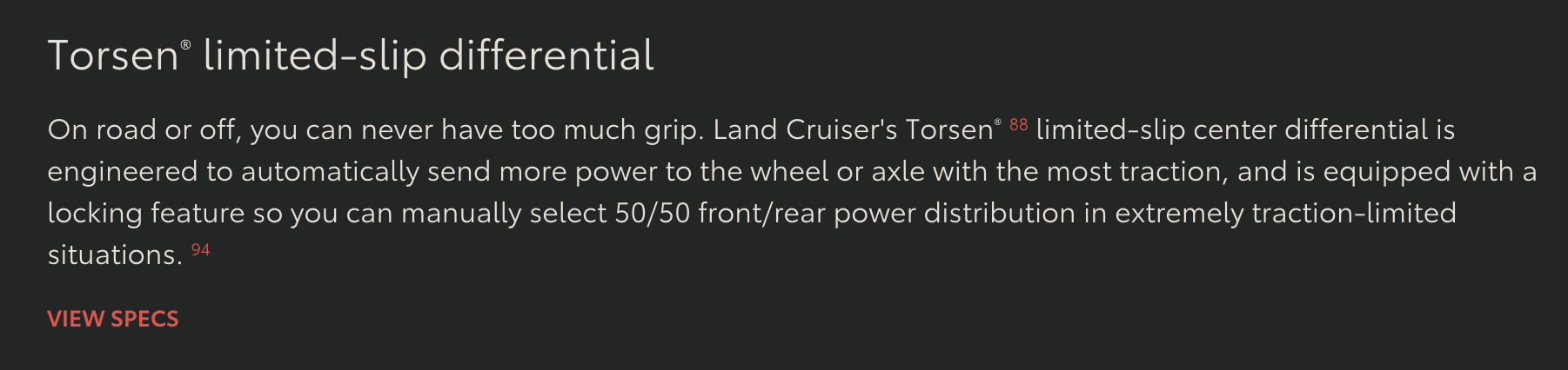

I was looking up the Toyota LC200 website: 2021 Toyota Land Cruiser Features - https://www.toyota.com/landcruiser/landcruiser-features/ and they mention in the Capability section:
So it seems that the are able to have a Torsen center diff as well as a physical locker. In this case, I am inclined to believe that the rear diff in the LC300 VXR is an open diff, perhaps not dissimilar from the LC200 VXR. Which means that it's a cost saving measure not to equip the VXR with a rear locker.
The described torsen center diff with locking is standard in all cruisers, even older models.
The spec sheet you quoted in the beginning is a little misleading, since I can't tell for sure if they mean "torque sensing LSD" for the rear or center diff only.
