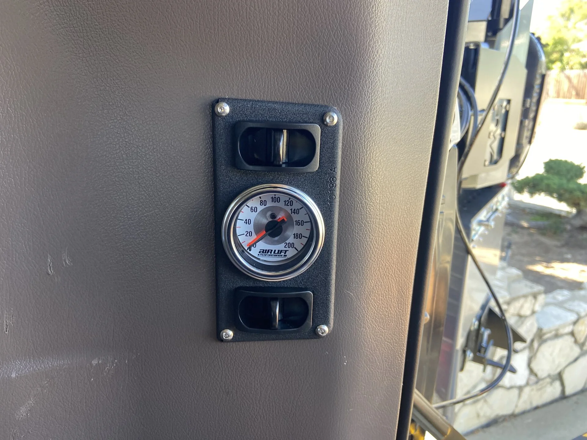

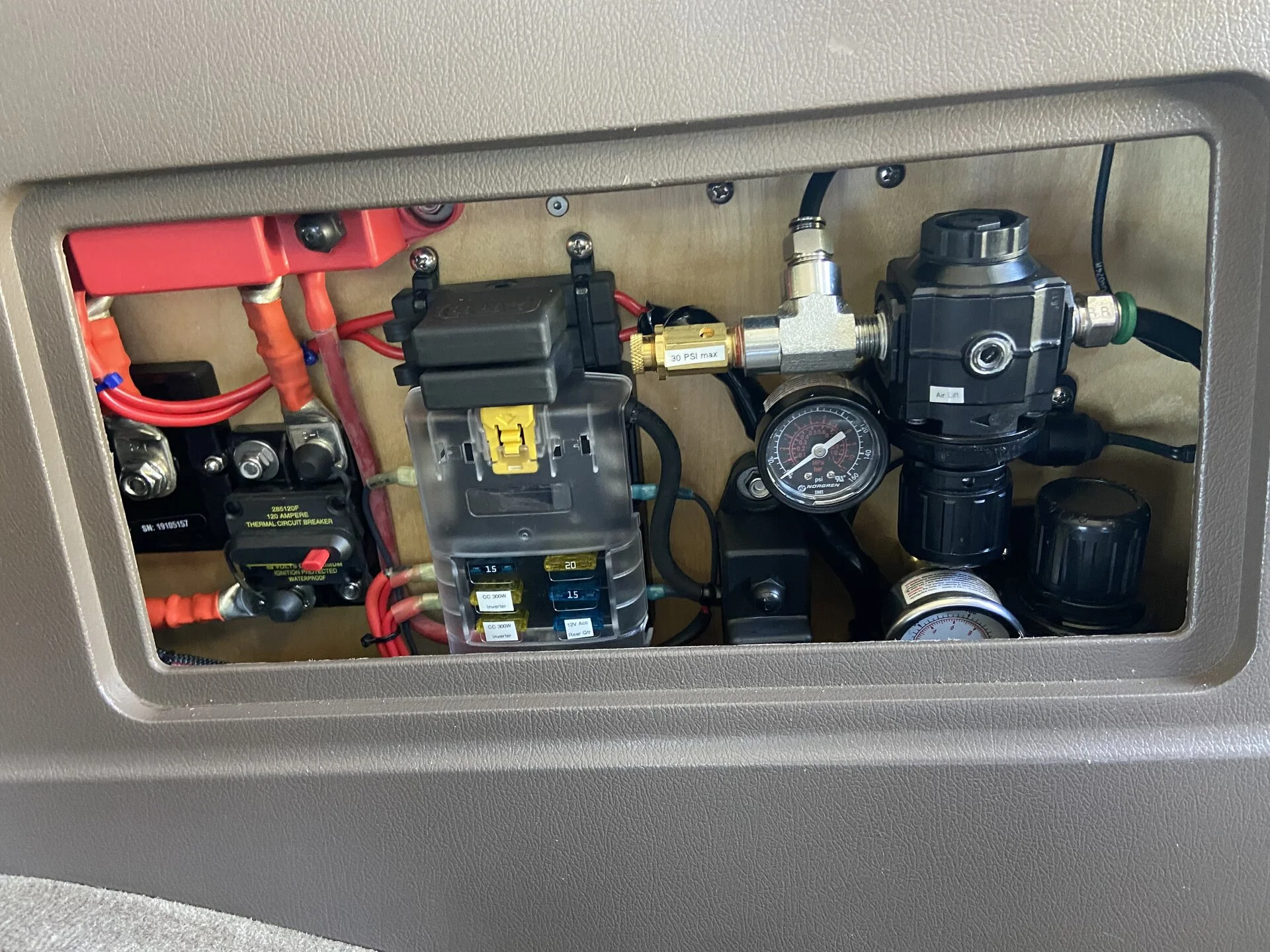

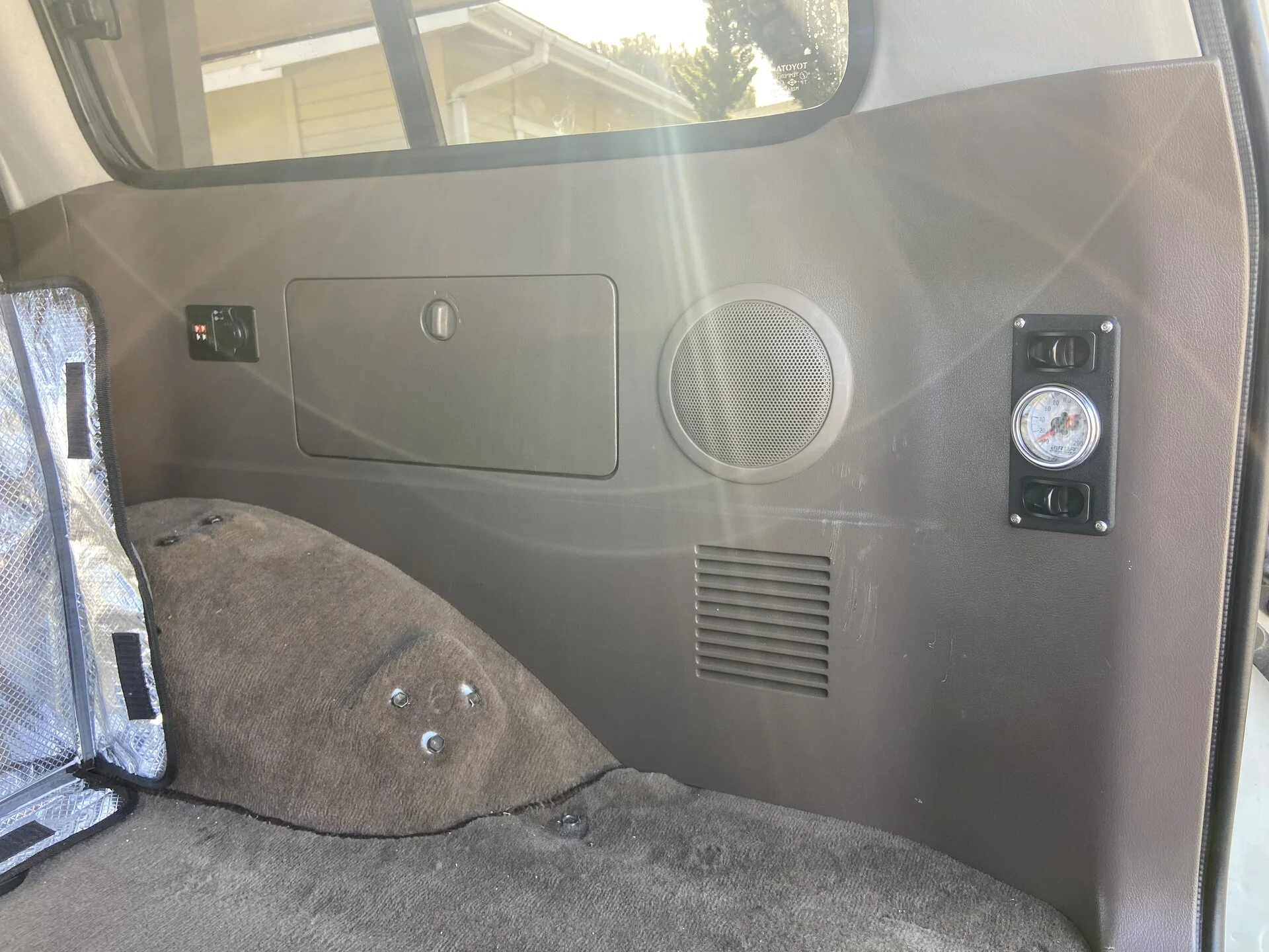

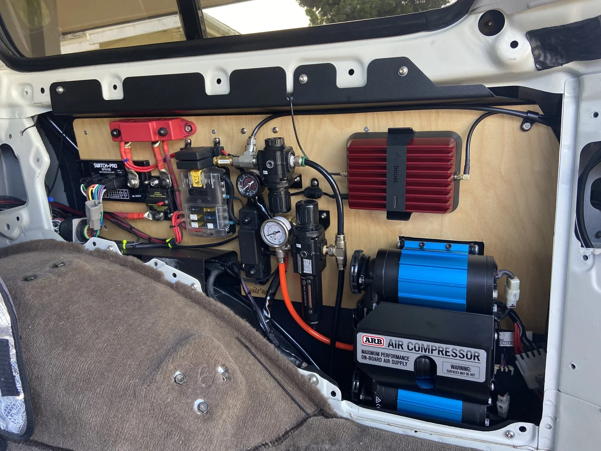

I’m running the 3” slinky HDs with the following airlift bags:
Air Lift 1000 Air Suspension Kit 60728​
Working great so far. I did plumb the air lines from the top, opposite of the instructions. Both bags are on a separate regulator connected to an air lift controller:
AIR LIFT 26229 200-psi Dual Needle Air Gauge​
I used a drilled out hockey puck to protect the nipple on the top of each bag.
I used the shorter bags to give me more suspension articulation when deflated (5psi) When aired up (15-20psi) the bags “stiffen” up the springs to prevent rear end sag when towing. I also added an adjustable blow off valve set to 30psi to prevent over inflation.

View attachment 3371281View attachment 3371282View attachment 3371283View attachment 3371284
