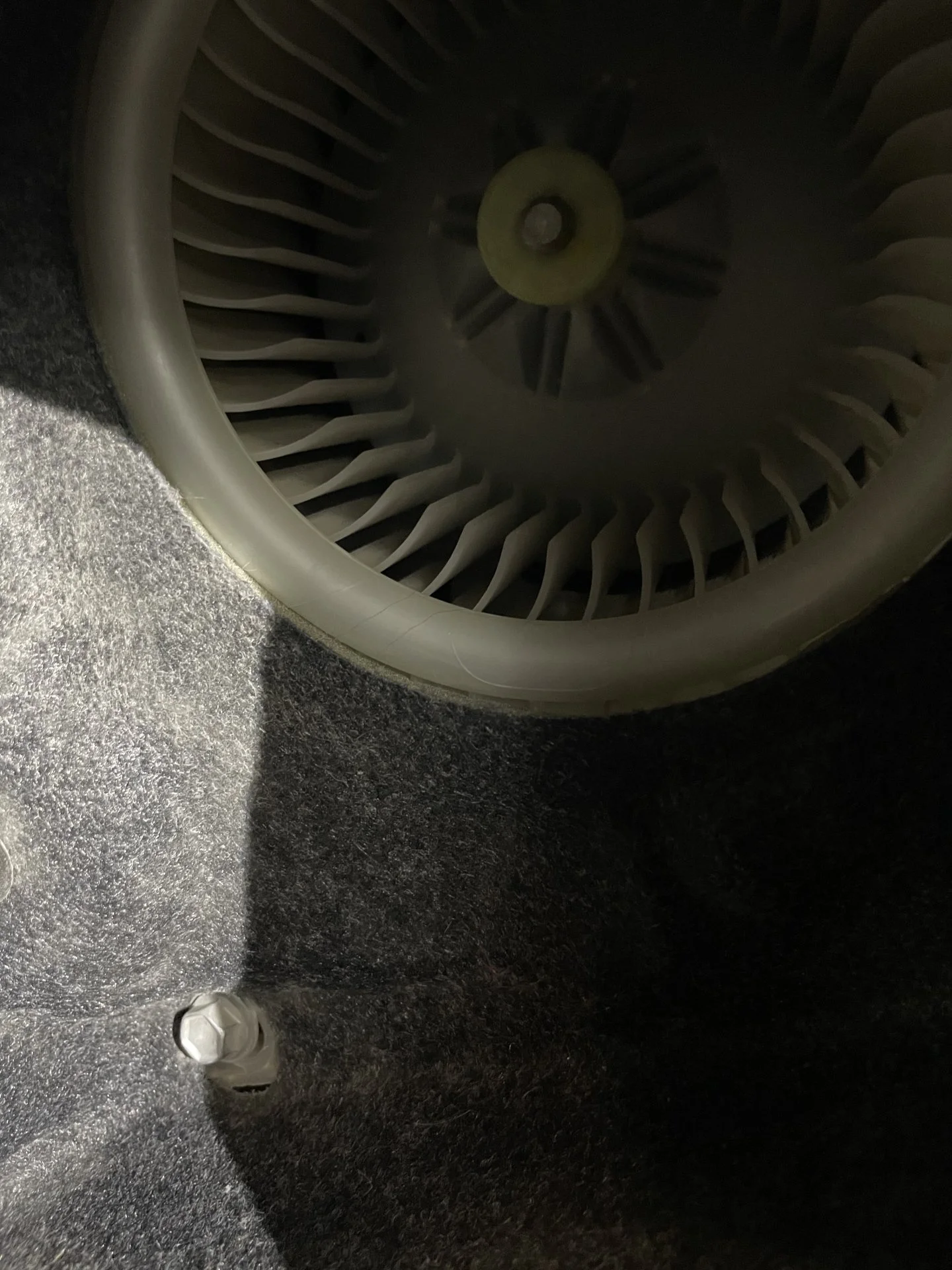

I noticed the other day that the blower in the rear of my LC is much louder than before. It sounds like it is obstructed or something. There is little to no air coming out of the vents in the headliner. Is there a filter back there? Thought I’d ask the question before I start pulling panels. Thank you.

There isn't a filter. The grate behind the left wheel well is the inlet.. you should be able to see up into that with a flashlight to look for obstruction.
Pulled the panel cold air is coming out from blower box but no air out of vents in headliner. Are there blend doors in the headliner?
Thank you for your help. I put it all back together and it started blowing air out of the headliner. Not sure what I did but its fixed. Thanks

I pulled the panel off and ran the system and watched the gears move all worked perfectly. Must have been some alignment issue with the vent pipes. I drive on long spans of dirt road a lot and usually at 40+mph so I’m sure something in there got jarred out of position. Thanks for the help!
