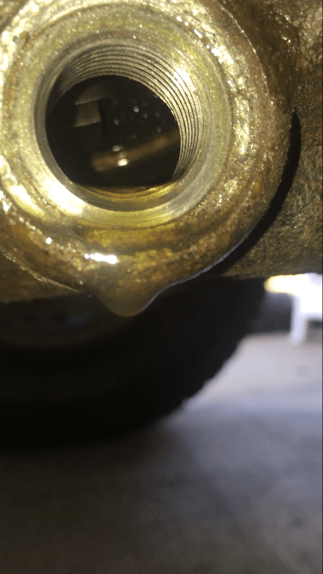

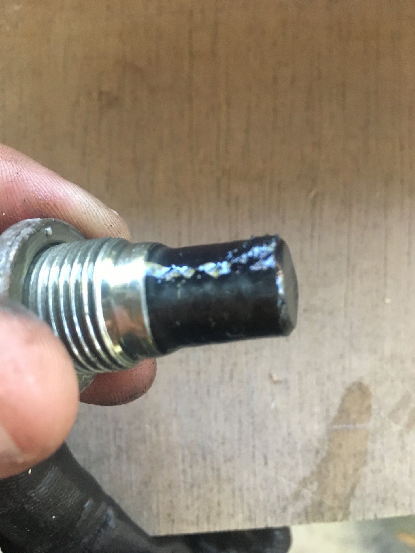

Diff plug.
Having trouble uploading a video. Here is a photo of the drain hole.
Cannot feel any metal shavings or pieces if I stick my finger inside. My fingers are crossed it’s not a gear issue.
