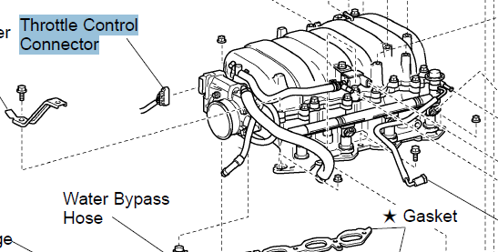

The high idle is a re-learning thing and it will calm down, but the P1125 is most likely a bad connection or a plug you forgot to re-connect. As @flintknapper suggested, go back through the electrical connectors on the air intake and re-do them. Follow each wire connected to the throttle control system and make sure all is well. I bet you'll find a missed plug or one not fully seated.

Yes, check those connections real well. I like to use a little dielectric grease on them. IF you still have the problem, let us know. We can walk you through adjusting/testing the TPS and APPS to eliminate them as a possibility. You can also pull your intake box/hose and note IF the throttle body 'blade' is fully seated (engine off). If not, there's your trouble.

Thanks gents. One connector was just barely not snapped all the way. But all seems resolved and running well.

Oh you know the easiest one to get too! Facing the engine just to the right of the throttle body.
