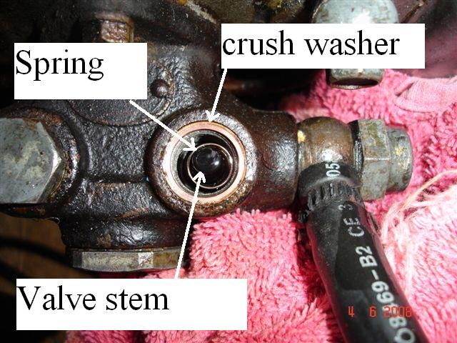

A plastic valve stem pokes up into the underside of the primer pump and you'd destroy that by fitting a bolt! (And without that valve being able to pop-up-and-down correctly - your engine-operated fuel pump would cease to work too.)
I'd remove the new primer pump and find out what you did wrong. (Or whether the new primer and/or washer is faulty.)
I don't think an O-ring would be satisfactory and I'd be reluctant to use thread seal tape (even as a temporary measure) in case any enters the fuel circuit and harms the operation of those two non-return/check valves.

No way!!!!!
ok, well then how do you explain this, and it all works prefect never had a problem with it
Well I don't think they can be ordinary "bolts".
I suspect they must be "special plugs" with "recesses" machined into their undersides to accomodate the springs and stems belonging to the non-return/check valves.

lol no there not ordinary bolts, i should have specified.
and its the exact same bolt on the left side of where the primer pump would go
Ahhhhhh. Well........Errrrrrrrrrrr. :hmm:
You do have an inline-type of injector pump on that 3B don't you?
Because if it is the rotary-type, then I believe your fuel pump is inside your injector pump rather than being inside that housing where you have those BOLTS.
(And the absence of a fuel pump is the only explanation I can think of for why you don't have those springs and valves!)
:cheers:
PS. I find it easy to fall into the trap of assuming we are dealing with similar engines when we aren't. One 3B definitely isn't always the same as another!
