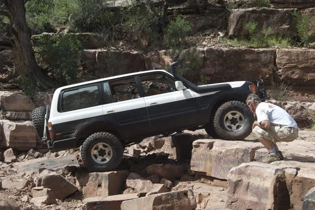

Just about all Arizona wheeling is about rock, the state is made out of the stuff! Most isn’t a big issue, small stuff i.e. sand, big round stuff, it’s the bigger square stuff that requires care. This trail is known as the shaft (and a lot of other things) eater. One of the keys to getting through without damage is spotter placement, most of the time along side of the rig telling the driver where/what he’s going to hit.
