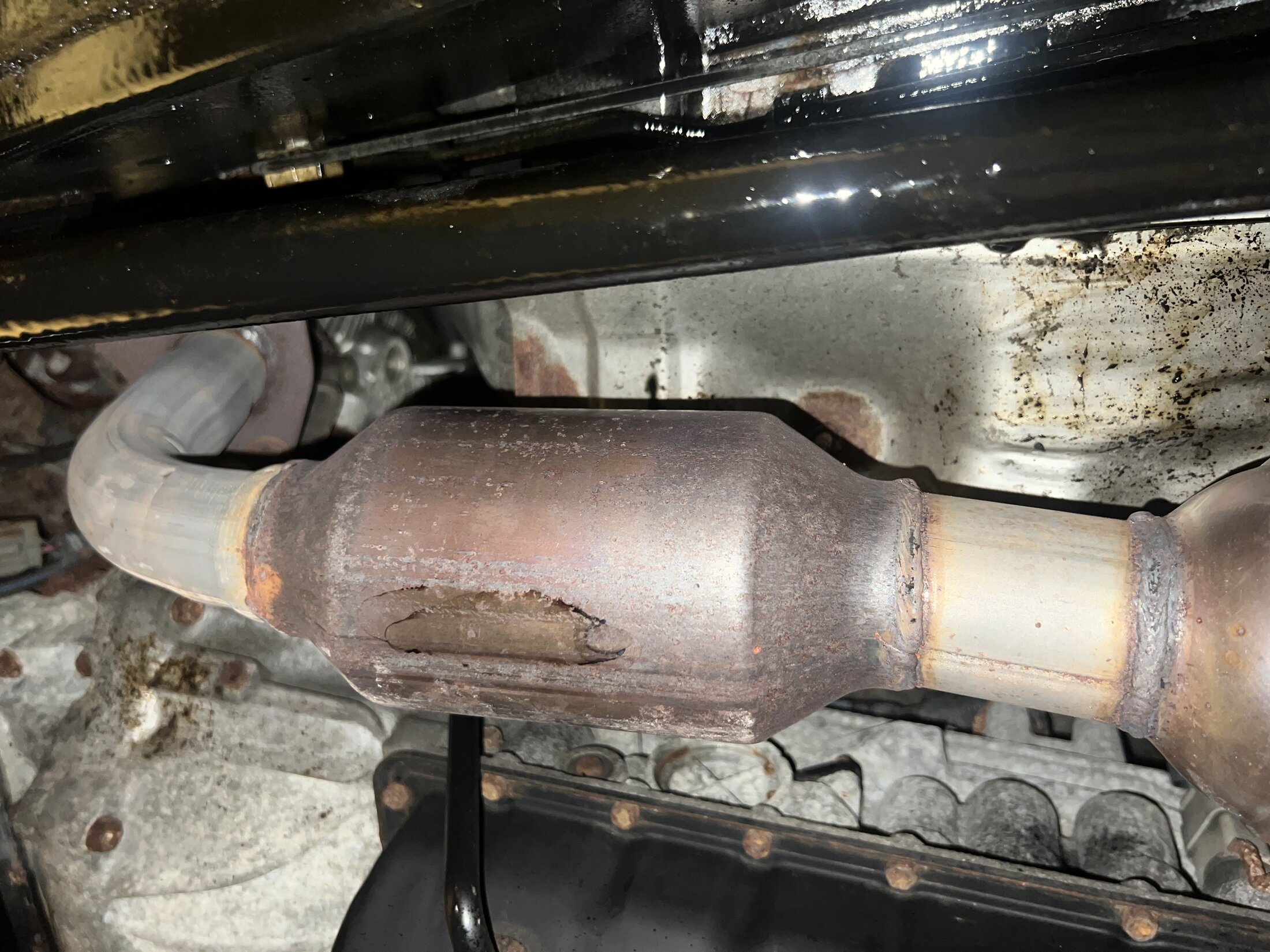

Check the heat shields on your cats. The welds rust and break and they start rattling.
Cats seem to be fine though. Even after a good shake at the pipe, no sound at all
