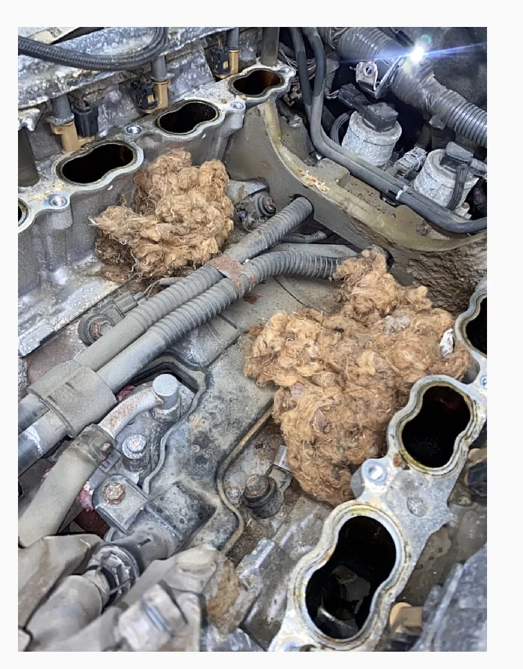

Woke up to a flashing dash lights/CEL and took the vehicle in. Rats chewed knock sensor wires and have been making a 5 star hotel rats nest under the intake manifold.
The mechanic noticed the the notorious valley coolant leak happening and $1500 to fix the valley leak along with $800 for the intake manifold pull and reset.
Is this reasonable? Should I get it replaced while they’re in there? Not sure if this is high or standard. Thanks. Pic of rats nest for fun.

Called me back and said they found rats nest under intake manifold via a camera,
Then quoted $800 to pull the intake manifold, then stated that it could be up to $200 to replace the wire.
They found a chewed up wire and will be fixing that. I asked to waive the inspection fee and they’re giving back half. So all in for about $1100.
They noticed the valley coolant leak which would be in addition to the $1100. So $1500 + $1100

So you ok'ed the $800 then.
Personally I wouldn't run a UR long with a known coolant issue so I'd be inclined to fix it whether you pay for it now or DIY it as soon as you can.
For sure. They had to pull the intake manifold in order to gain access to the knock sensor wires. How hard is the diy route on the valley leak?
It’s not hard. Just somewhat tedious and time consuming. And you have to deal with the exhaust air injection valves, which can be a PITA due to limited access (especially if you don’t have small hands). There are a few threads and write ups on the subject (search “valley coolant leak”). Plan on spending a whole Saturday the first time you do it. The 2nd time you’ll do it in half the time.
