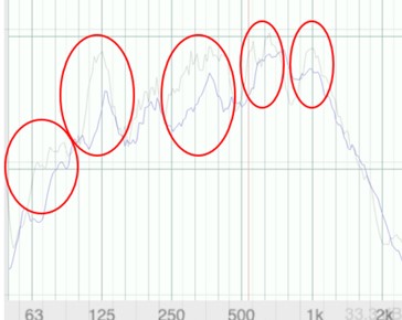

I made a composite picture that shows the difference between 456 gears (light grey line), and my newly reinstalled OEM gears (blue line). The random harmonics are circled in red.

You didn't mention how the sound was to you while driving, regarding being annoying or not.
Bottom line... are you happy? It's all about what works best for you.
Unfortunately it was way too annoying for me, so I went back to 391s. I'm happy now that I'm back with stock gears, although I do miss the pick up and reduced low range speed with the 456s.
