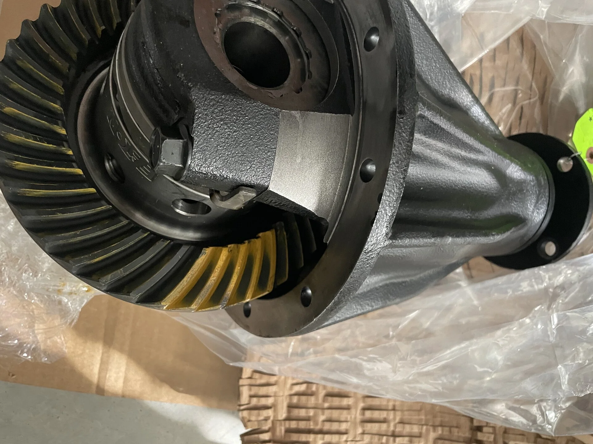

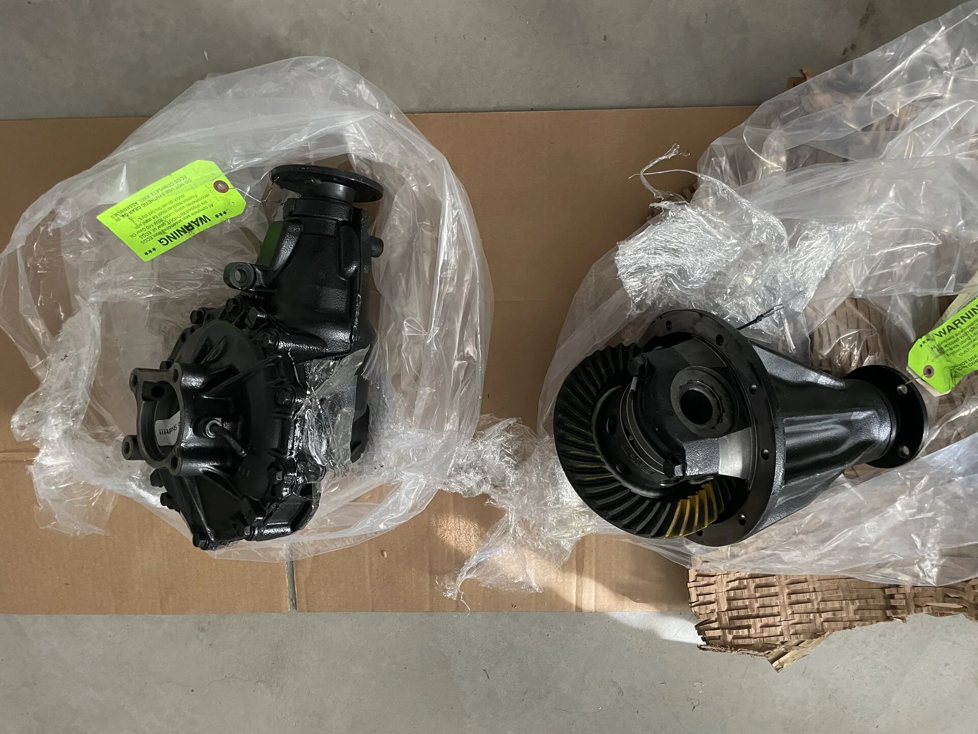

Geara and lockers arrived today from ecgs!

As far as the patterns on your gears - I think they both look on the deep side (pinion depth set for deeper gear mesh). It's probably stronger and a bit noisier with higher tooth contact. I setup might a bit shallower to be more similar to OEM gear depth. Here's the wear on the oem T8.2 from my 4Runner diff:

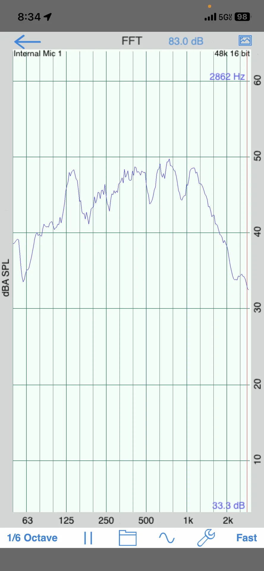

Shot of the harmonic noise on coast. Like I said… it’s pretty mild, but there is definitely a harmonic in place. Also iPhone microphone is hot garbage , so it’s a noisy plot.
