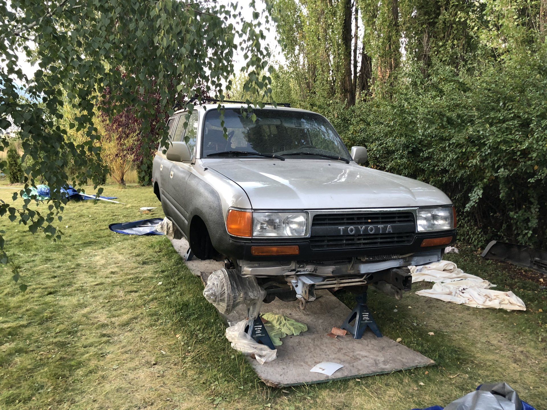

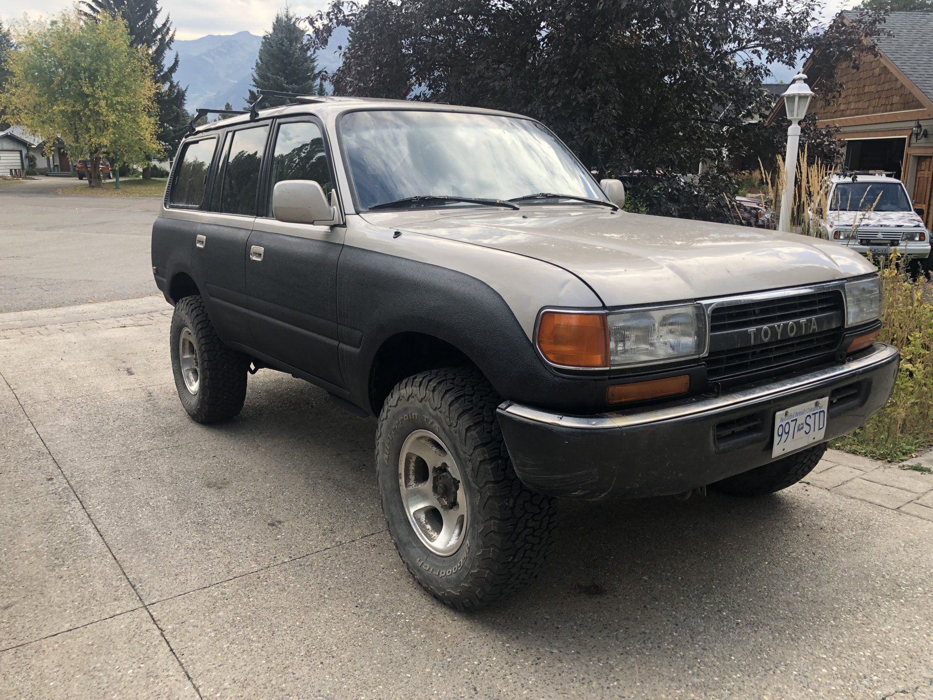

Just finished raptor lining the bottom half.
Started the job because of rust around wheels wells. If you have not removed your fenders run out and do it before the body rusts beneth them. I put it off for years and regretted it.

Awesome! I definitely agree on the flares. Mine was a relatively rust free example. I wanted to be one of the cool kids so I removed my flares. The 1st three were fine underneath. The drivers side front had one spot underneath with a lot of rust. Grinder and 5 coats of primer later I saved the panel. If it went another 2 years it would have been really bad.
I am currently deciding on Monstaliner colors as well as taping or welding the holes.
Your rig looks great.
How much raptor liner did it take? I have a kit that I have never used and i wanting to do this as well .
Fumes will be gone in a week.
Thanks all.
Used 5 cans of Raptor liner. May have been able to get away with 4. Spent a loy of time testing on cardboard and some in wheel wells.
