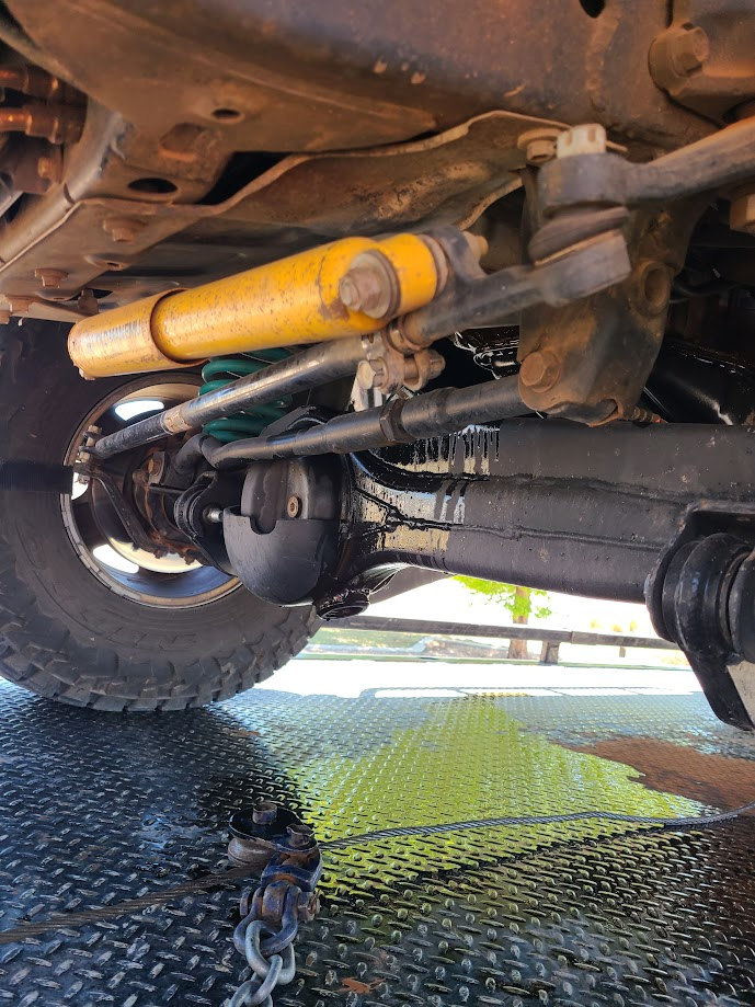

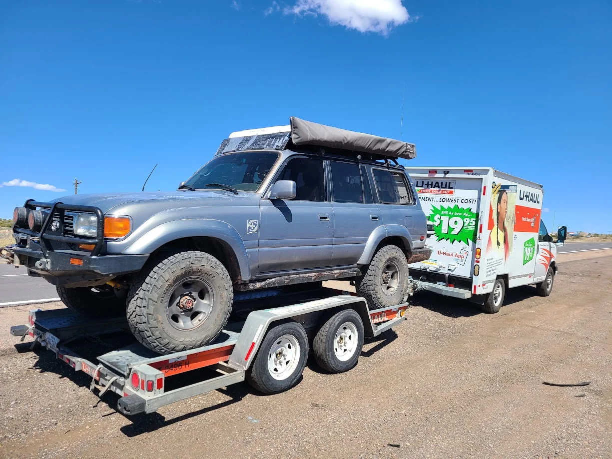

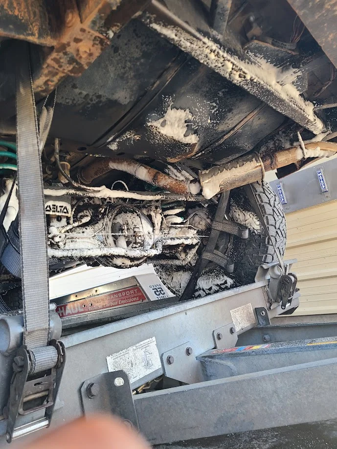

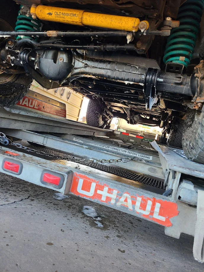

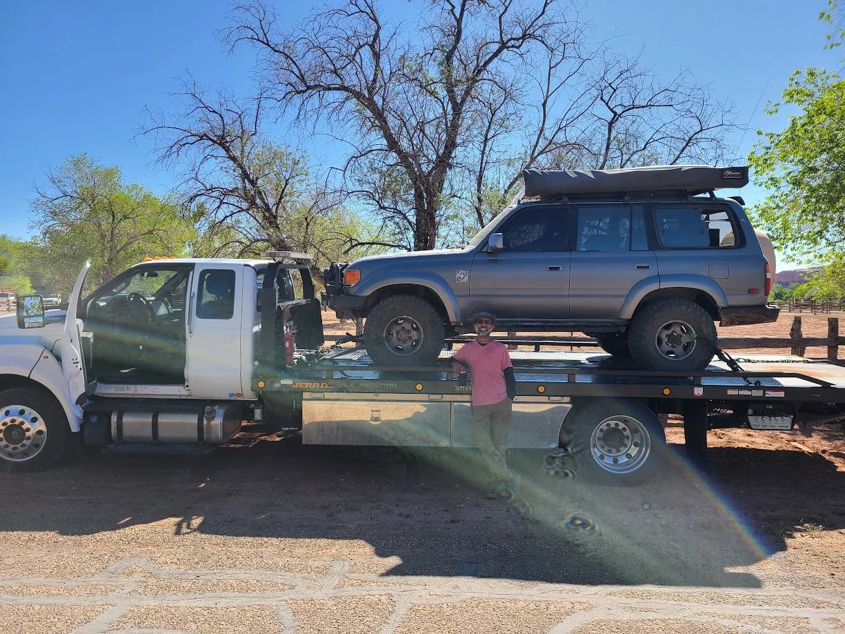

and finally, just when I was having way too much fun on my way out of john's canyon trail, I hit a wash a weebit too hard. My trussed axle gently kissed the oil pan #2, aka "engine girdle" and a hairline crack appeared about 5' long. This oil pan #2 is made of cast alum so let me see if I can TIG it up this weekend. If I had put the bumpstops back in, this would've have happened.
I used my AAA+ to get a free tow to Bloomfield, then Uhauled it home after that. BTW, tow company had to charge $7 per mile for 18 miles over the 100 miles allowed. I might up to up my AAA to Primere coverage for 200 miles.
this oil coated the entire undercarriage on the drive from trail head to Bluff, and I went through two quarts of oil and needed two more but didn't have any. That was the first time my "oil level low" indicator light came on, which gave me a slight heart attack.
Three cans of engine degreaser at the car wash hopefully removed everything but I'll find out soon enough when I dig into this project.

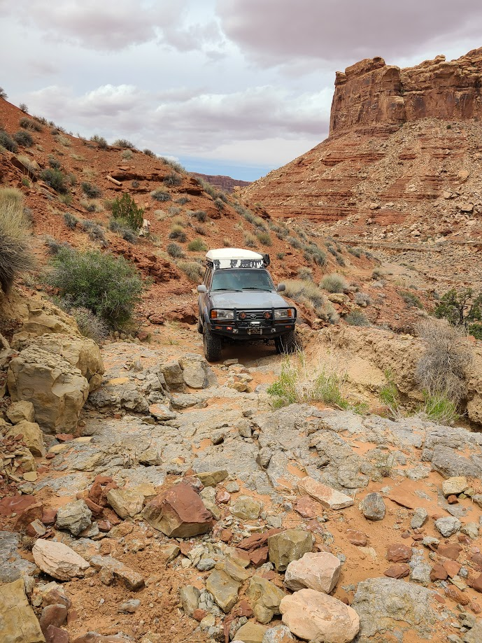

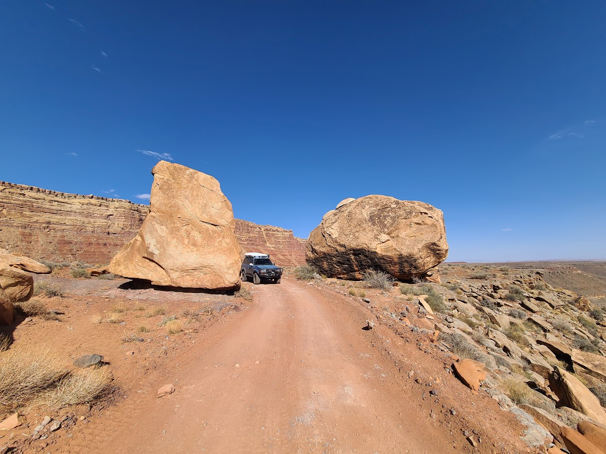

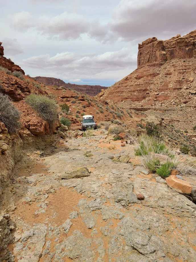

back to the story, somewhere near the end I was questioning my choices. I really should've walked up and assessed the off camber climb up, then climb back down. I survived. Thankfully the edge was pretty solid when i opened the door and looked down. The bush is on the edge right below the door.
Anyway, another lesson learned. Walk ahead and check things out before you HAVE to climb up, then turn around. There was this giant boulder that fell in the past sometime!

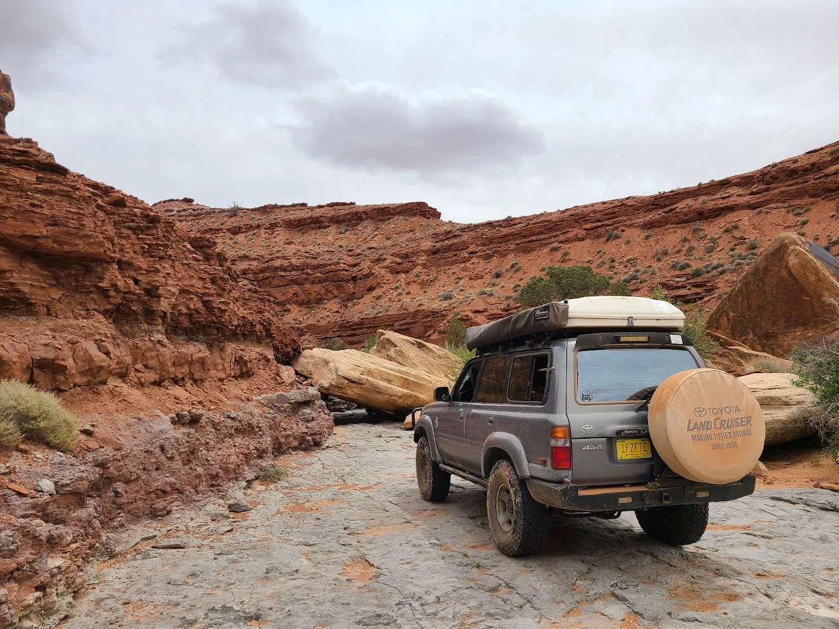

As I was tooling down the trail, I was asking myself "what would happen if I hit one of these washes a little too hard. Would I have front coil springs bind up? Would the axle housing hit anything?"
I sure got my answer. Never leave the driveway half cocked when you're going remote camping.
The bump stops got removed after the trussing of the housing took place because the bump stops were hitting the truss just sitting on the driveway! I have plans to move them inside the front coils like factory, and now I know exactly how many inches of up travel my axle is allowed to have.

Any pics of your axles trusses ? I was going to truss mine with the swap but the 6BT Pan is guaranteed to hit with my 2 inch lift ..

Housing looks good under the 80!
do a search with my name and the keyword Axle in the 80 section and you'll find it.
i might need a new oil pan #2 if I can't fix it properly. I did a number on it from what I saw last night as the oil was draining. :bang:
I'm very thankful that I discovered the problem as I was airing up. At that time, I lost two quarts of oil already, and I hit the hwy for Bluff. I was driving down the road with a huge cloud of smoke behind me as the oil hit the exhaust pipes. About halfway into Bluff, low oil level light came on and I poured in one Q of 10w30, and one Q of ATF, then finished the drive to the campground in Bluff.
If I ran out of oil to pour into the engine out in the bush, this would've been a very complicated situation. I'm not sure what the best course of action would've been. Perhaps walk to the hwy, hitch a ride into Bluff, buy all the oil they have then, hitch another ride back to the trailhead. Remember, I got Luka with me the whole time! I'd probably grab dinner and a motel if it got too late. Then walk back to the disabled 80, limp her into Bluff, then do the tow truck thing, maybe?
