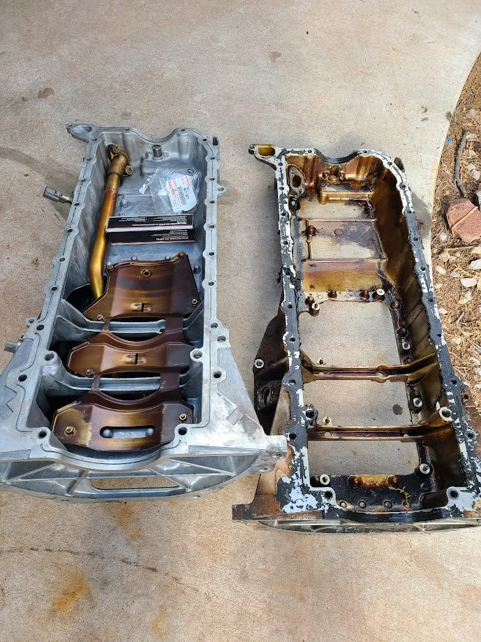

How about aluminum tape over the crack, then JB Weld over the aluminum tape?
The alum tape may lose its bond as the oil seeps into the adhesive after the engine is running, and the oil is warmed up. At least that's what I think might happen. This is after the second day when all the oil stopped coming out of the crack, and the surface is dry and clean enough for the alum tape to stick.
You had a huge hole to repair in the field. No way to fix it out there. Your plan worked. Limp out and hope for the best. The field repairs I spoke about were small and not at the bottom of the component.

When I clean everything up, I'll take a picture of the long crack. It was a doozy 😁.
We once “repaired” an oil filter with Water Weld and duct tape… Water Weld sets up in less than an hour and the tape kept it in place while it was setting up.

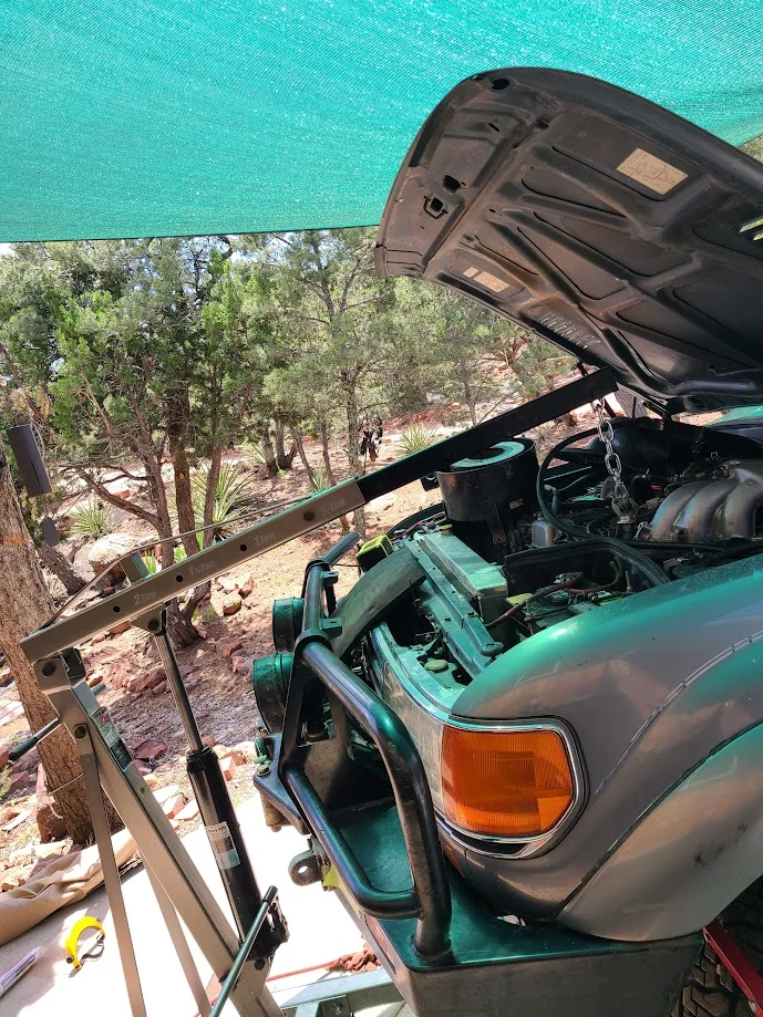

Alright, this project is done and Beastie is back on the road. Removing that upper oil pan took roughly about eight hours over a course of a week. I procured another one from another mudder from TX and moved everything over. The bump stops will be going on this weekend, then I'll hit the road for nowheresville.
