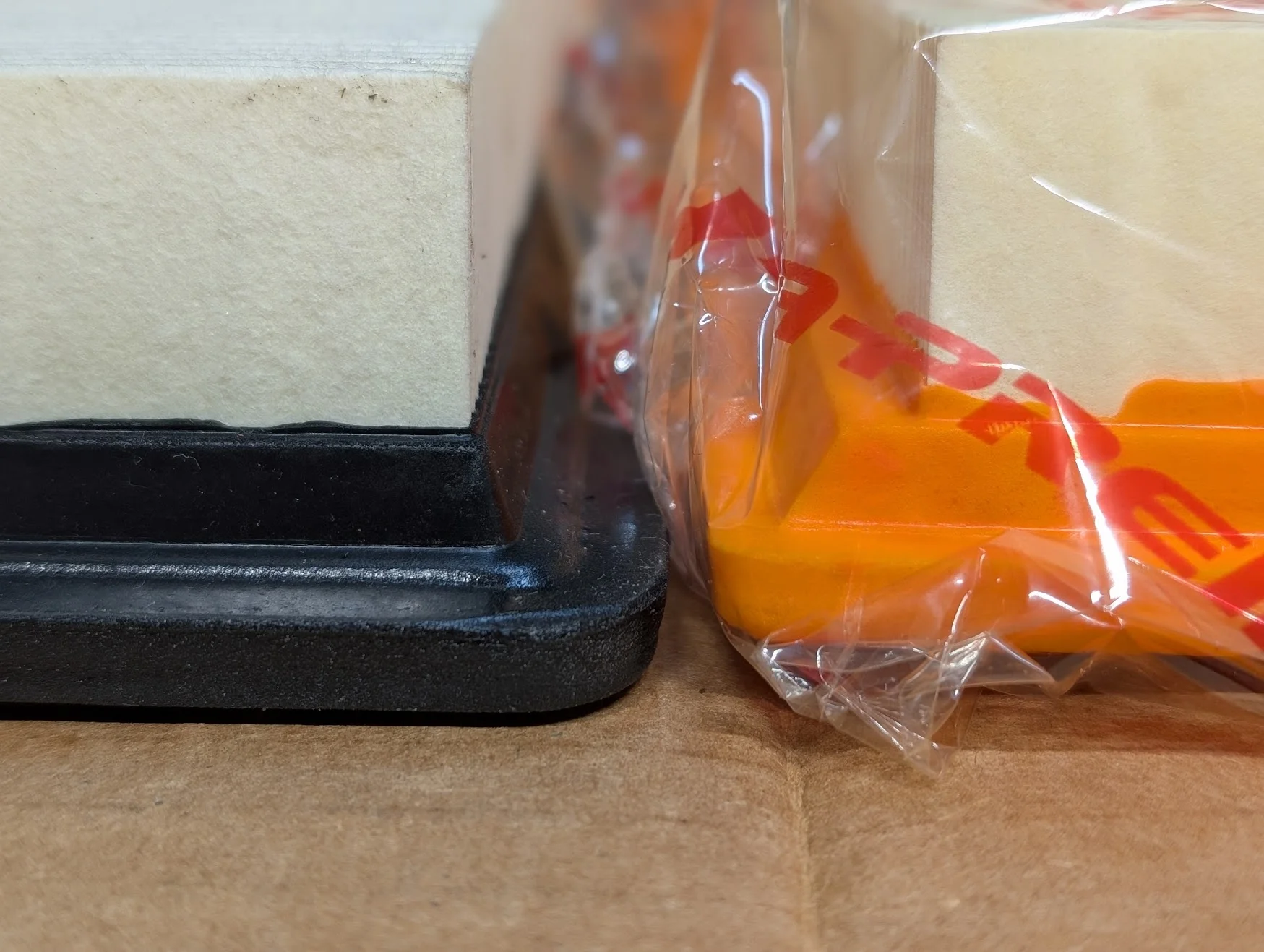

I did pick up these air filters from Amazon, pictured on the right, and they look to be a good fit.

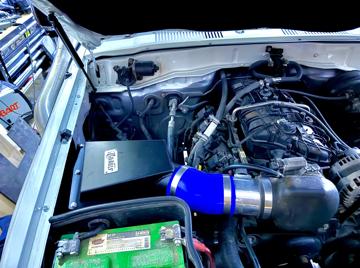

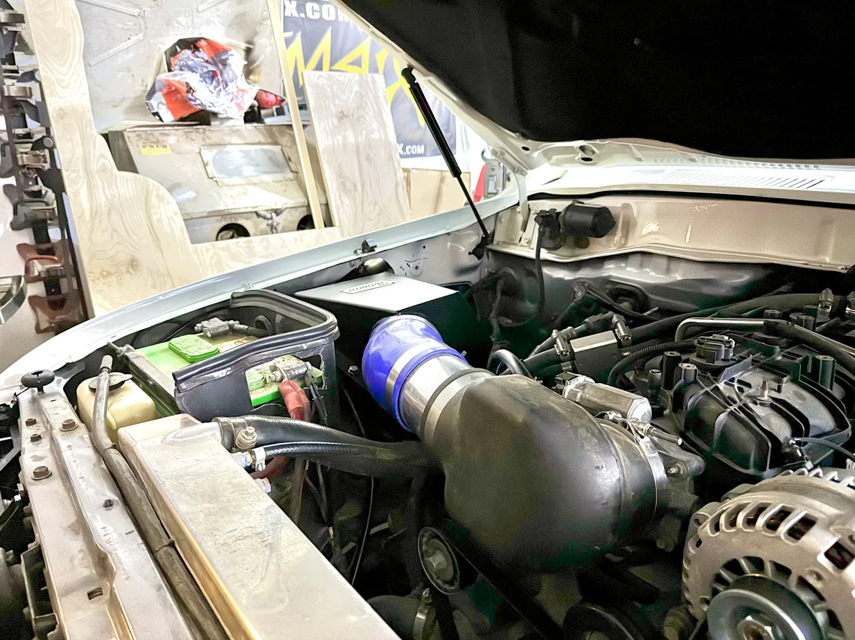

I ended up mounting my airbox “incorrectly” using some different holes in the fender. It’s tilted towards the fender, raising the outlet to clear my lower radiator hose. Seems to work well with only two bolts, though I’ll make a bracket to support the “floating” side later.
-Rob
