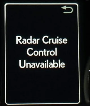

I recently upgraded to the heritage grill, and now my radar cruise control is acting up.
Cruising along at 40 mph
Click the cruise control on/off button (end of stalk)
Engage cruise
On the dash, the cruise control screen displays, then flashes to the error.
From this:
To:
Nothing is blocking the Toyota emblem.
Tried disconnecting and reconnecting the radar module.
Tried adjusting the screw on the top of the radar module. The placement of the unit should not have changed overall, but should it be level or aligned with something in the vehicle?

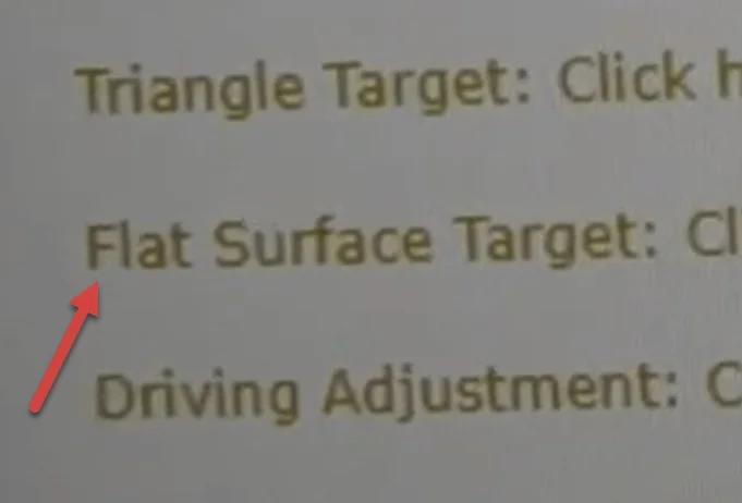

If you have TechStream, you can do some magic:
Another video by the same guy:
If you watch the video, you'll notice that using the triangle thing is not required, and there is an option for a flat surface.
