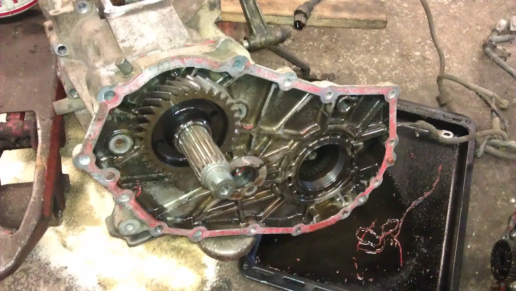

Yesterday i removed the gearbox and a friend are going to help me fix it...
I did not know you had to remove the transfer box to access the gear box and my friend hade problems with this gear.
Do we need a special puller to remove it?
Is there any good rebuilt guide online for this gearbox?
Just normal pullers,if there is a thread inside those 2 holes you could use them.Otherwise,the type of puller that can get behind the gear will do,preferably one with 3 arms.

Now I have tried to refurbish the gearbox, I think the main problem was that the fork to 3-4 became worn out when I ran with low oil volume.
But I changed the bearings, seals, syncro rings and bought a stronger fifth gear kit from Roodogs.
Now when I built up the gearbox must be due to an error, fourth gear jumps out when I put it in sometimes.
Now I do not know if I should give up or what to do:bang:
