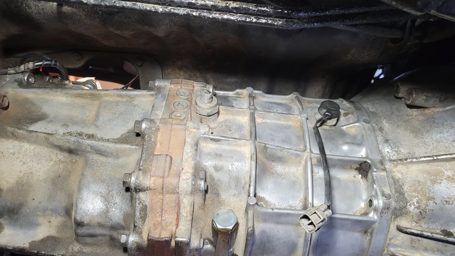

Hi,
Manual swapping my 94 surf with an r151 from another surf. Anyone know what the sensor is beside the reverss light sensor? Haven't see this before. On the front right of the trans.
Cheers

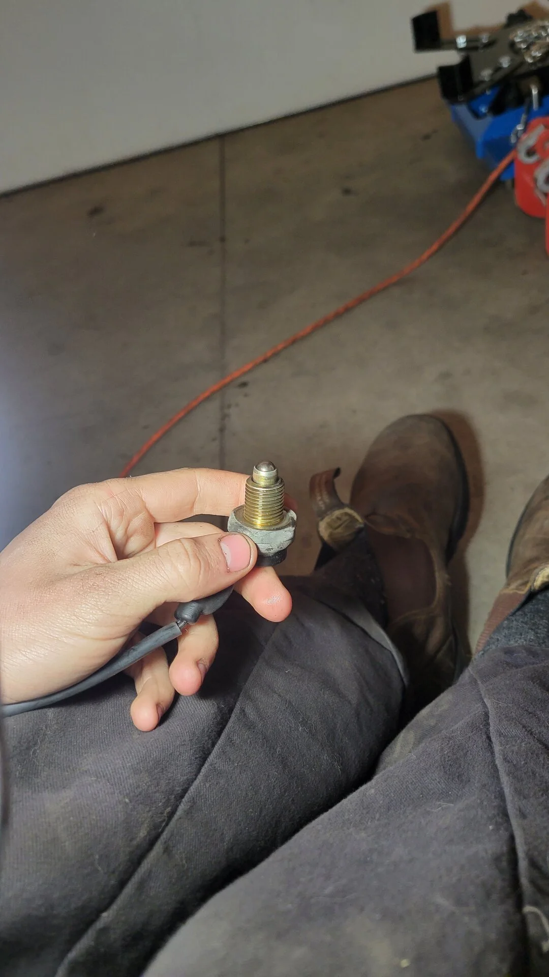

Very odd. I haven't seen that on any of the R transmissions I've had, and it doesn't appear in any of the manuals I have either. Looks almost like the switches on my split transfer case. What does it look like on the back side when you remove it?

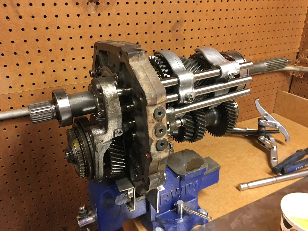

Not sure what that switch would engage with on the inside of the transmission, possibly the 1st/2nd or 3rd/4th shift rods? Here is what that side looks like inside:
Yeah it's strange, looks like a push switch position sensor same as the reverse sensor behind it, no idea why the car would need to know what gear it's in other than reverse though. Once I get the shifter arms in I'll check when it's positive and report back
