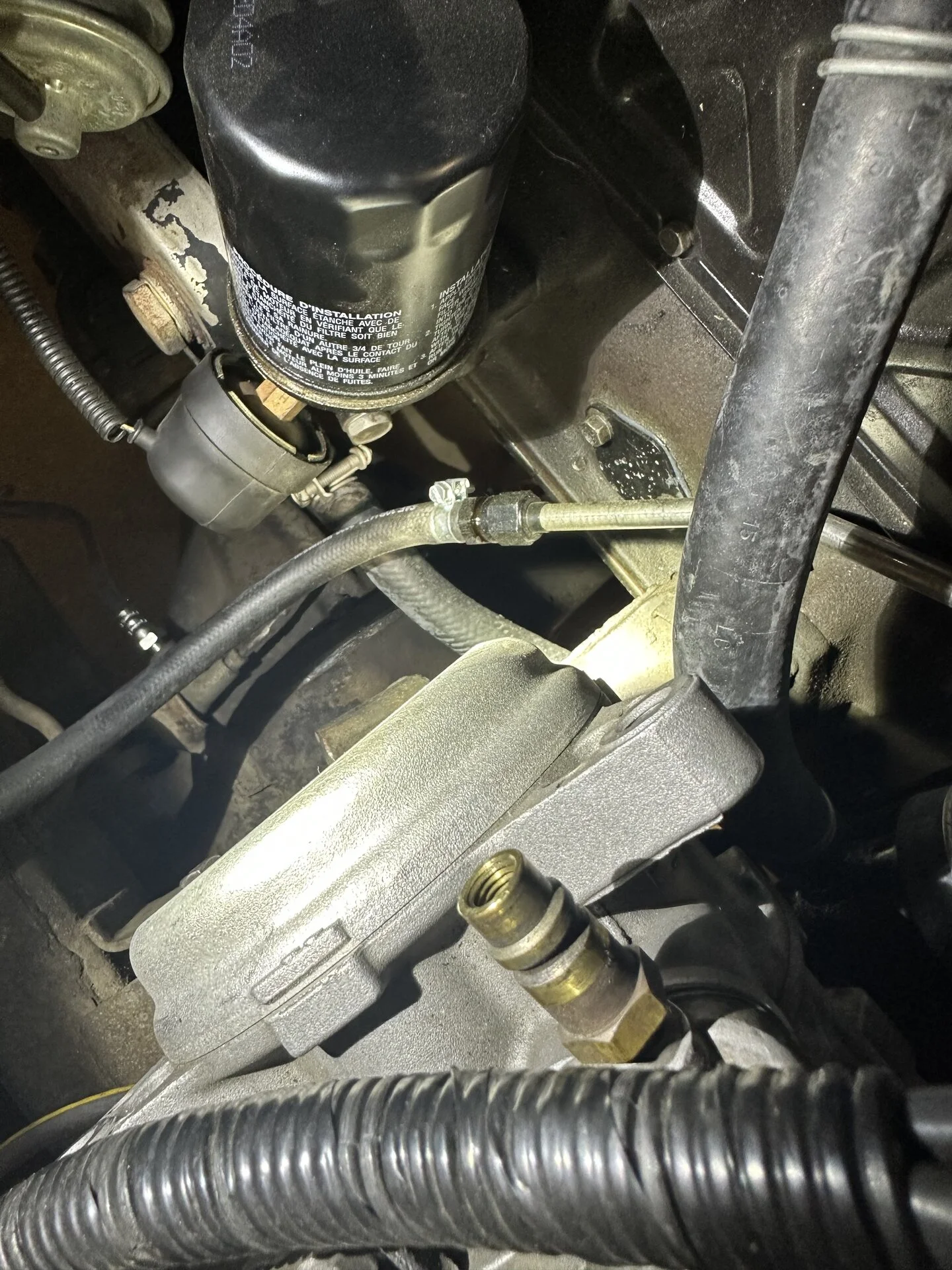

This is a 1985 FJ60. This is a picture of the current AC setup. Can anyone tell me if this is R12 or R134?

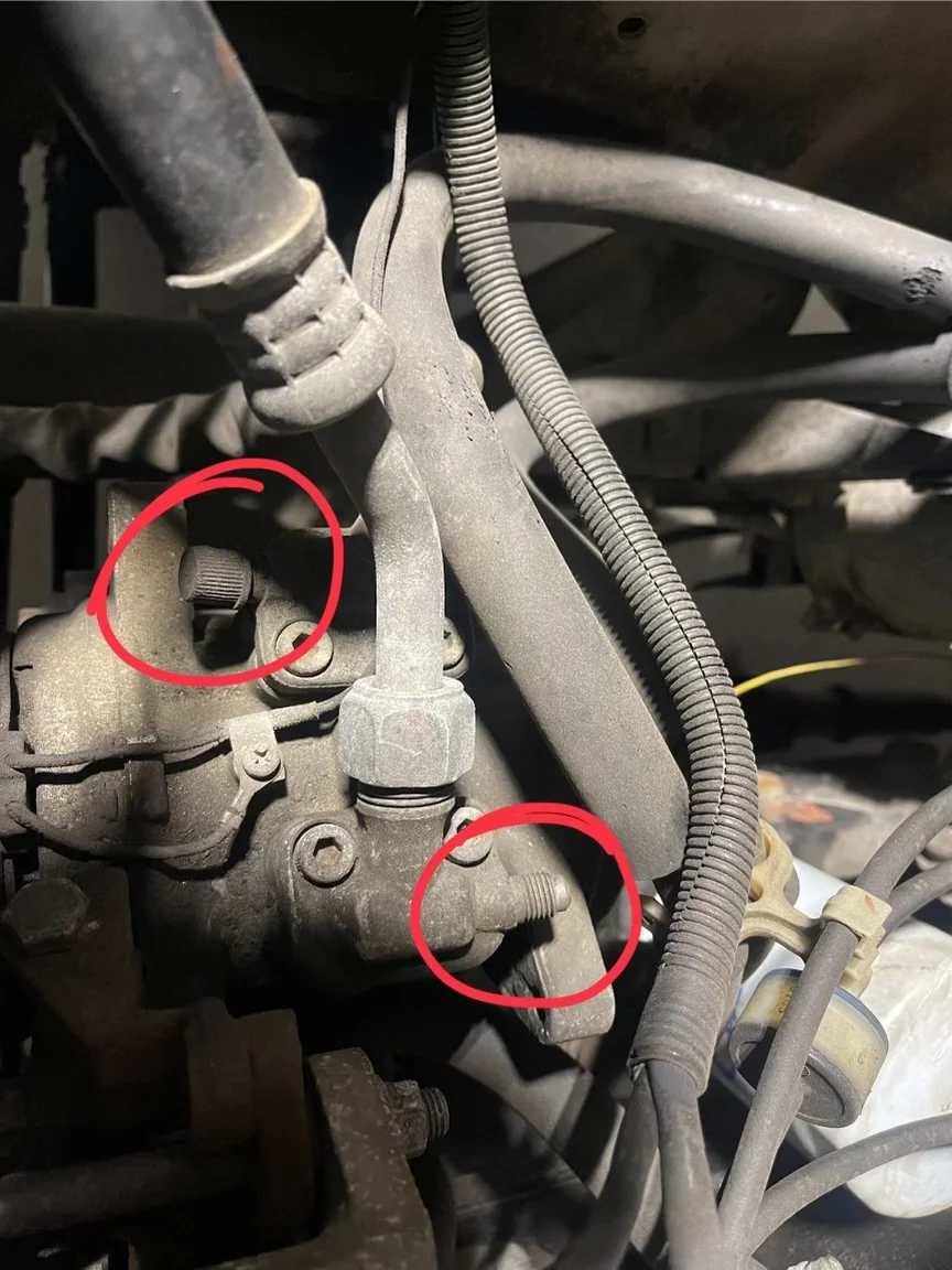

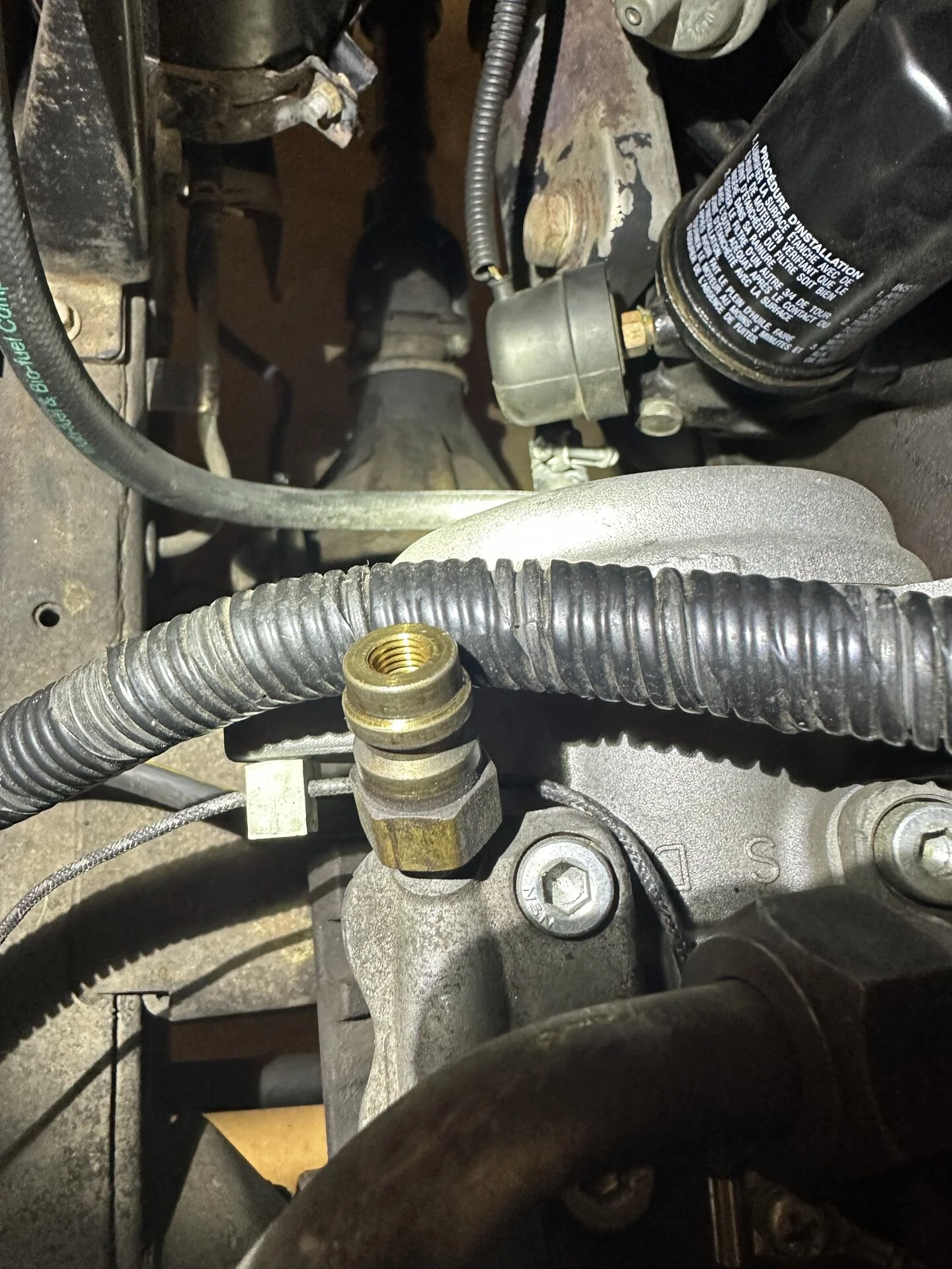

Curious if from these ports if someone can tell if it’s still the R12 or if it has been changed to the R134.
Follow up question would be, if these are R12 ports, how much is it and how hard it is to convert?
There is an original sticker on the radiator support that says R12. But that’s just been there since new.
kinda hard to tell from just the ports what refrigerant is in there. If it was converted by toyota, they would have put a cover on the top of your sight glass on the drier. To keep R12 in it, its not that hard to find the R12... its hard to find someone with R12 equipment to use unless you DIY. If you convert it to R134 youll need new o rings at all your connections as well as new oil. R134 uses PAG46. youll also need a new drier that is for R134
those appear to be r12. the r134 ports are bigger; try connecting a 134 recharge can to it to test the theory, I bet they are too big. I retrofitted mine to r134 years ago and it still blows super cold air.
And everything that dbbowen said about the orings, oil, and drier. :)

Those are R12 ports. If converting to R134 a adapter fitting will screw onto the R12 fitting.
