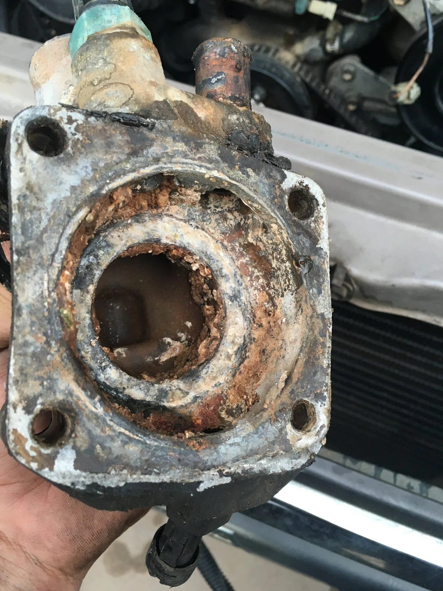

I reckon I found the problem...
Interestingly no O-ring in the Tstat housing and the gasket was in pieces...
On top of that there's a lot of solid crud (corrosion products?) in/on everything... I'm worried it's in every water jacket etc. Anything I can do to dissolve it and flush it out without taking things apart and hot tanking? I don't want to head down that road. In other news the trans supply (I'm guessing) hose was so brittle it broke in two places and the upper rad hose internal spring was mostly gone save a few rusty coil pieces.
That much corrosion suggests that it was run for a LONG time with an imrpoper mis of water and antifreeze. If it looks like that on the thermostat, you likely have heater cores and internal lines that match. A swish with a 50/50 mix of CLR and water might help, but it also might dislodge stuff that will then collect in your newly rebuilt radiator, resulting in more Overheating.
On that note, your tank looks to be metal, so I'd imagine that Hals can rebuild it with a rod-out and repaint to get it back up and running. They pressure test everything, so if they say it can be rebuilt, they can make it good. My first inclination would be a new OEM, but since NLA, your options are limited.
