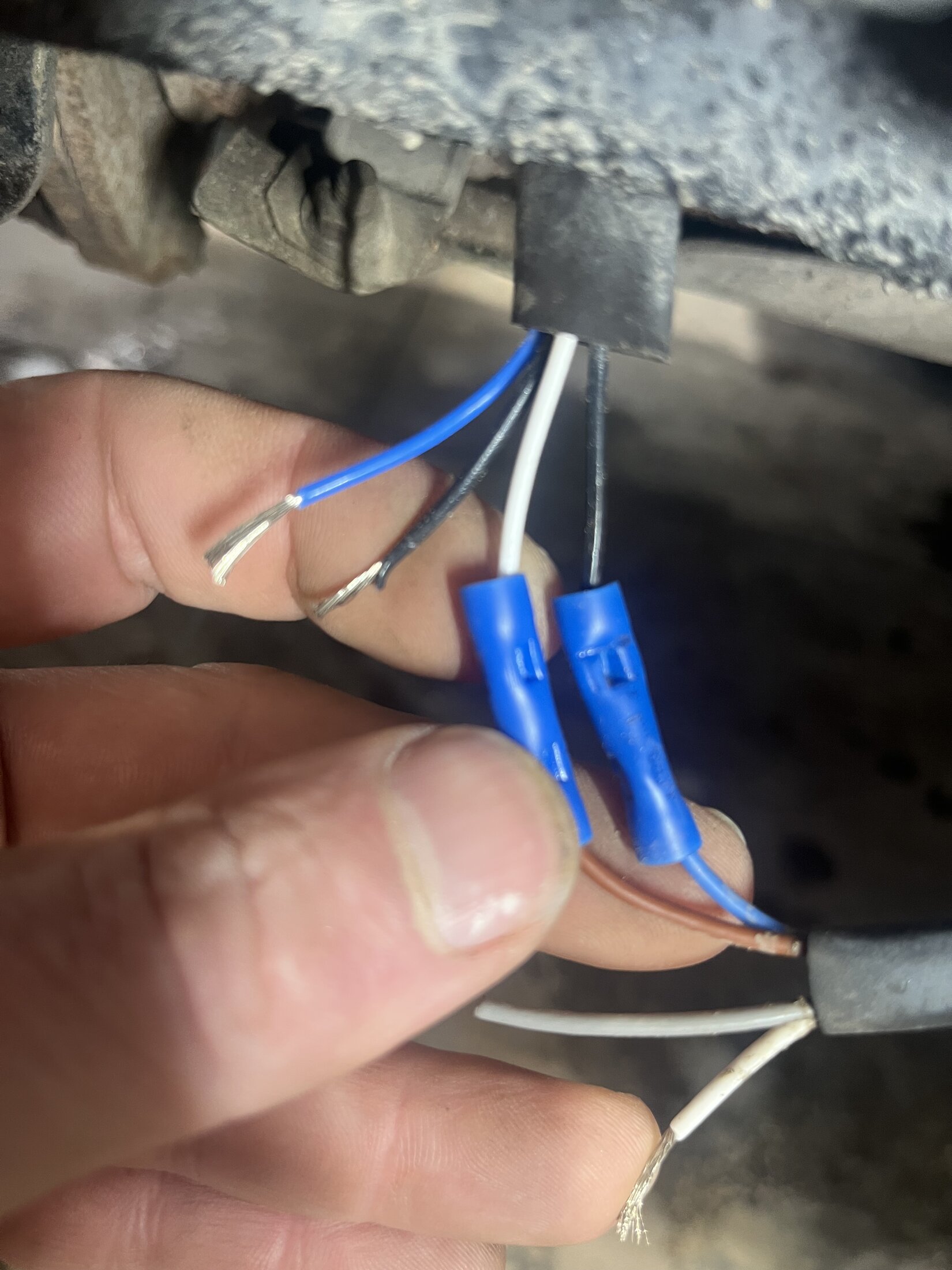

1994 02 sensor.
Anybody know
Not certain what you need, I have a new Toyota sensor sitting in front of me. Unfortunately the car is elsewhere. It looks like the sensor is on th right in your photo.
Replacement pins and connectors are available.
90980-11178 female
90980-11177 male side
Corsa Technic or Ballenger Motorsports can supply the terminal pins. The Corsa part is: 090IIU-PIN2

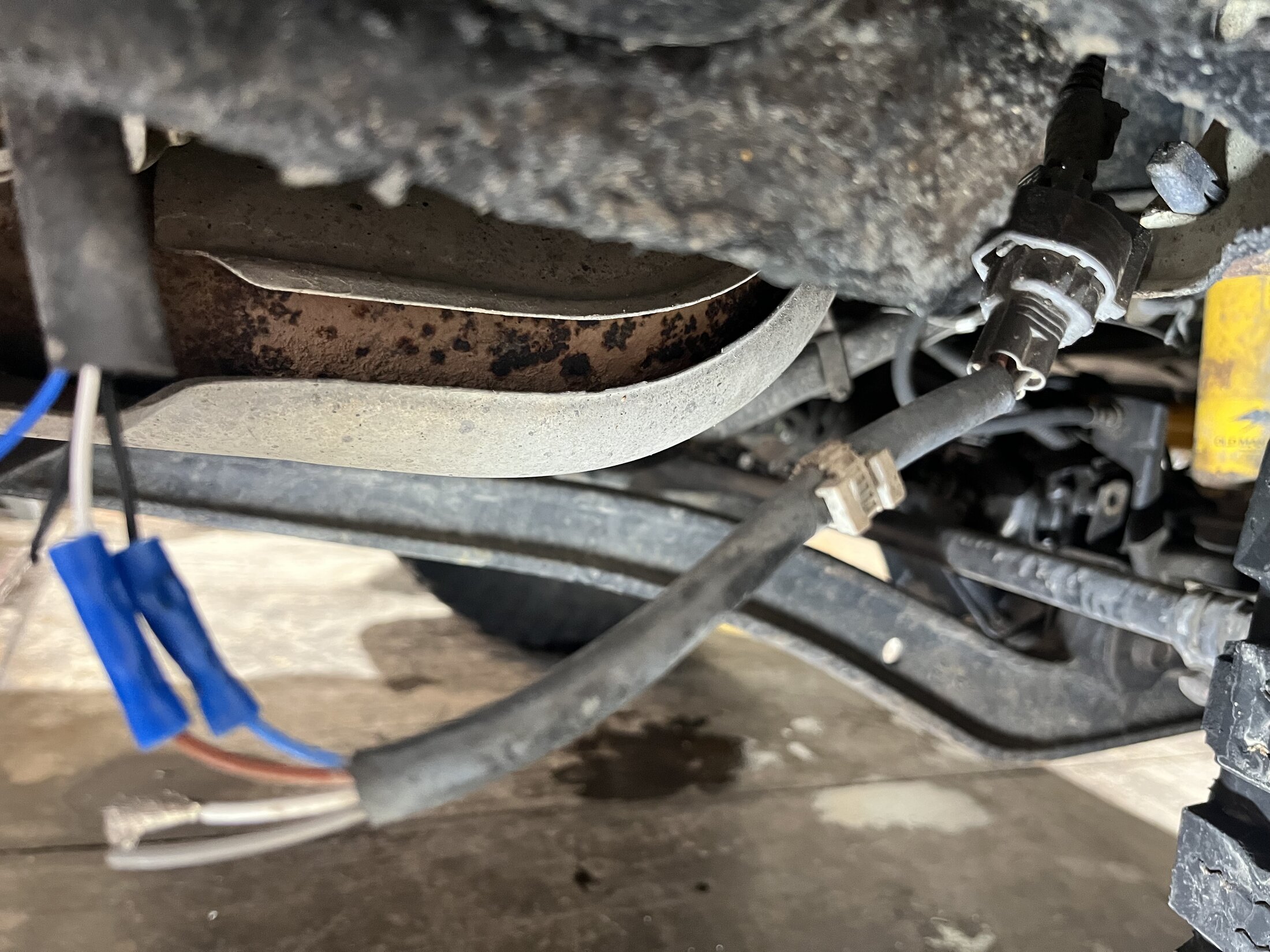

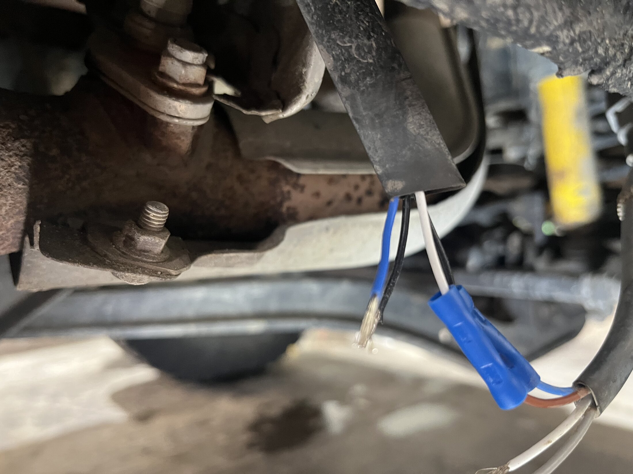

I was just going to splice the bosche sensor into the existing original o2 sensor plug and harness. I don’t have the part number.
I bought the sensor 8 years ago and am finally getting to it.
To be honest, I tried one last December and while the short term fuel trims seemed to be doing their thing, the CEL came on and my gas mileage was between 10-12.5 in mixed driving. I o not know what was wrong guessing the polarity on the heater wires was backwards.
I found this 89465-69115 for $89 in Japan. The pigtail is correct for both sides. Put it in and all is well. Gas mileage showed 14.63 over 120 miles of mixed (50% hwy) driving.
