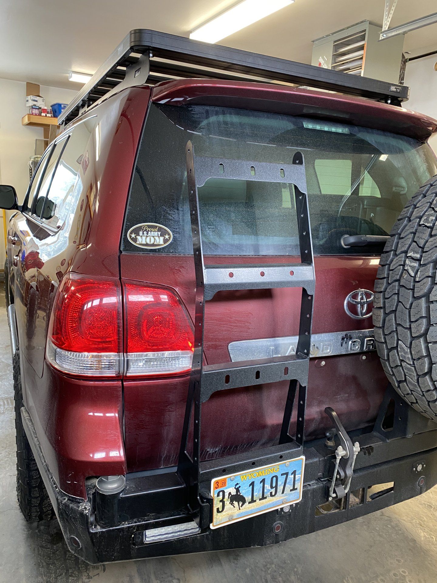

3. Without a "gobi" rear ladder, how do you get up there? Bring a small ladder :)? At home, setting things up, I use a small step stool; in the field I can reach everything standing in the doorways.

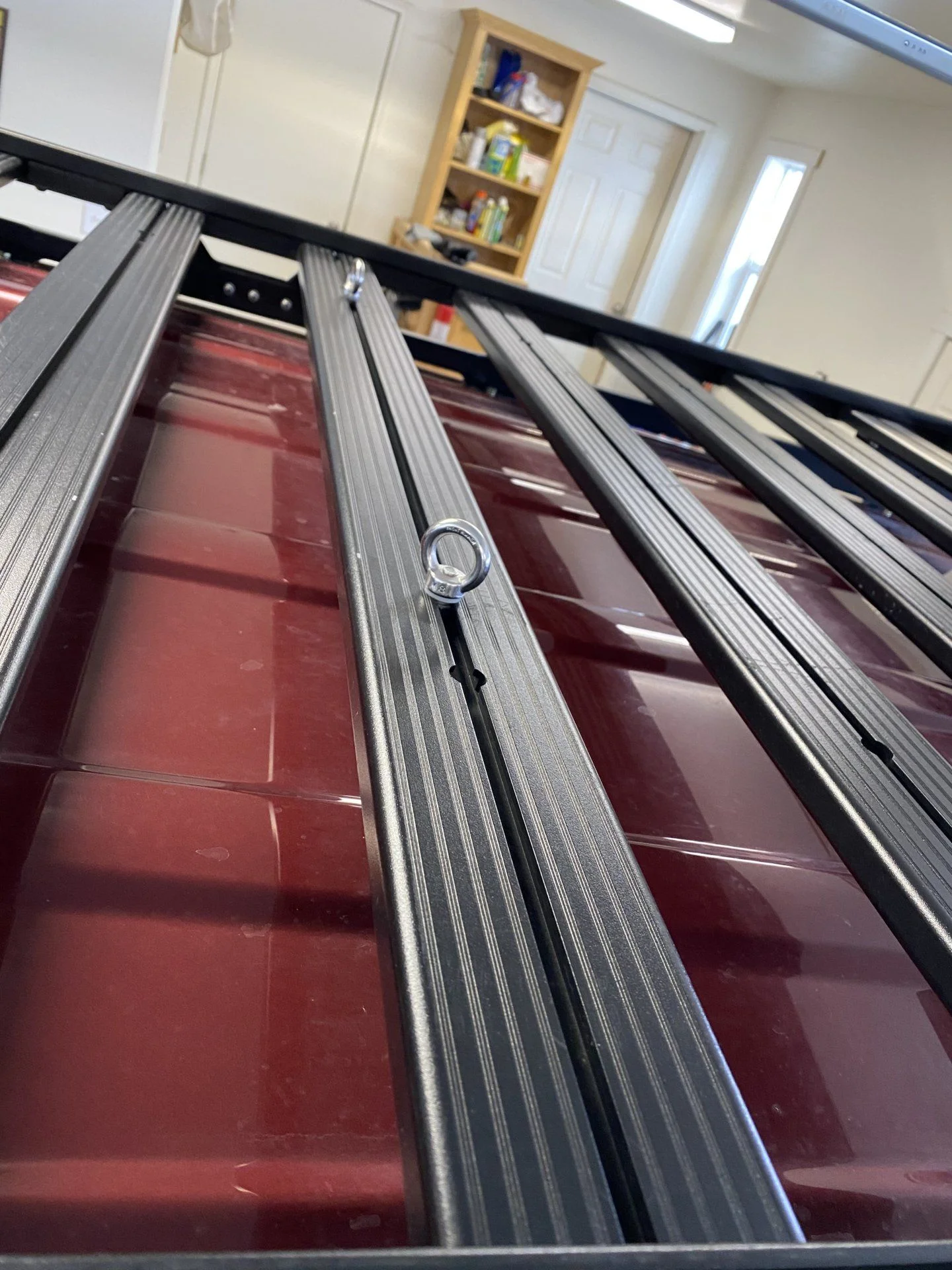

8. I didn't seen any tie downs/notches on the slats..how do you go about actually securing cargo up there? There are slots on top and bottom of each slat, as well as all around the frame. Things are attached with either an M8 bolt or nut put into the slat or side rail.

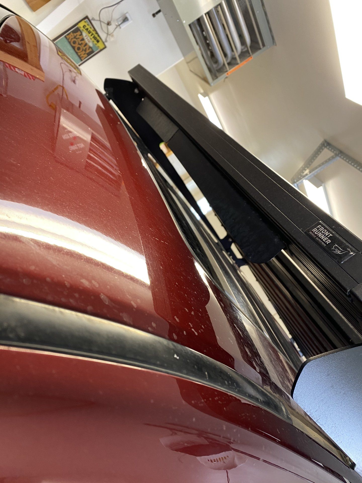

No drilling is required, but it actually uses the 4 stock attachment points. Before you undertake this, look for the thread on here about how to safely remove the stock mounting bolts as it is easy, but tricky if you don’t know how ahead of time.

For access, I just carry an aluminum telescope ladder or a lightweight folding step stool. I actually find that I rarely need to actually get on top of the rack.
As far as attaching things, Rigger shows the standard tie downs from Frontrunner, which I also use. I actually have them mounted on the underside of the rack to keep the rack clear on top. In addition, the tracks are standard metric bolts (the size escapes me at the moment), so it is pretty easy to fashion your own solutions for things. I do recommend the eye bolts from FR though.

I like the way you can drop/slide a bolt into the track then tighten a nut on it to anchor something.

FR sells a telescoping, portable aluminum ladder, and they also have brackets that mount to the side rail that keep it from sliding when you’re climbing.

You can install it yourself no problem. You just build the rack on the truck rather than on the ground. Get the rails mounted, then mount the slats that attach. Then the sidebars. Add then missing slats. Add the front and rear pieces. Don't tighten the hardware until the rack is complete and square.
Highly recommend FrontRunner rack and accessories. Can be done by one, but recommend two people. Be EXTRA careful removing factory rack/rails. One of my factory "nuts" fell as i was removing last bolt. That is a serious PITA to drop headliner and find it. Use your silicon to seal but not so much to lose contact with the roof. You will lose grounding contact which is essential for any lights you add to the rack.
I purchased the larger wind fairing and it makes a difference. Again, great rack, great accessories for anything you will carry. Note that you may want to test the grooves/channels on each slat prior to mounting. I am talking about the channels that run the length of the slats. I ran into metal "spurs" in some that i had to knock down before the bolt head would slide.
