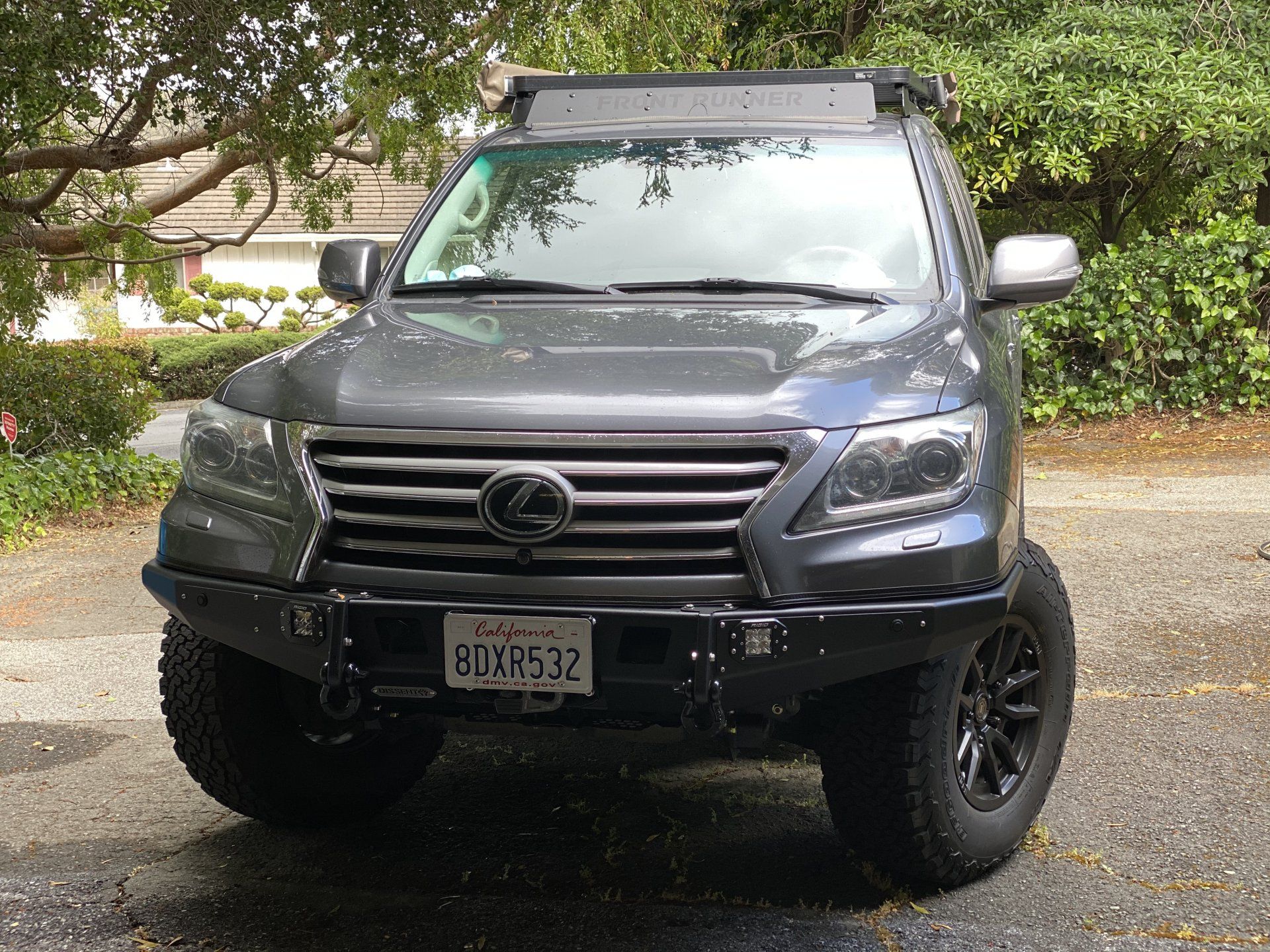

Bumping this to see if anyone can provide input. For those who have a Front Runner rack on their 200 could you measure the outside edge to outside edge width? It shows it's a 1255mm width rack and the recommended wind fairing for it is only 1091mm wide which would leave about a 3.5" gap on each side of the fairing. However, on this video Eric did for Ed Martin the fairing looks like it almost goes edge to edge. The fairing for the 1345mm/1425mm racks is 1267mm in width which may be what they put on this build. Just trying to get it ironed out before I put an order in

I’m camping and don’t have a tape measure handy, but the fairing is quite a bit narrower than the rack:
Now that I see Eric's video, it’s clear that he got one of the wider ones rather than the one that FR recommends. I think you could do either and I cant comment on using the wider one, but the one I have seems fine. It dramatically reduced wind noise and now is not much worse than stock.

Thank you! I was actually reading your build thread and noticed it looked narrow compared to the one I saw in Eric's video which then made me too curious to not ask
How is the wind noise with the updated fairing? Especially with the sunroof open. The original design was good at collecting bug guts, not so much at reducing noise.
Yeah, the previous version seemed to direct the airstream right into the sunroof. This fairing does a good job IMO. Definitely cuts down quite a bit. To be honest though, I don't really open the sunroof much at high speeds.
