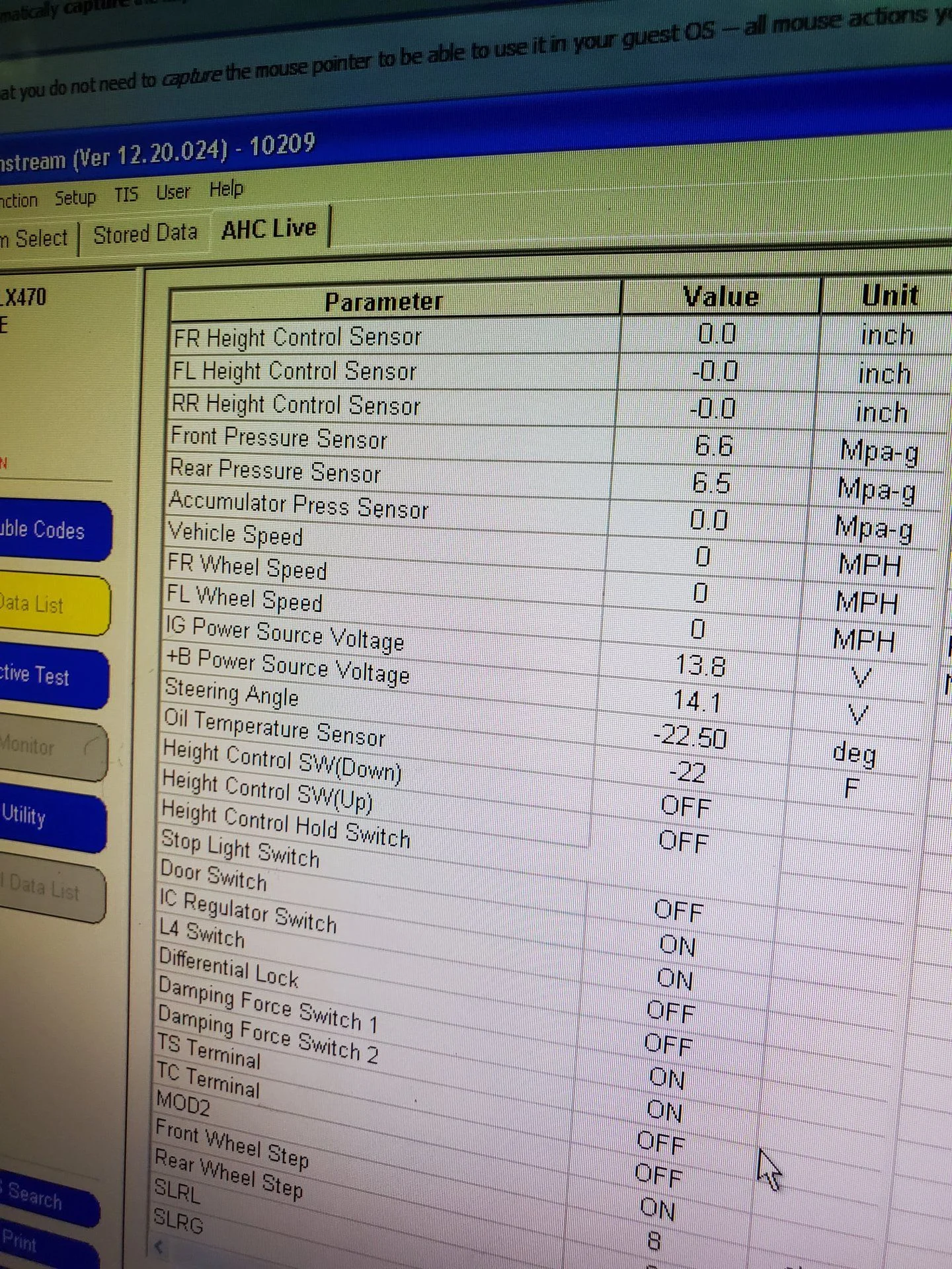

This is all about neutral pressures. If you can post your current state equipment, current neutral ride heights, planned future weight additions and current pressures, we can better assist.
Here are my pressures last time I adjusted. At that point I only had a front bumper. My driver side bar maybe had half inch to 3/4" of thread left to adjust after this adjustment.
Since this point I added the rear steel bumper and swingout
I'd like to eventually add a winch up front, a modest sensor lift so I don't have to mess with a diff drop, and extend the life of the system before having to buy new globes.
On the front things look great. You're before the middle of spec. I doubt you'll need to even reindex.
On the rear, I think we need updated info. That rear bumper situation will change a lot. If you haven't already, maybe remove the factory spare tire holder if it's no longer in use. That's good for some weight.
Do you have pressures of the rear after rear bumper and spring install?

Unfortunately I didn't get pressures after the bumper and before springs. I've started to just reindex the stock bars and get pressures tonight. I'll update with what I find d

Well, my old PC s*** the bed so I couldn't get pressures, and apparently I installed the driver and passenger side rear springs on the wrong side because the passenger side is 1" higher than the driver. I'll deal with that tomorrow.

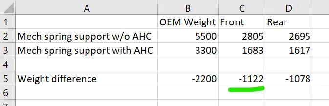

Here's my take. Numbered your q's so I can follow along.
1. Not sure what you mean here. I think the answer is no.
2. See the figures below. That's with AHC holding 40% of the weight. With my over-simplified math, it would make sense to switch to LC bars if you add about half of 1122 lbs. So call it 566 lbs. A steel bumper should be ~100 lbs and the winch, another 100. You've got 350lbs to go before the LC bars make more sense than the LX bars in my mind. If you could find an aftermarket LX torsion bar (similar to how King makes the beefy LX rear springs) that would be ideal. To my knowledge, no such product exists. I think this is because you can get away with cranking the torsion bars (adding preload) in most cases.
