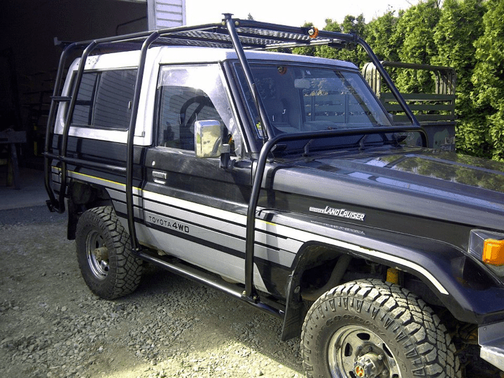

An exo cage seems like a decent option. I've seen some 74s with nice-looking cages that don't overwhelm the look of the truck. But I'm concerned that anything that bolts on won't have enough strength. Cost is also a concern. Does anyone have direct experience with building a cage for their 74? Would be curious to brainstorm on this.

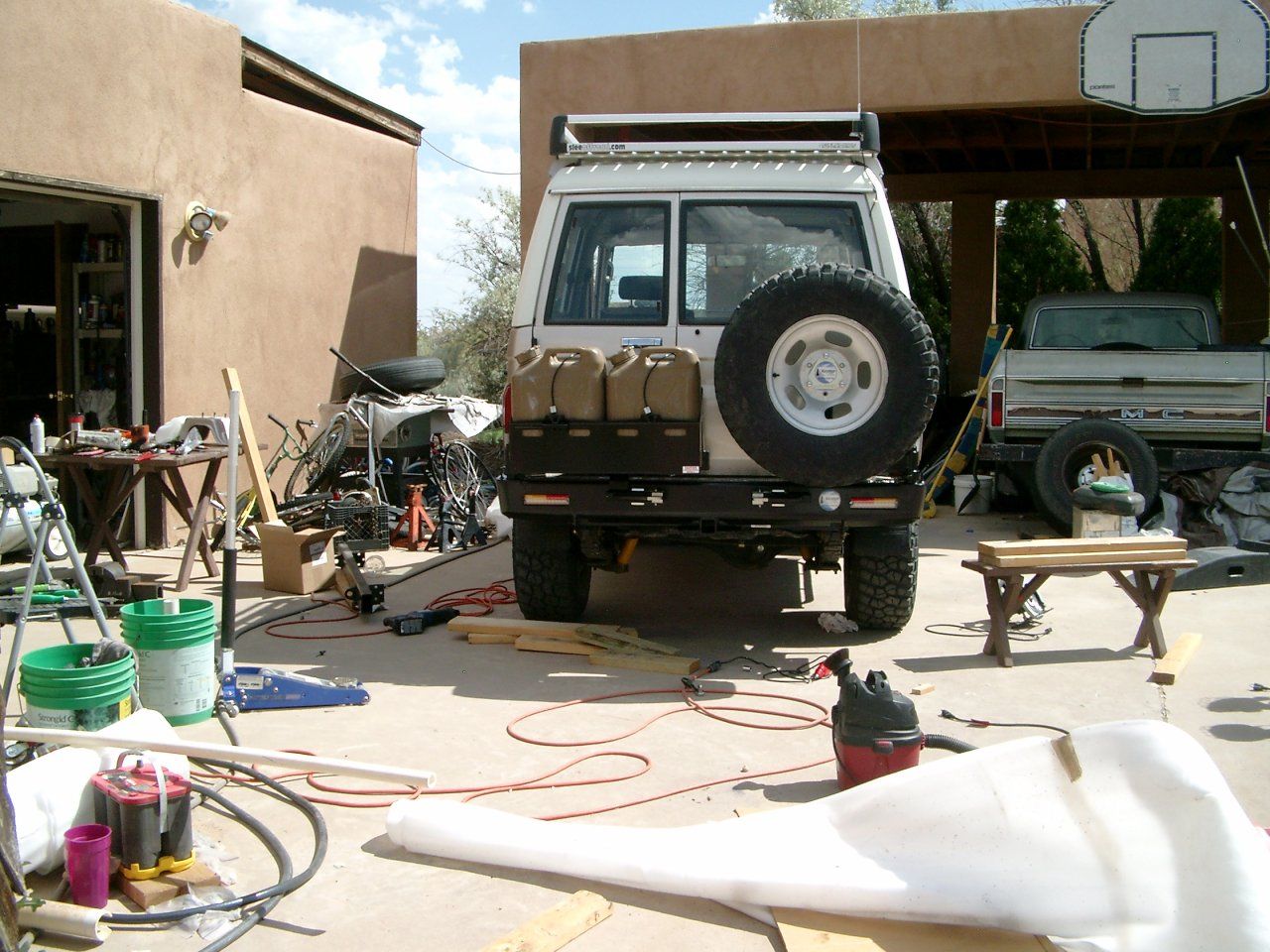

If I go that route, then I'd probably have to replace the rear bumper so that I can mount the jerry cans there. I suppose I could keep the original bumper and put it back on one day, so long as the new bumper can go on without any major modifications. Anyone know of a good bumper for these that could carry 3 fuel cans? I've seen a photo of somebody's 74 with the setup, but it looked custom (which is OK too, I just don't have my own shop and so won't be able to fab anything on my own, which makes my options limited).

I have a Kaymar bumper on mine. The rack is a JDM Aba Works attached to Thule artificial gutters bolted to the top (like a camper shell set up).

I like that bumper. Looks like a good solution.

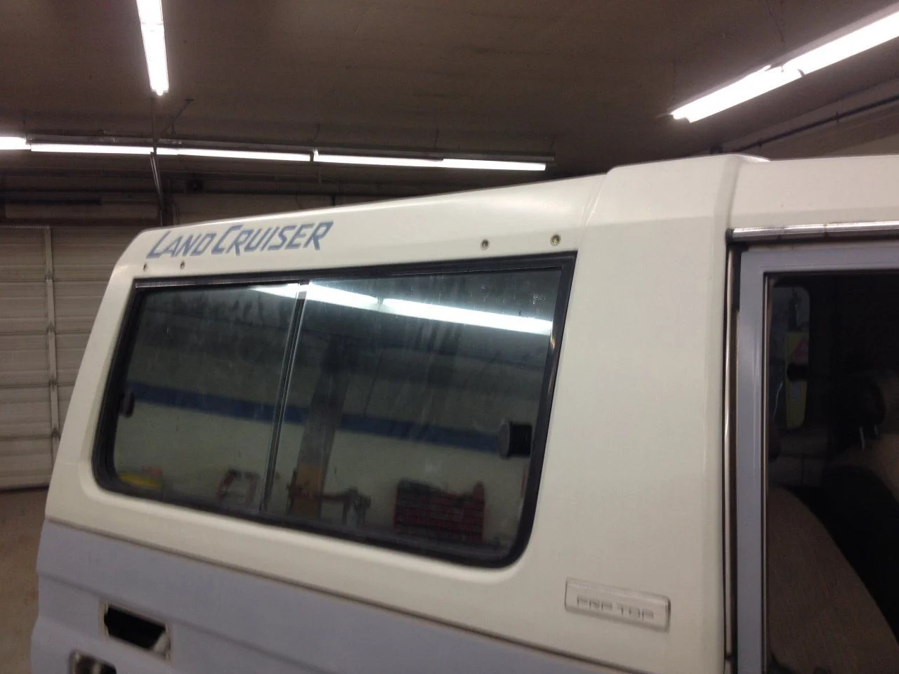

The rack has been up there about 15 months. I set steel 8mm Nutserts in the top to mount it. It is not through-bolted. The top is two layers so through-bolting collapses the layers togther and it can not be tightened up sufficiently.

I'm a fancy collector and I poked holes in mine.
Here is a not so good shot of the inserts.

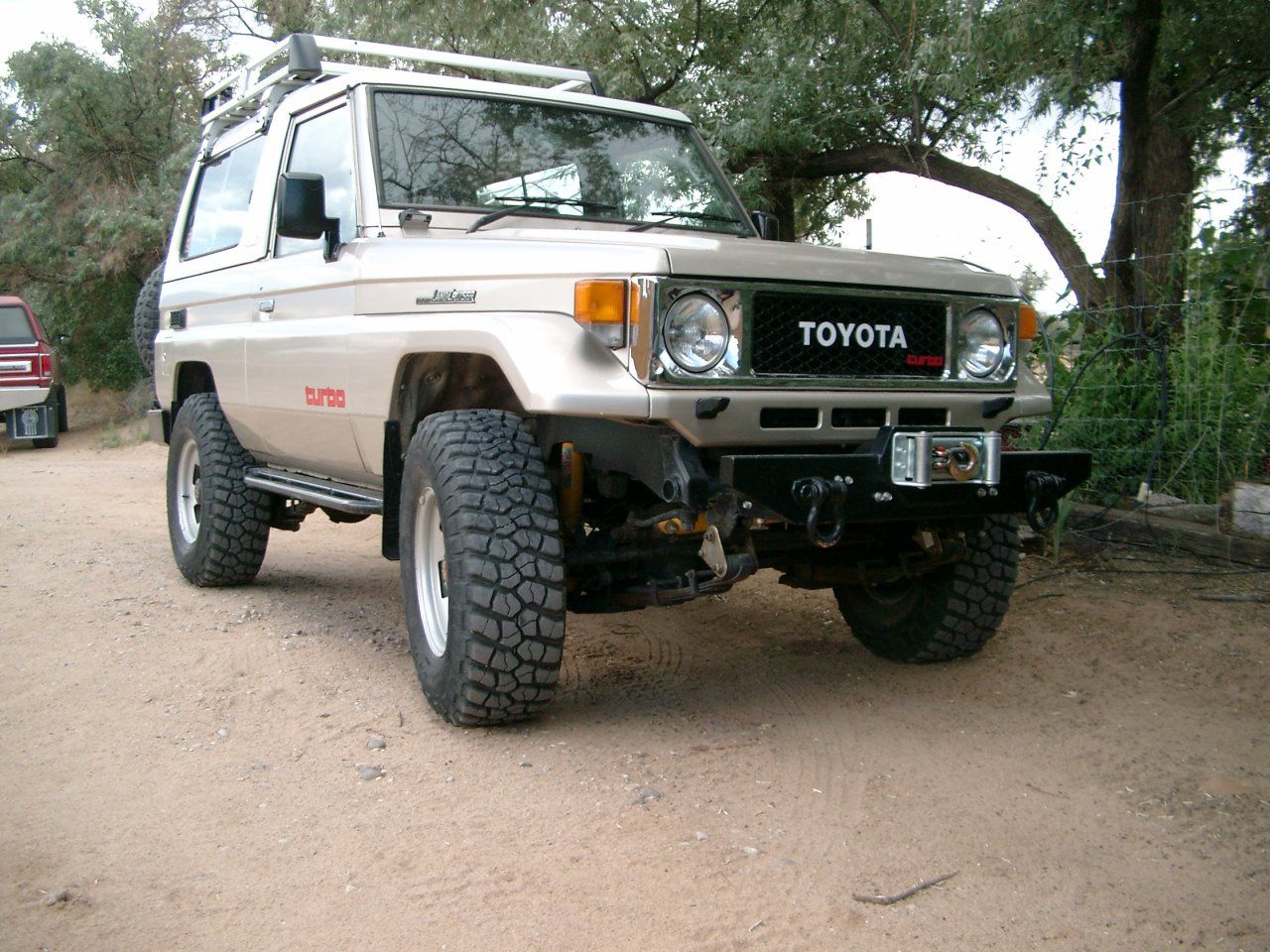

What wheels are those? I like the simple clean look of 'em.
FZJ80 stock 16x8 steel wheels with Spidertrax 1.5 inch spacers. The 80 wheel has 4.5 inches backspace and needs to be moved out.

@cruiserdan, where did you get your Kaymar bumper? Did you get it from an Australian supplier directly? Seems they don't have a US-based distributor anymore.
I got mine through Outback Proven which unfortunately is no longer around. I do not know if Kamar currently has a US distributor per-se.
Mine was intended to fit a 78 Series and I had to do a little "customizing" to get it to fit.

What size wheels/tyres are on this?

Jason Hugh (Cruisin Offroad) in Chilliwack, British Columbia is your guy for an exo and bumpers, too.
I have his sliders and belly pan on my 73 :)
Cruisin Off Road - About Us
