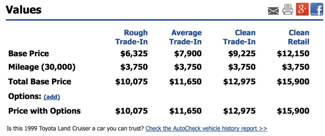

So that's between $12,975 and $15,900 around here according to NADA.
Taking clean retail at $15,900, that's at least $4,100 over priced (assuming $20k per above, but sounds like more).
