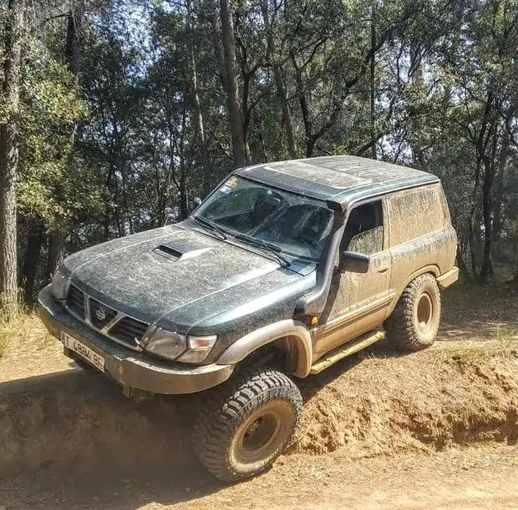

and above about the Nissan cummins it was a V8 for some reason and my research told me to avoid that motor it has issues.
