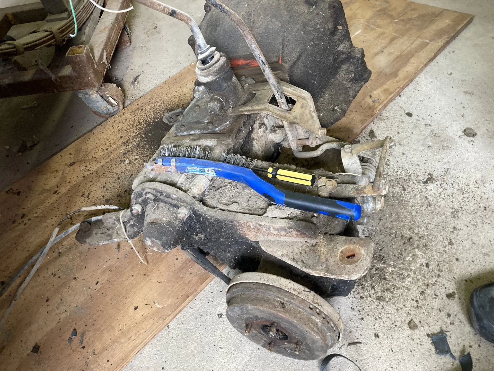

Just got back to MI yesterday with a 71 FJ40 I found in FL while down there. I’m gonna do a frame up on it…. I’m so excited! It has a 350 in it with original 3-spd. I’m looking to see if anyone has a 4-spd? I’d like to put a 4-spd in it. Also, do I need a different bellhousing for the 4-spd vs. 3-spd w/ the 350. Plus, I’m assuming I’d need the 4-spd TC too?

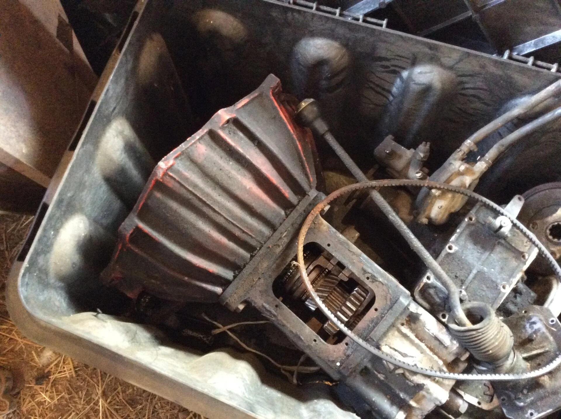

Thx for the info. It’s good to know. I came across two 4-spds and gonna pop the tops on both to see what kinda shape they’re in. Seems I do need a different bellhousing which I’ll order shortly. Just got the 350 rebuilt and almost have the frame ready for powder coat. Lots of fun!

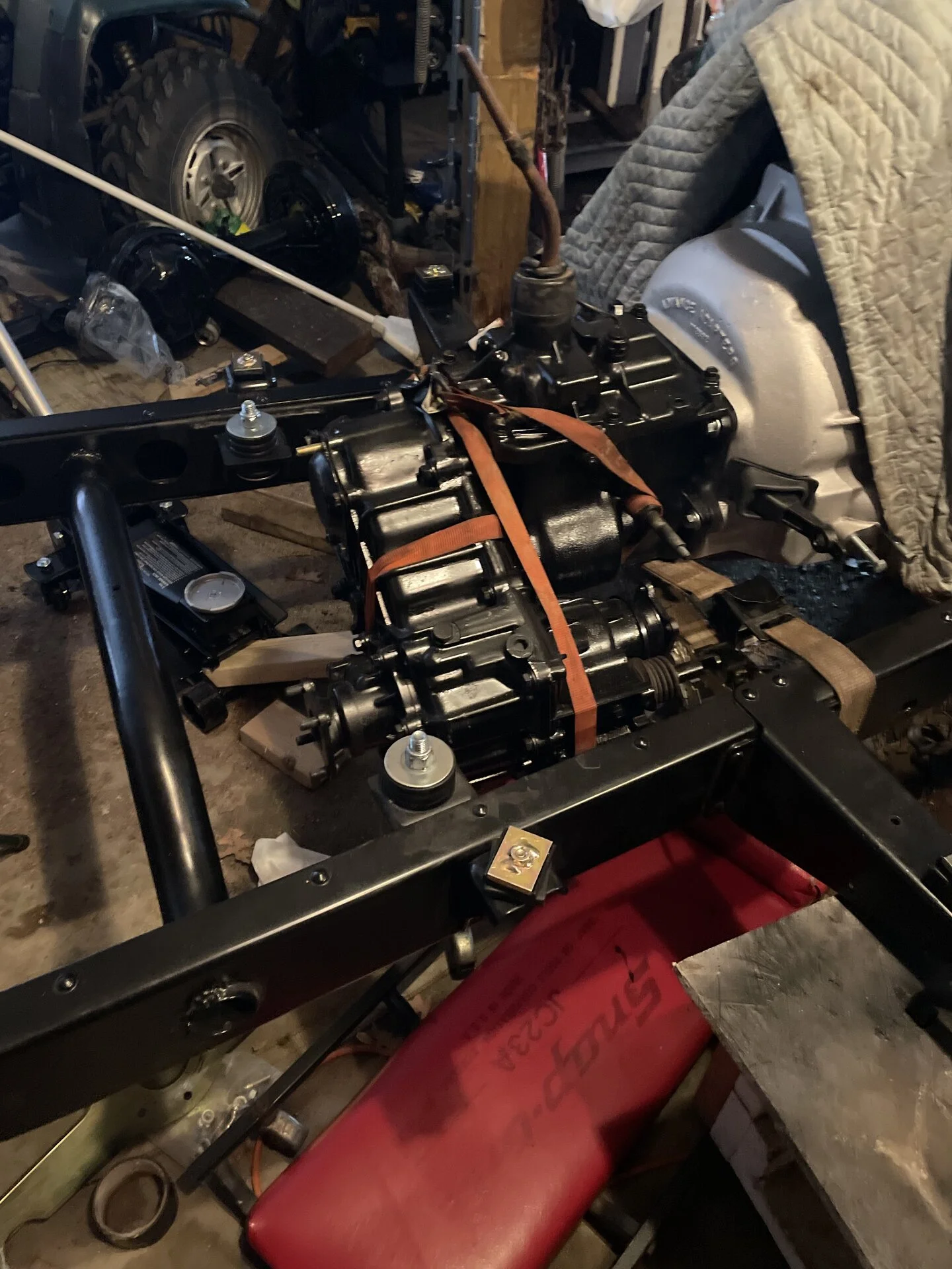

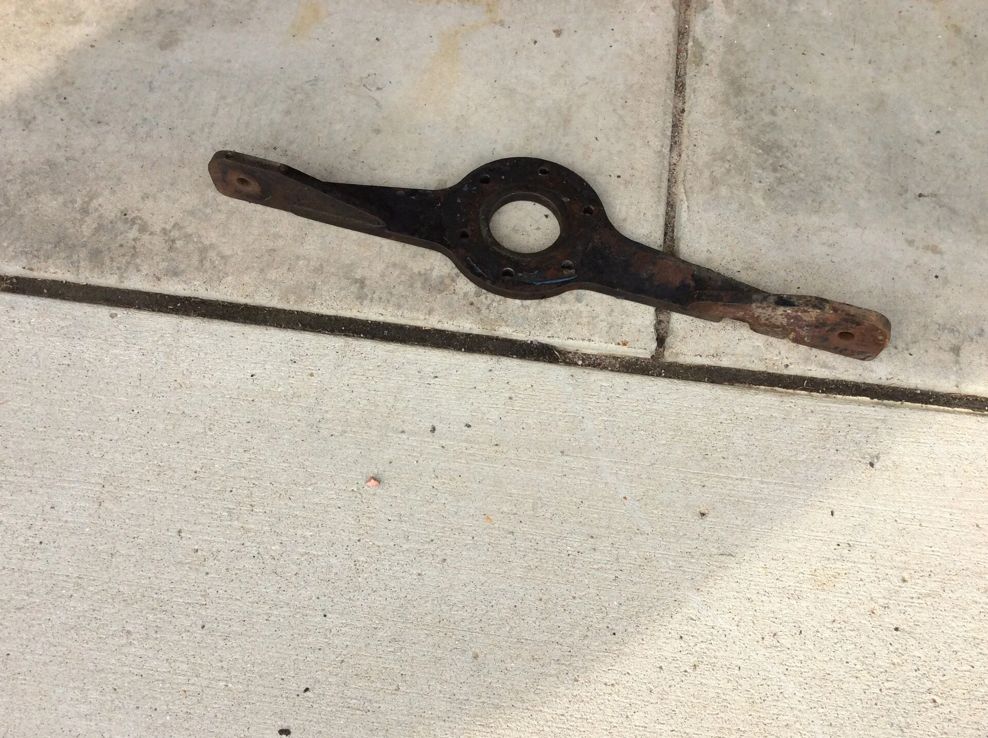

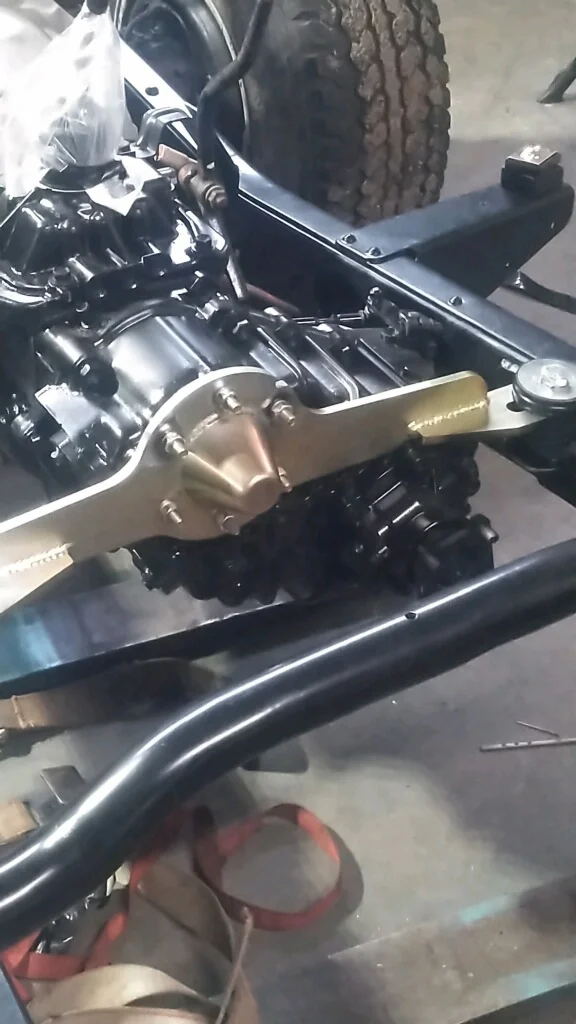

Thnx for the info. Though dropping in 5-spd is tempting, I’m leaning toward the 4-spd since I have 2 now. Here’s a pic of the propeller crossmember and 3-spd bellhousing. I know I need a 4-spd bell-housing but do I need different propeller crossmember too? Thanks.
I'm pretty sure the propeller member fits both tcases. You can check it out if your 4 speeds came with the tcase.
AA will sell their parts individually. You can put an ad in the classified section for a bellhousing. You can make gussets out of angle iron w/a little welding for the frame. @Downey is on this site and he sometimes has one of his kits available. He also offers installation instructions which would be helpful to locate the driveline in the frame. I would still keep an eye out for a nv4500. Doing a "frame up" will be expensive. I wouldn't powder the frame until all the mods to it are done. Personally, prefer paint. You might as well make it a driver. 4 wheel disc brakes, power steering, & a 5 speed is nice.
The propeller bracket is the same for 3&4 speed early cases.

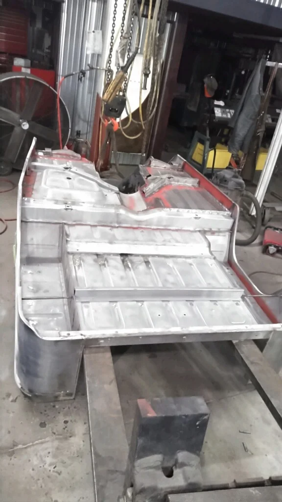

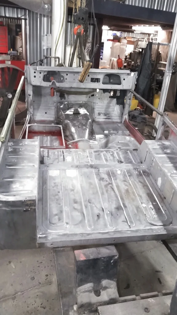

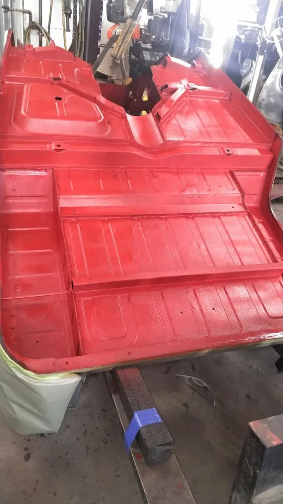

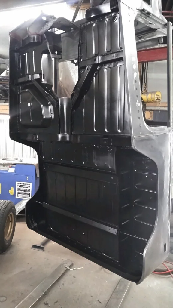

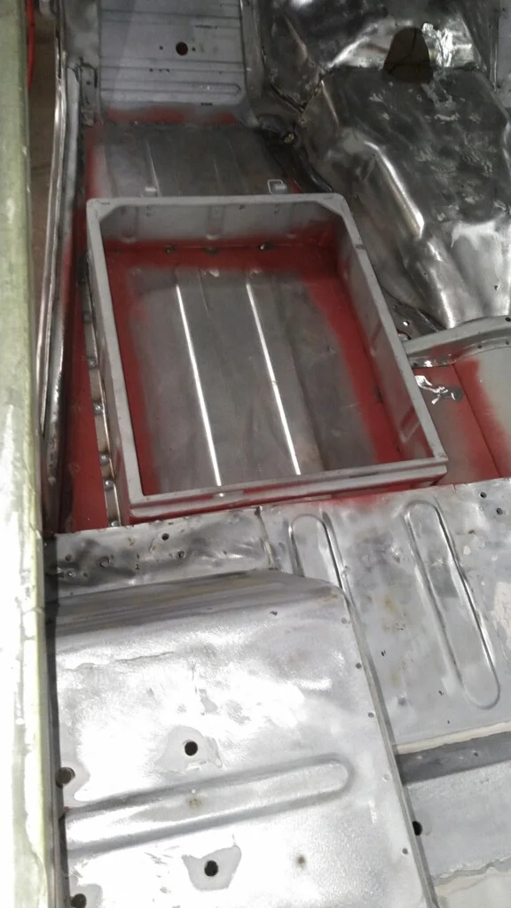

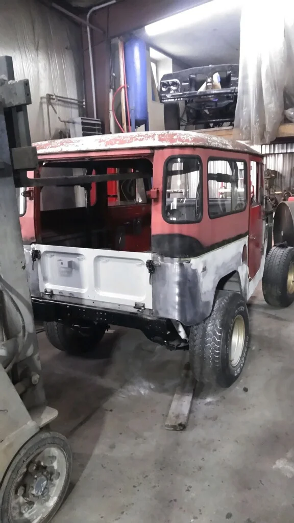

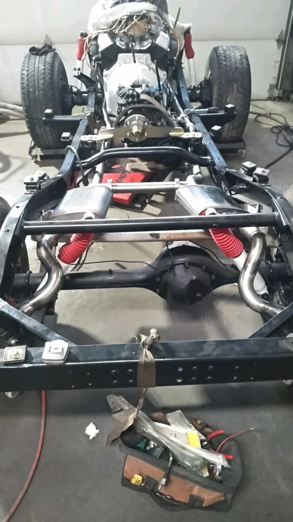

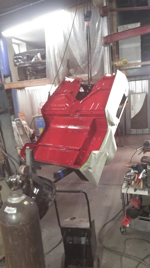

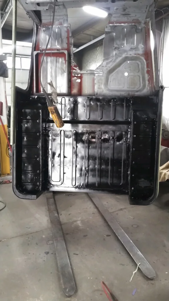

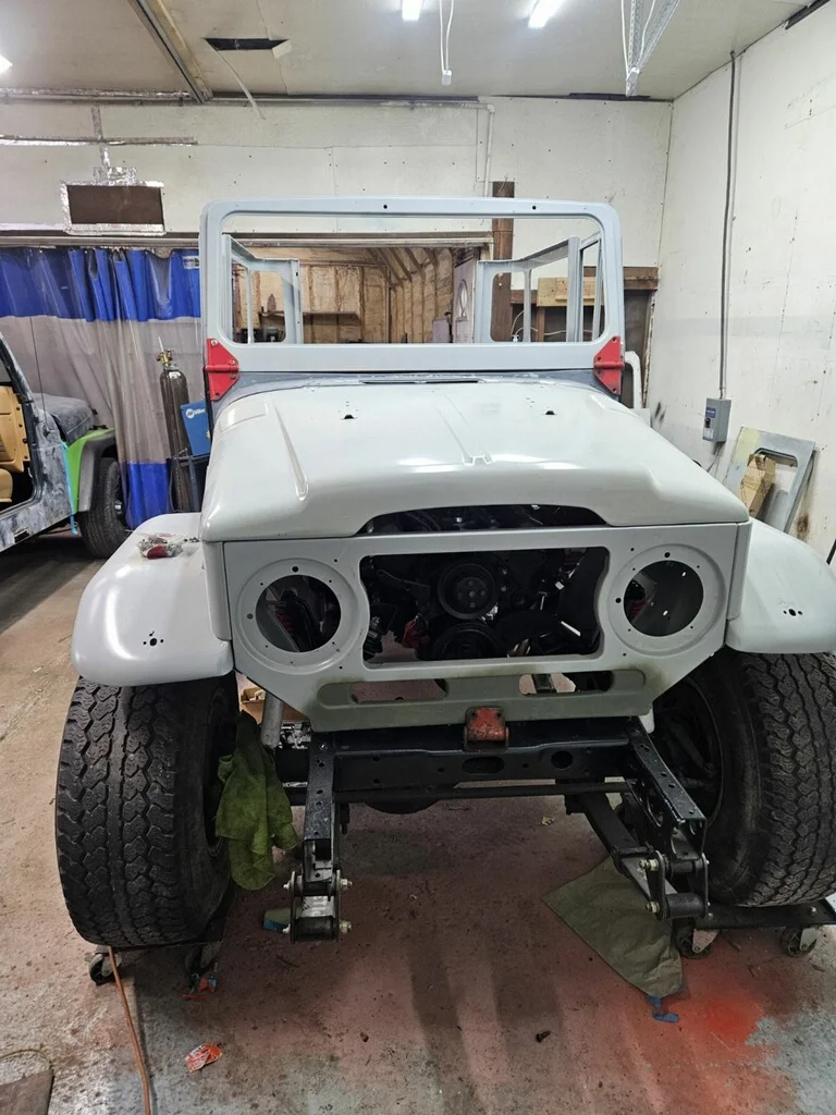

Just wanted to put out an update on this rig. The frame up is coming along well: 1) rebuilt the 350, 2) dropped in 4-spd w/ split case from fj60 using AA bellhousing, 3) powder coated frame and added 2” lift kit, 4) stainless steel muffler that routes above the skid plate, 5) new quarters on tub along w/ other misc floor repairs, and 6) sandblasted & primed all other body parts. Just waiting on the hood and hardtop sides to come back from sandblaster. Here’s some pics.
Man, you're flying along. Looks great!
Dang! Nice work!!
What color is it going to be? Original color?

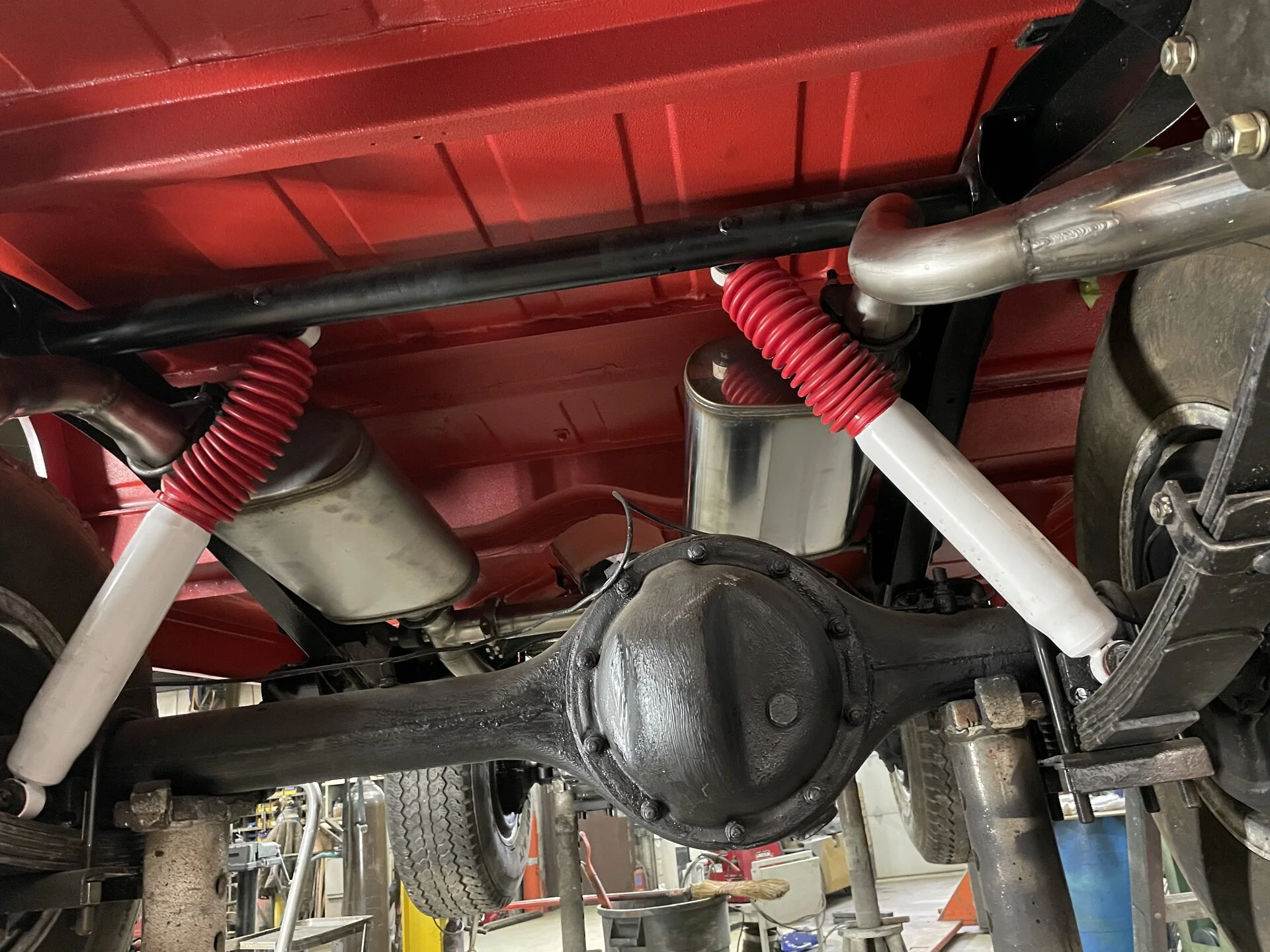

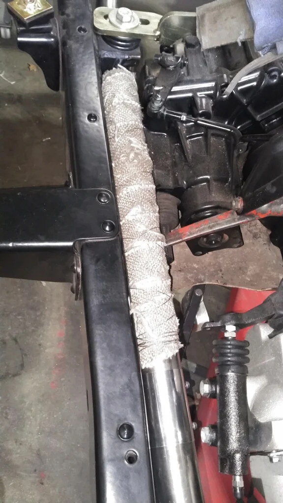

I'm surprised you ran the exhaust down the passenger side. That's a pretty tight fit. I hope you made allowances for the trans/tcase to be removed in the future without much of a hassle.
Yes. Here’s a pic… it is run above the case so the case/trans can be dropped. For heat issues there is insulation. However, after seeing the pic again, I’m gonna extend the insulation to protect the clutch slave. Thx and have a great day.
I've always run my slave on the drivers side. Either works. Looks great.

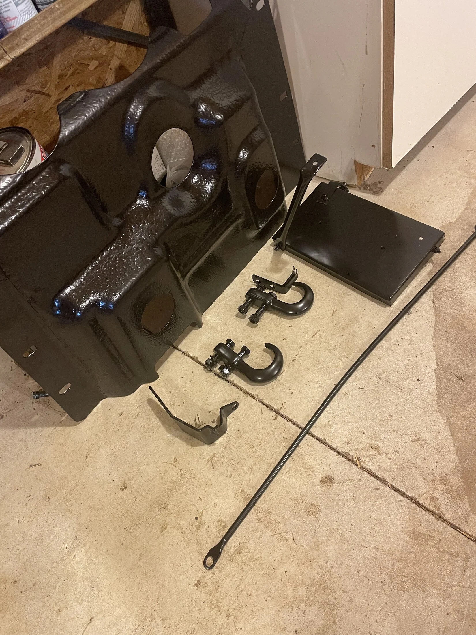

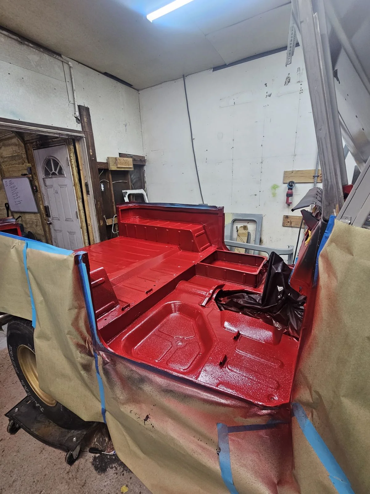

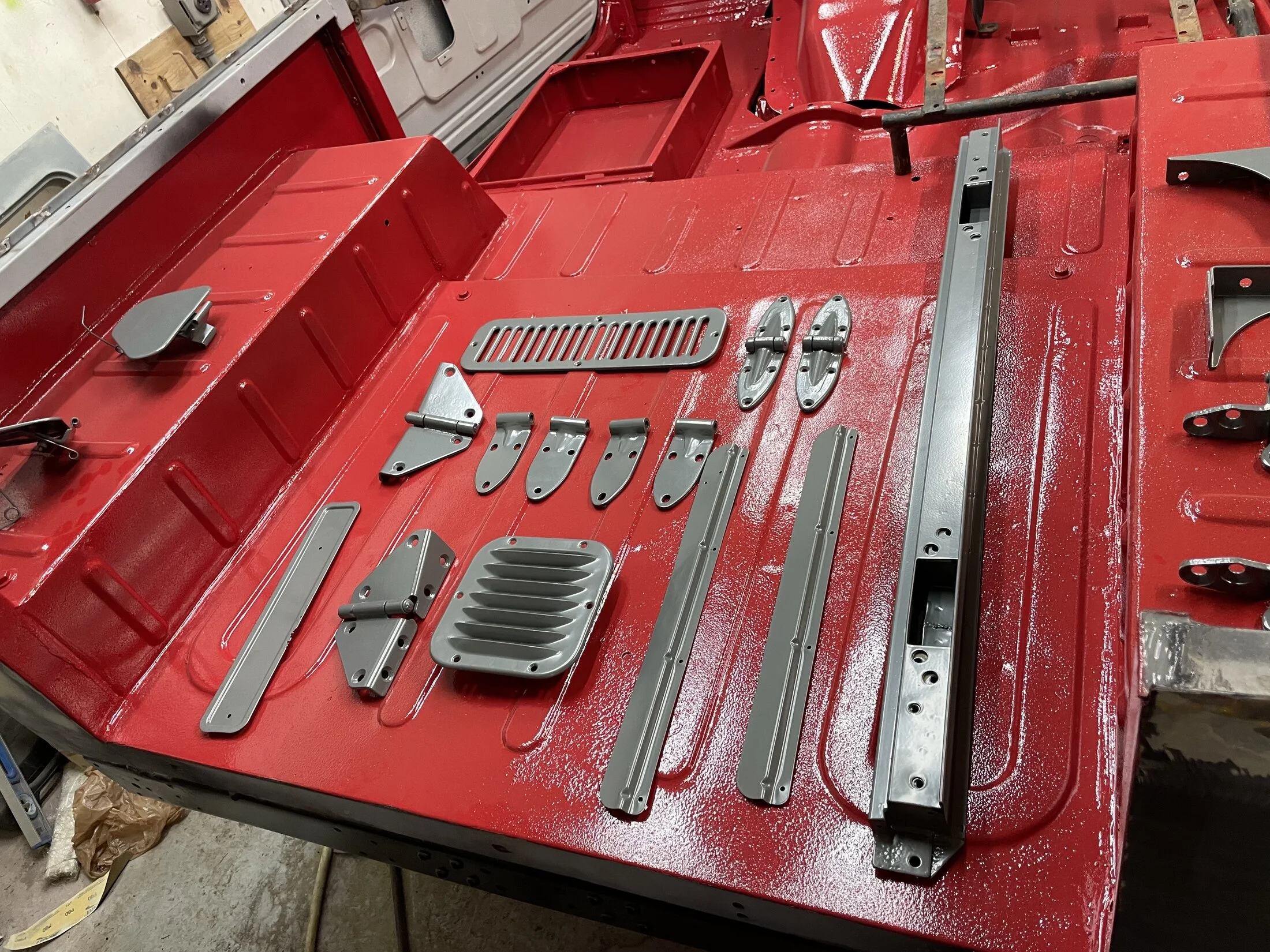

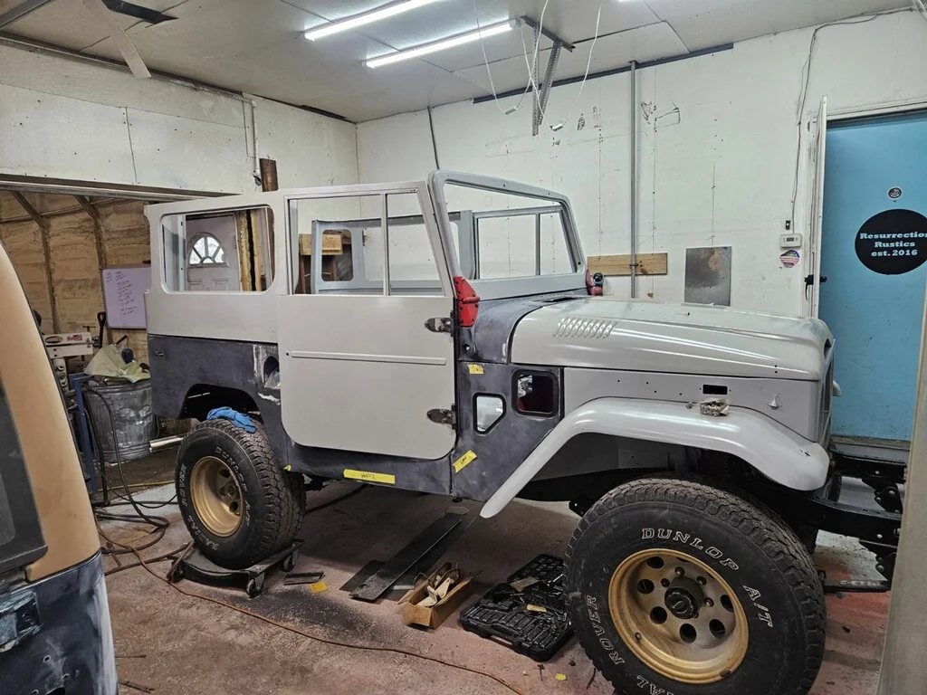

Picked up a ton of powder coated parts for my builds. The ones for this build were done in primer, and a few black pieces too. Now that I have these, paint can happen—yippee!
