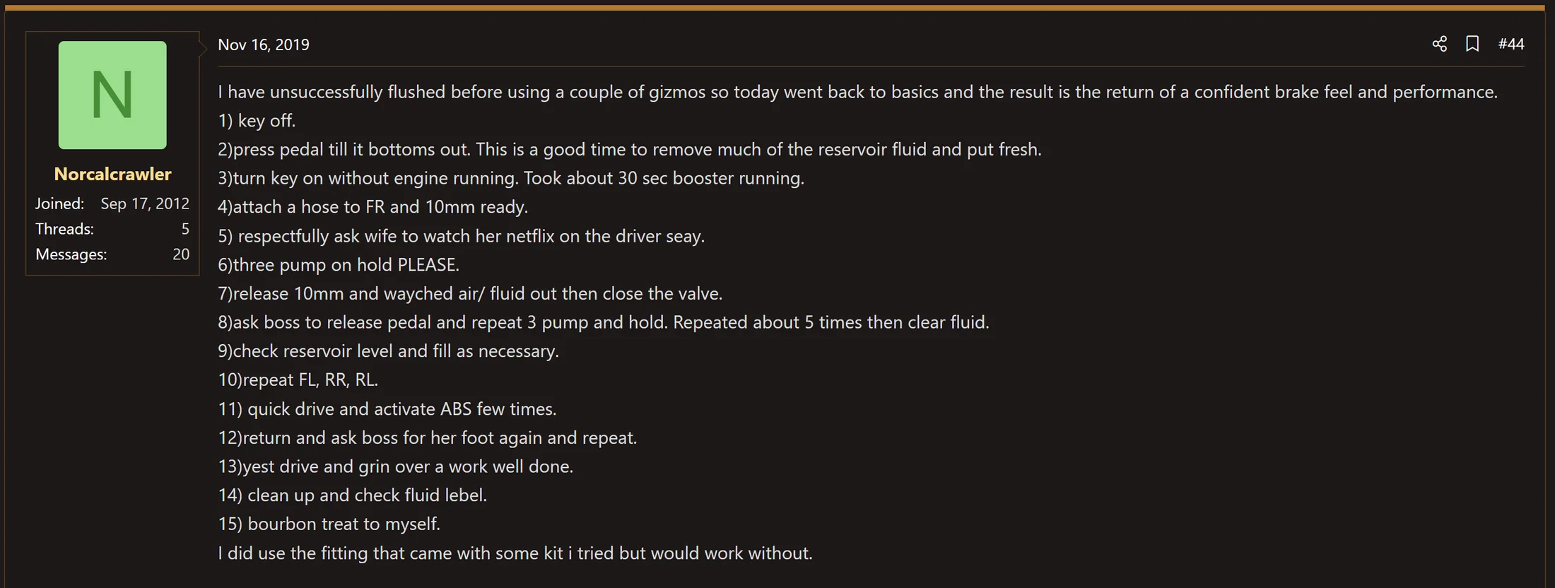

i don't know how to quote other posts... re: brake fluid change, this post seems to be the most straightforward, but this part of the FSM is confusing me (see below). do you press the pedal 20 times for each wheel before cracking the bleeder screw?

Those instructions are for bleeding the booster, not each line.

so you press the pedal 40x with the ignition off, then turn it to ON and press it 20x more and then start bleeding each line following the procedure @Norcalcrawler outlined?
