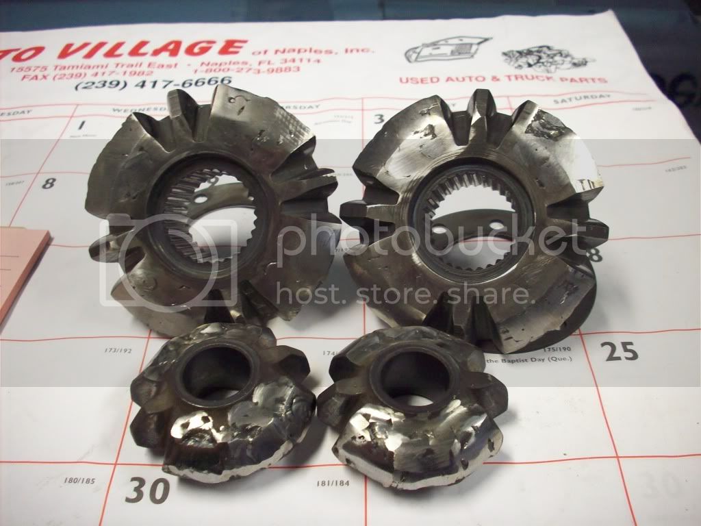

update just got gears back from my buddy all ready to install for the weekend i will kep yall posted
Thanks George!
Heat, weld, wrap and cool slowly. Any other tips, gonna do this tomorrow.
