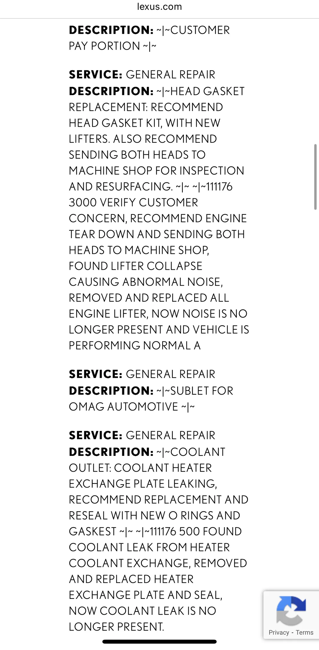

I am in a similar situation to OP, and found one that has solid dealer service history but shows a head gasket replacement due to coolant leak into cylinder. Would this be a concern or glad to see head gasket replaced already at the dealer? See below from Lexus records.
The dealer wouldn’t have done it if they couldn’t warranty the work.. which means the block and head must have been within spec for such a job.
It’s still a bit of an unknown. But at least the PO paid a dealer vs a shady mechanic to do the job..
Another consideration is how long ago was the work. If it was just done and then immediately put up for sale, I would be a bit more concerned than if the repair had some years and miles on it.
