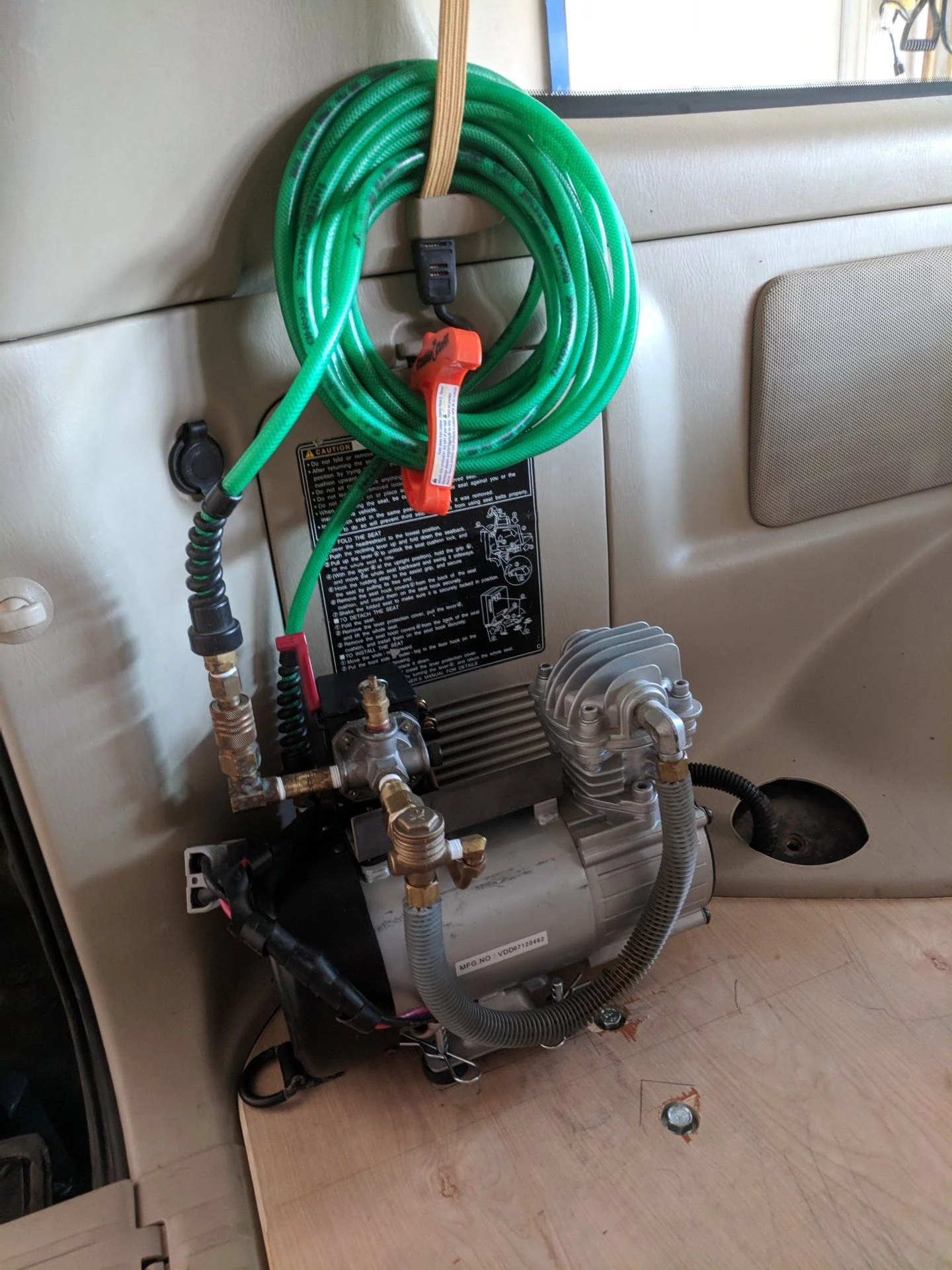

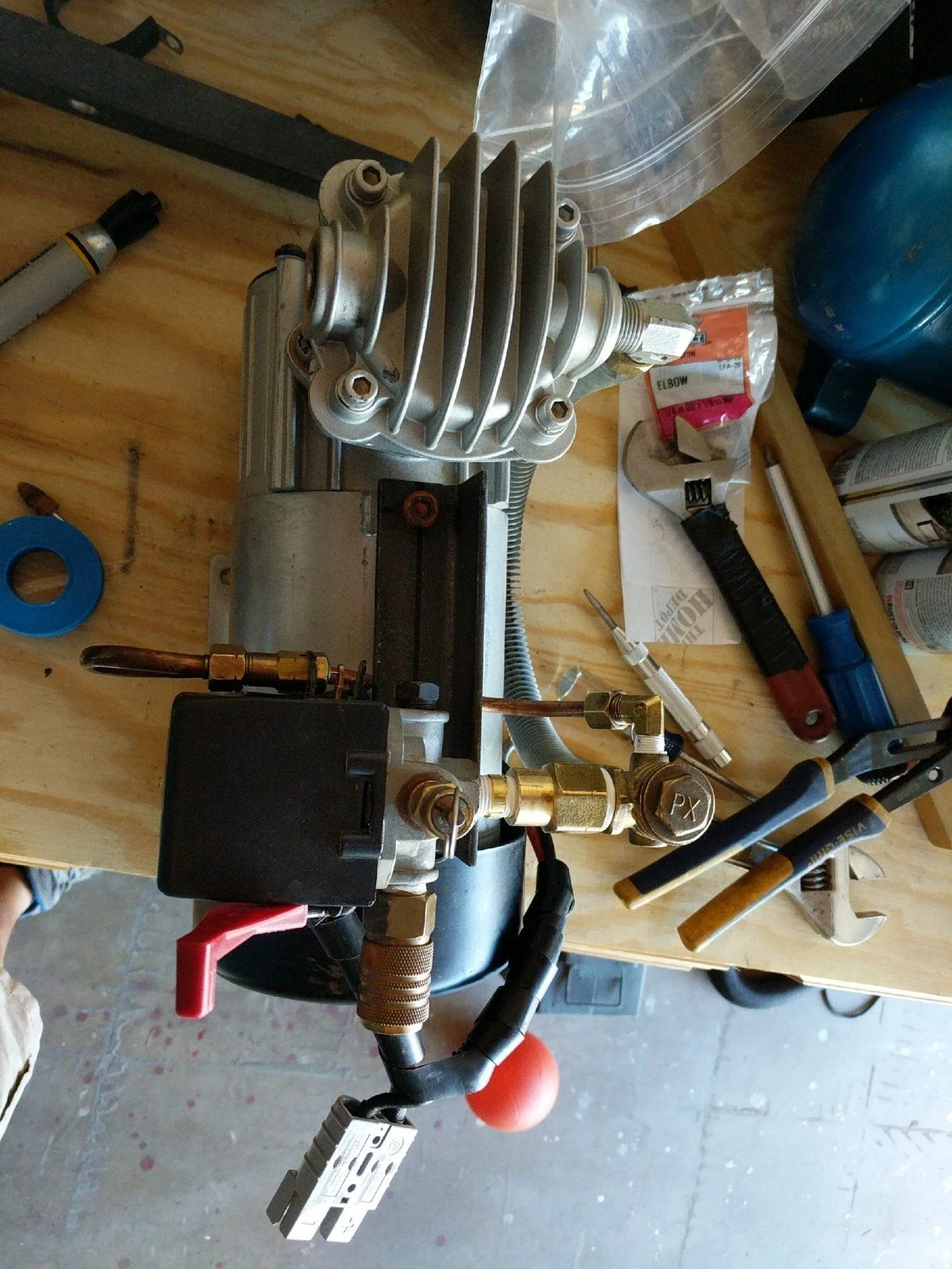

I tested the PUMA with and without a tank and unless you are running tools I would run it without a tank due to size providing you fully understand the controls. I found the performance difference to be minimal. If you do divorce the PUMA be aware of pressure switch, unloading valve, and fuse it properly for safety.
Divorced ran live in a LX470
