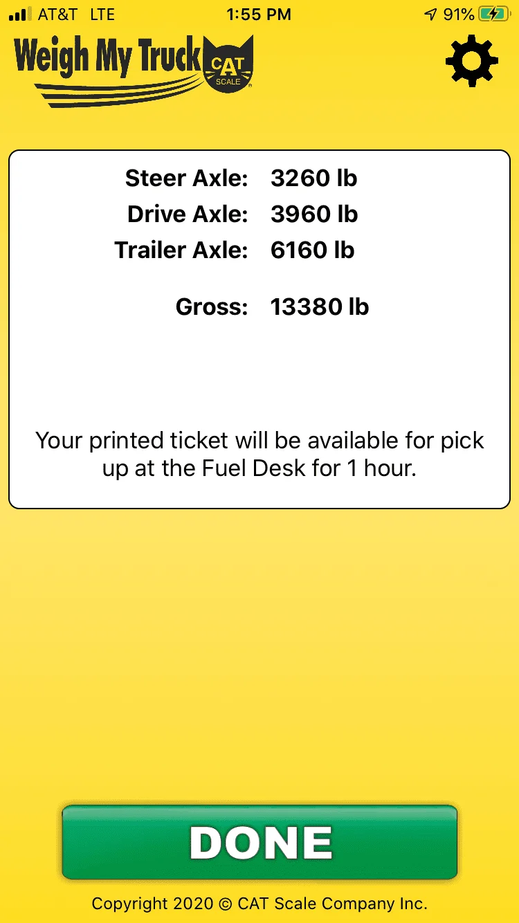

We picked up a new Travel Trailer this weekend, I’m a bit nervous, the cruise control caused erratic shifting and significant fluctuations in RPMs. I then used standard shifting to keep it in 4th gear in mountains at 3500-5000 rpms, much smoother Drive. Here are my specs and data from truck scale.
2018 LC 200 plan to pull travel trailer On I90 from Seattle to Chicago in Nov. Our 2018 LC 200 has
BF Goodrich All Terrain T/A
LT275/70R18 125/122R
Load Range E
total weight of Travel trailer and LC weigh 13380lb at Scale.
Curt 1000 lb WD hitch with tension bars installed. One tension bar is making a whining and creeping sound.
we do love driving the LC and overall it pulls well.
Aadvice and opinions?

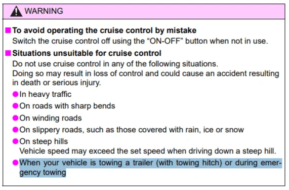

It's not recommended to use cruise control or radar cruise when towing. It's stated in multiple places in the manual. Probably more as a safety issue, but it does state that it is not intended for this situation.
Load Range E
Crazy. I use my cruise all the time pulling my camper. Could not imaging driving 2,000 miles with my foot on the go pedal. Probably just the lawyers talking.
