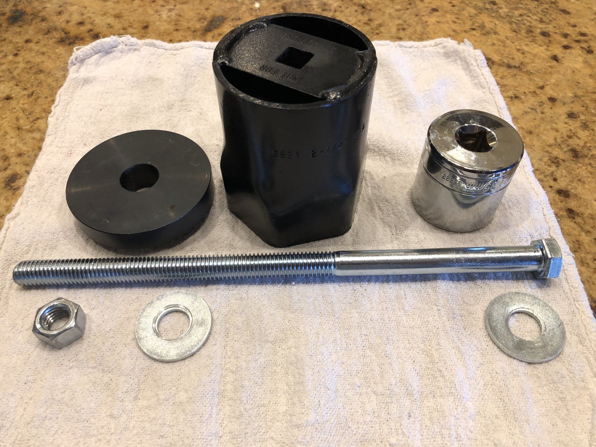

I corrected one fully built 2000. Had same issue, tried everything. I replaced both front LCA's and #2 bushing of LCA. I found LH #2 buhing, needed extra spacers for LCA to fit in a relaxed position. Pull in steering corrected/stop. I suspected, accident resulted in some frame misalignment. I've since, seen one more, that needed more than one spacer.
