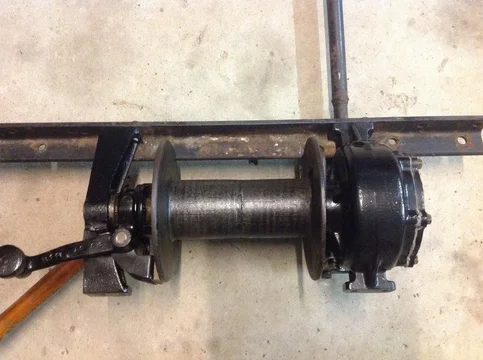

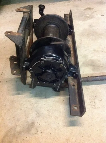

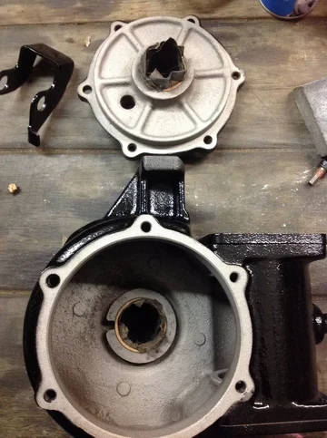

I enjoyed breaking the pto down, it was fun, sandblasted and painted, new bearings, gasket and seals my pillow blocks were shot as well, so I replace those bearings which were fully sealed, bonus as the seals for pillow blocks not easy to track down. image.webp image.webp image.webp
Yes the pillow blocks may be okay but the seals and bearings in them are not.
Good idea to use fully sealed bearings.
