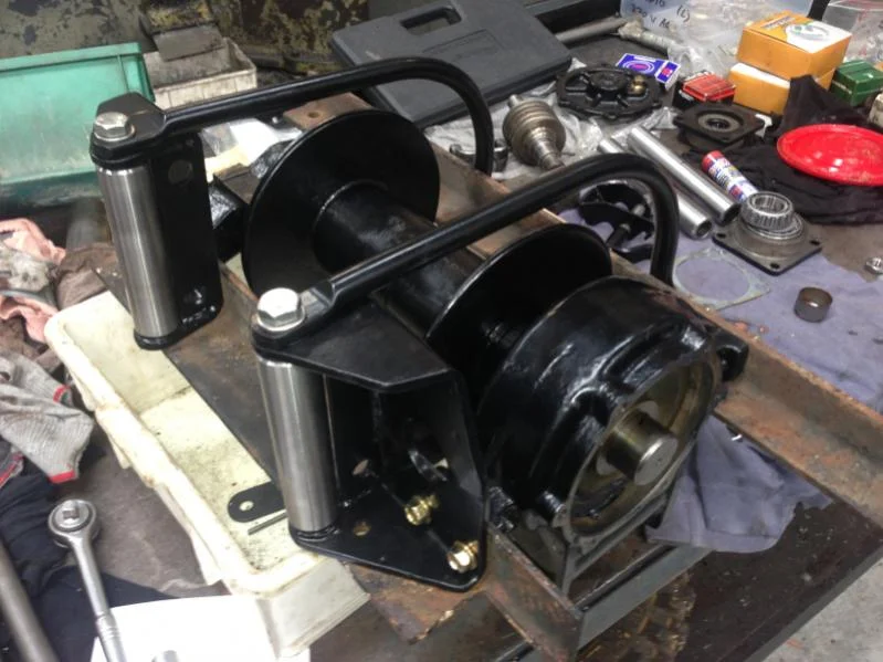

Hi all
Is anybody able to provide a photo of both the method the genuine PTO winch chain uses to connect to the cable and also an original hook?
I gather there was a hook of some description after about 2m of chain? Here's where I'm at....

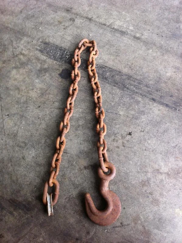

pto chain
Andrew, here is one I sold a while back,not easy to find, I will keep my eye out for one on this side of the pond! Cheers M8!
Andrew,
Nice looking winch! Did you machine the rollers, they look new. I had mine Cad. plated, it would be nice to have some out of SS.
Thanks.
Thanks Gents....
I had a buddy machine up the rollers out of stainless and new spindles for them from bright bar, which I now need to get zinc plated. I'm also looking for a black coating resilient enough to use on the rollers...not sure if such a thing exists. If not, that's okay, the stainless looks pretty neat.
