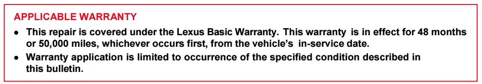

PSA: Tech Bulletin L-SB-0013-25 Fixes Hood Flutter (GX550)

It corrects hood flutter through the use of urethane foam and some 3M NVH products (3MTM NVH Dampening Material 200 ML Cartridge (04274)

since the bulletin mentions it is due to failure to the mastic between the hood skin and the brace, one would assume they modify the adhesive, clamping force, or amount of connection points to the brace. If they dont modify the shape of the brace to have more contact points, they would need a foam insert applied from the factory.

not sure, but my GX is at the dealership now getting this done. I'll report back. now, if they can get the roof rack noise to go away...
update? thanks!
The dealership did their thing and no more hood flutter! I also removed the roof rack over the weekend and I am liking my car more than before. It has taken me 15K miles to get there... Next will be to find some crossbars to take the place of the factory rack. I need them for my Thule box.
