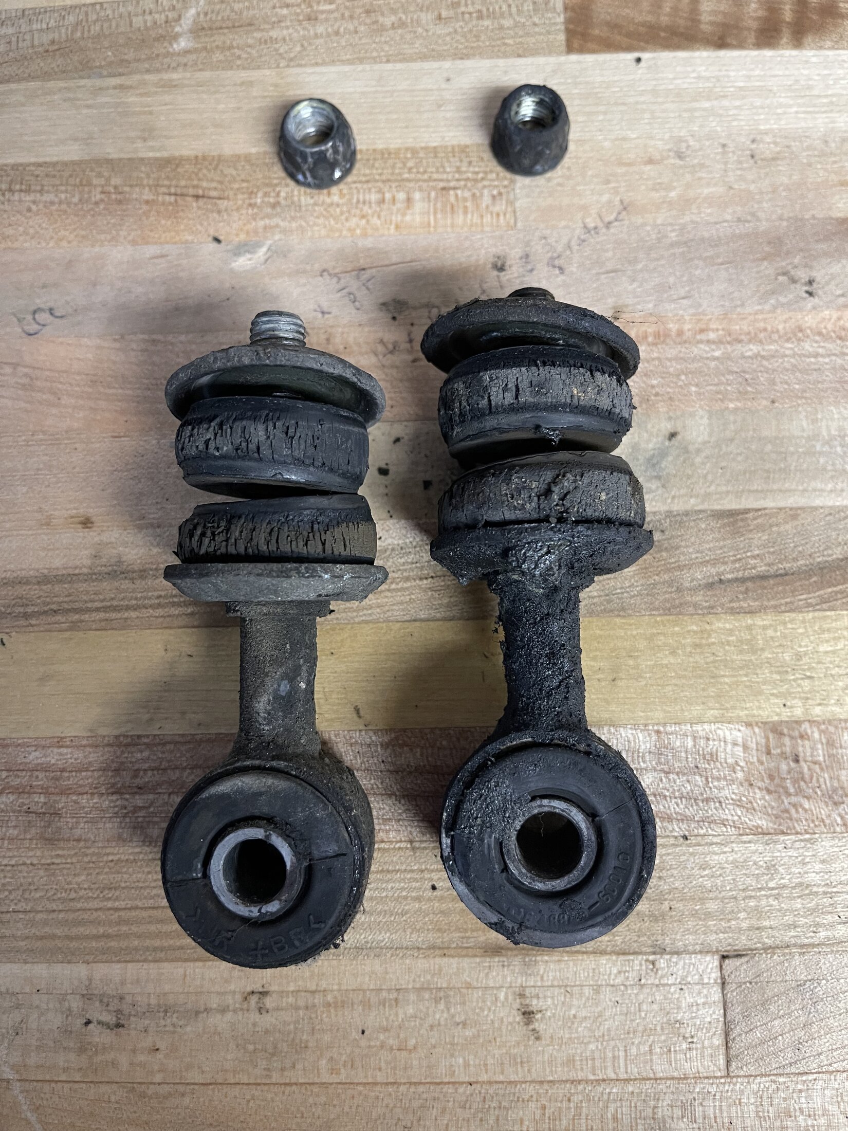

Same here @Kuzushi. Was thinking of swapping the end links to the extended ones. I did the AHC delete and replaced suspension with the IronMan FoamCells. Way less body rolls after the change. After seeing the state of my end link bushings I was going to swap for the extended option. But I think changing all the bushings would probably make better sense.
Did you replace the actual sway bar bushing too? I have a set of 4 going to wait for a nice to day to do it.
Did the rear links (super pro extended) and bushings (trail tailor) and the front links (trail tailor extended) on my otherwise stock suspension LC today (well, I did the rears last weekend). I ran out of time/willpower to do the front sway bar bushings though, maybe tomorrow... The rear link bushings looked much better than the front.
