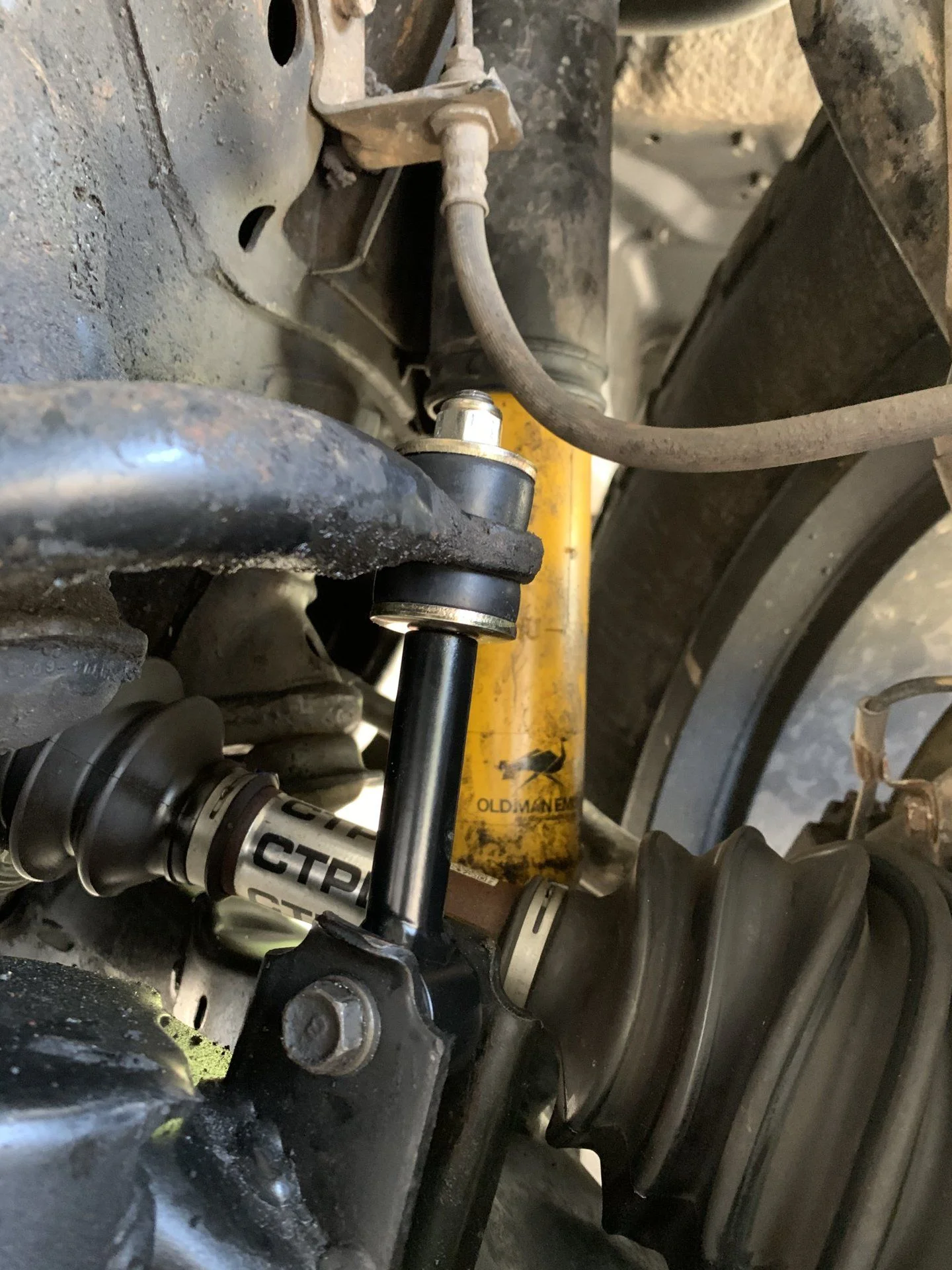

I wanted to put out a PSA on extended front sway bar links. I am not sure if they were not available when this 04 was built. It has 2.5 inch heavy lift from OME with ARB front bumper, slee skids, and slee sliders. Tires are 285/70 R 18. I changed to Trail Tailor extended front sway bar links yesterday and it is like I have whole new 100. Drives so much better. I highly recommend these to anyone with a lifted truck. The truck before the change always felt the front end was bound up and very tight. Feels back to stock now, just sitting 2.5 inches higher. It took under 30 minutes and did not remove the wheels. All my bolts were cooperating. ;<)

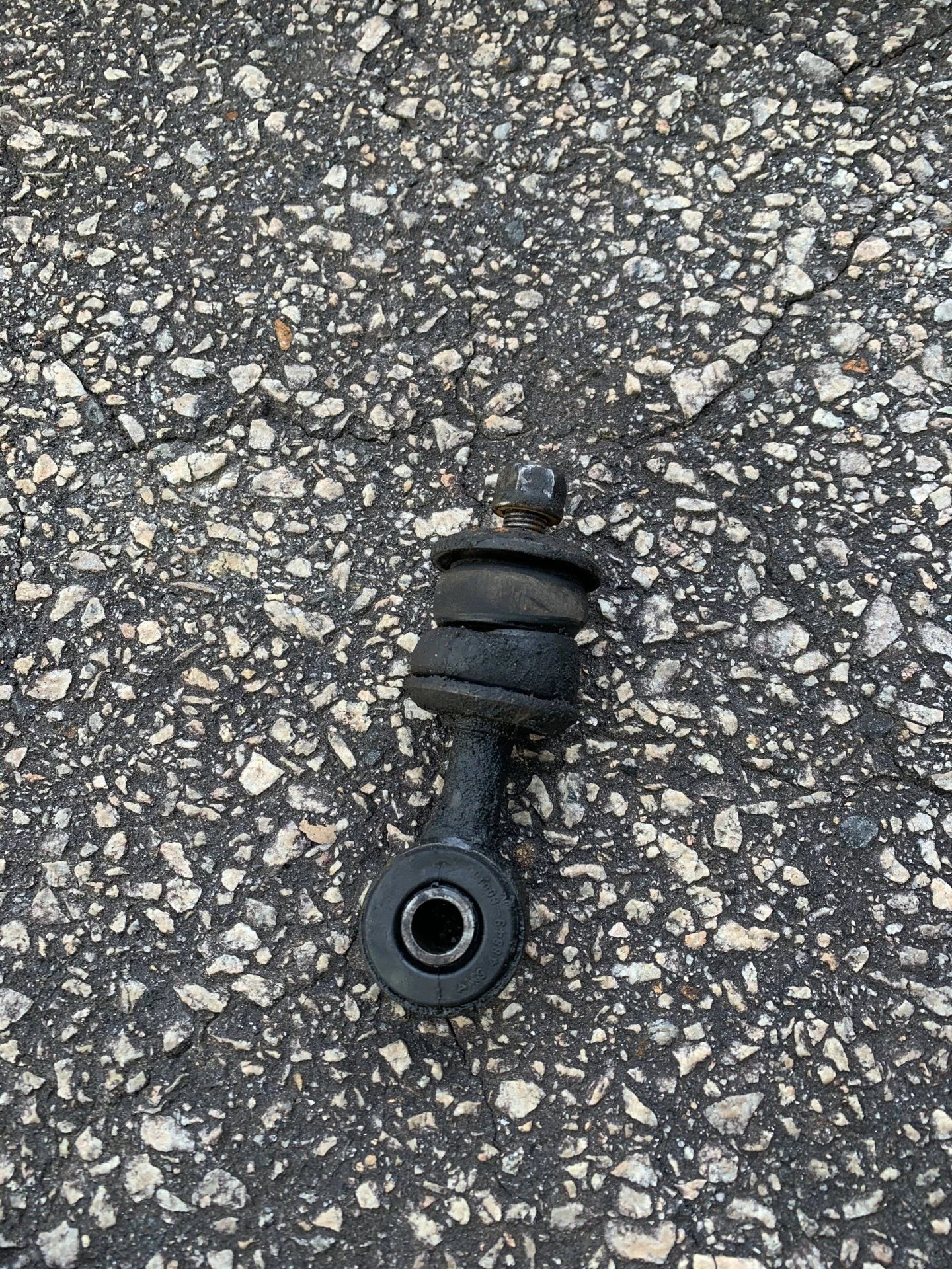

I agree. Just feels 100% better. Before it was really stiff over bumps. No longer. Flexes better going in and out of drive ways. Feels like back to stock. There was a ton of tension on the stock sway bar links when undoing the top bolts. They wanted to pop off. No tension with the longer ones. Not really ride quality, just the fact that the suspension cycles easier. Still stiff with the OME lift. More like drive quality.
Less than 30 minutes however my bolts cooperated. Did not jack it up or remove wheels.

Thank you for all the insights. Learning a lot. Took my twisty road to work this morning and drive the 100 very hard. The VSC did not engage at the same curve at the same speed. The body roll is probably what I am experiencing. The backs were already done when I bought the truck. So much better. Not ride quality, drive quality. The front end feels like it is doing what it is suppose to now. Before very charring and tight. With the stock links everything seemed bound up. Best $110 I have spent on a 100 in a while.
