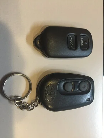

Hi Everyone,
I've been troubleshooting this since I bought my 97 CE a few months ago. It did not come with a key fob. I confirmed that I do have the RS3000 (control unit under driver seat) and I was able to clear all remotes and get the beep/light flash when doing so. I have not, however, been able to program either of the replacement remotes I purchased.
Photos of the two I've tried:

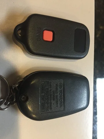

The Toyota branded one says Part No 08191-00860
FCC ID BAB237131-013
The Aftermarket one comes from this ebay seller and claims to be
RS3000 - BAB237131-022
New Replacement Keyless Entry Remote Key Fob For RS3000 - BAB237131-022
SO - since neither of these worked (fresh batteries and all) are there any other models of key Fobs I should try?
Thank you!
Alex
i actually just purchased the aftermarket one from the same seller, im about to return it, i couldnt get it to pair w my 97 Anv ed. I was going to get one from the toyota dealership, but did you also go that route and not have it work?
FWIW
The back of mine has "FCCID: SRW-KRVAR001" molded into it. And my truck is a '97 LX (I don't know if that matters)
Tonight I tried the SRW-KRVAR001 with no luck. 3 Fobs down... any more y'all recommend I try?
So far I have tried:
SRW-KRVAR001
BAB237131-022
BAB237131-013
I push/hold the green button on the rs3000 unit,
after 3 seconds the red light on the dash turns on solid for 3 seconds
then the red light flashes for 5.
I have tried pressing the key fob button during the solid and during the flashing, and have done it with/without the green button pushed simultaneously.
What am I missing?
