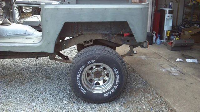

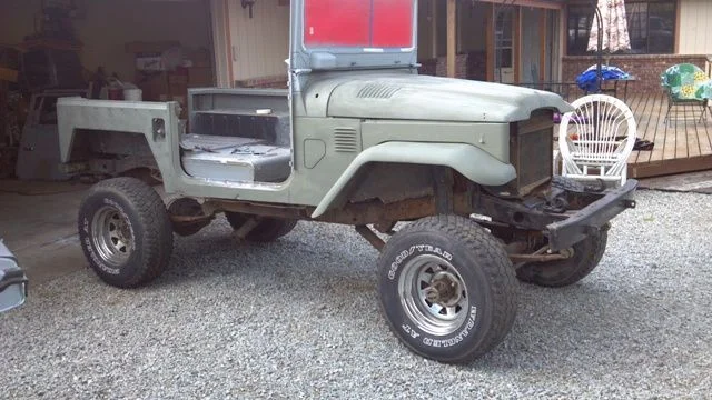

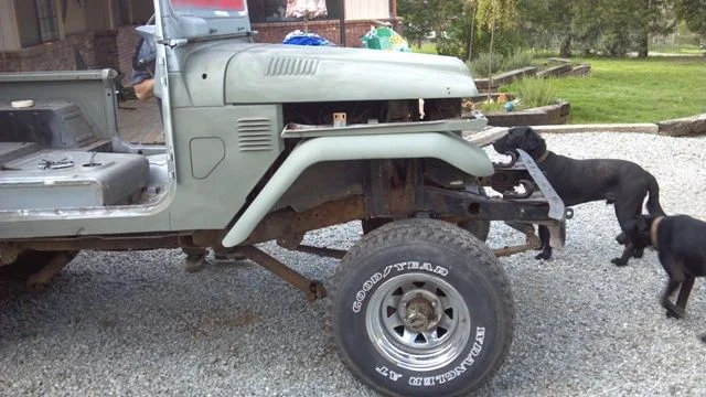

Are you moving the rear axle back or is it just the angle of the pic that is making the rear look way off center. Or is it just me,... Being retarded as usual
Looks to me he's made some extra room to stretch the wheel base back there. Glad he didn't go overboard, I always think it ruins the lines when the wheel well is brought all the way around the back of the truck.

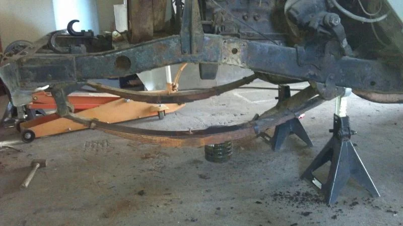

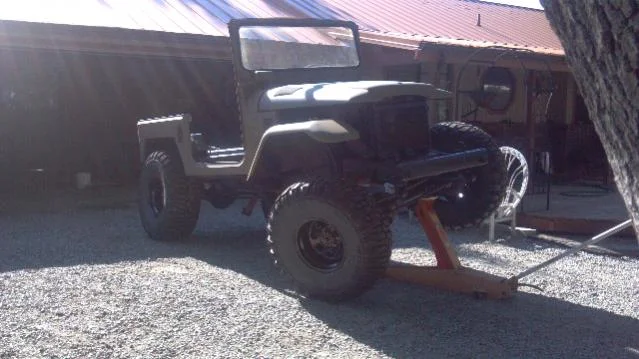

alright, got a bit done on the 40 today.

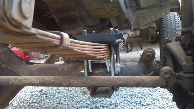

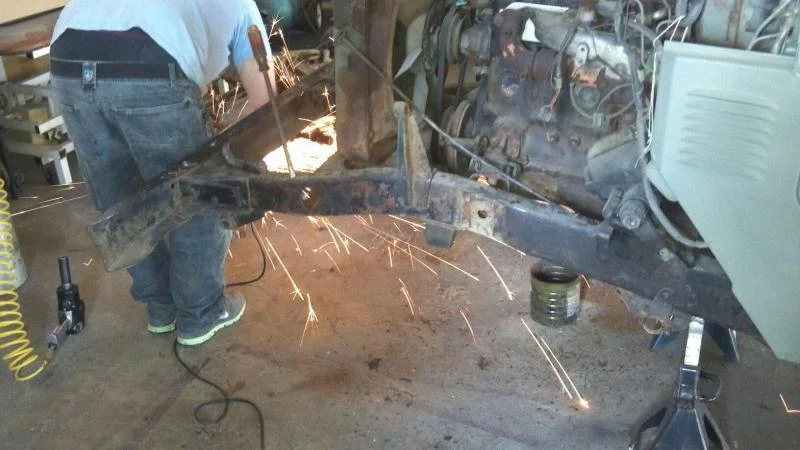

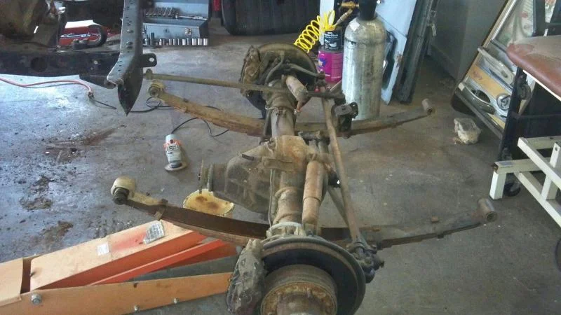

pulled the axle

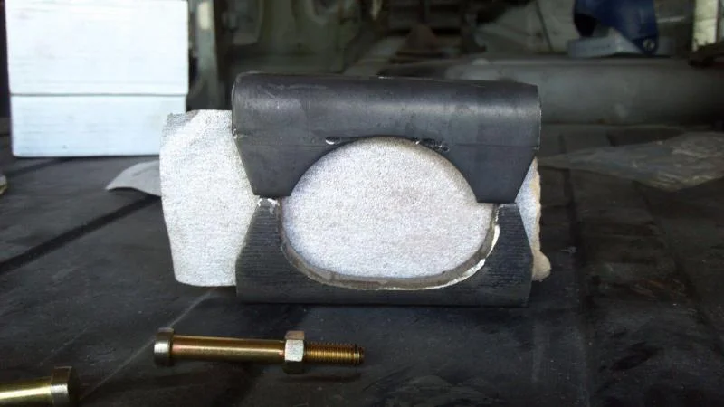

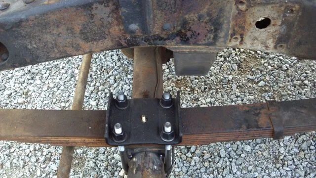

flipped the springs, made new pins.

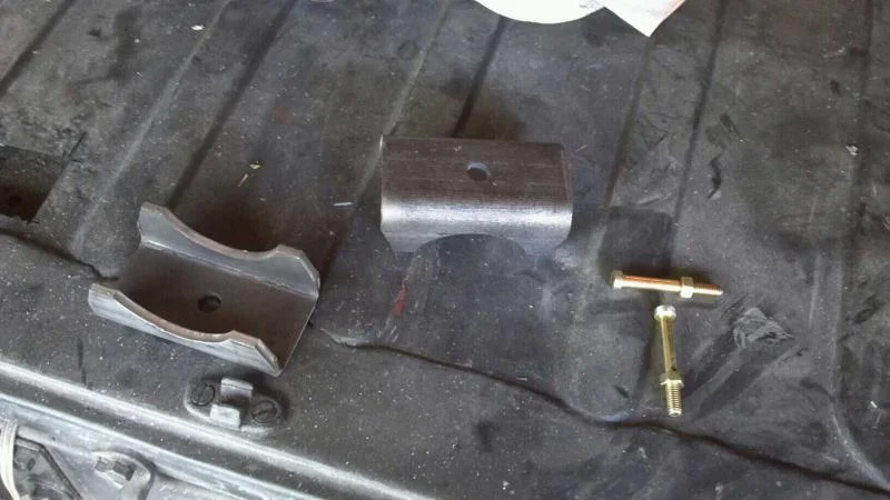

modified the new perches.
the new brake lines are here, as well as the new ubolts.
i guess still up in the air on the front brakes. when i saw they were vented, i thought someone had swapped them, but i guess not. so we will see if it has late knuckles on it later.
so i love it when a plan comes together.
the spring over is pretty well done.
need to weld out the perches.
springs are flipped end to end, gaining roughly 8" of wheelbase.
i am thinking the springs may need to be reworked to drop an inch or two.
its gonna be TALL when the new shoes show up.
picked up the ubolt kit and stainless brake hose from man-a-fre. (great selection, weak ass website, looks like its the OG design from 96 :rolleyes: )
still need to swap the brakes and knuckles.

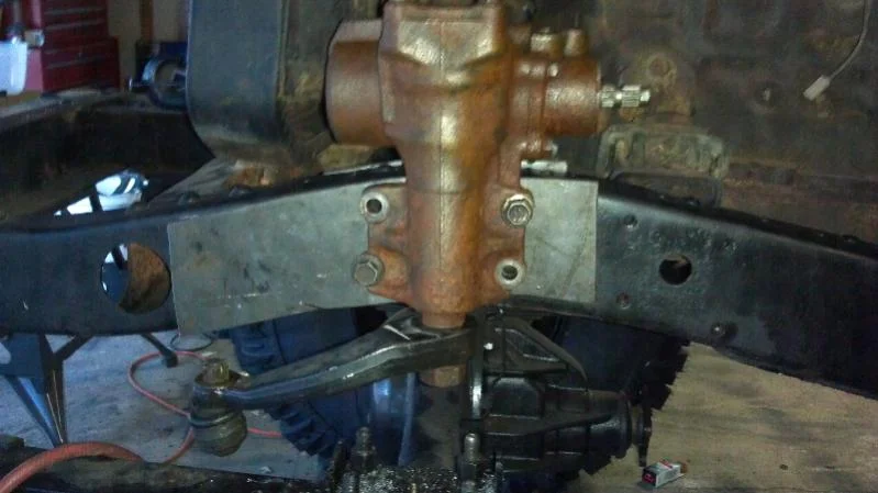

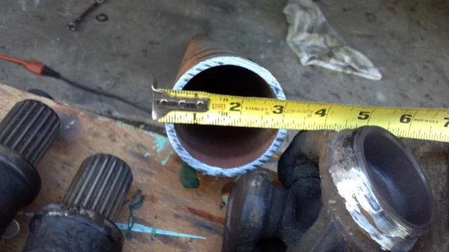

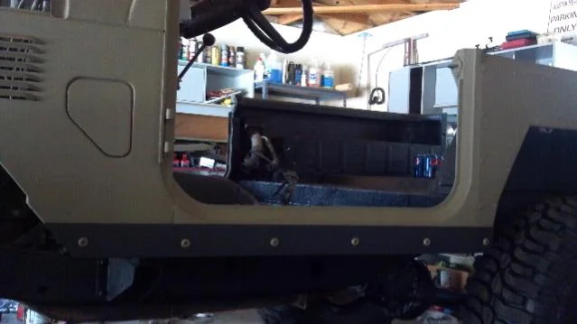

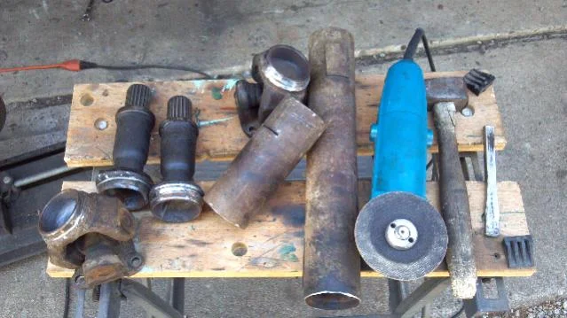

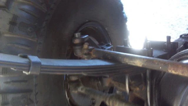

Need to mount the steering box. We got material to sleeve the tie rod and drag link. Ended up having to source an 80 pitman because i guess the taper in the 60 one is queer. We decided to build our own drivelines. The rockers are 2x3. 3/16 angle.

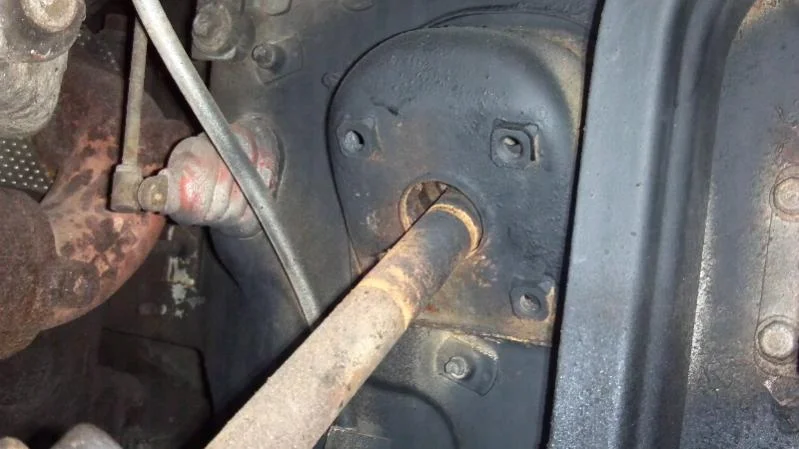

So is there a bushing or something that goes in this hole. 78 fj40 steering column at firewall

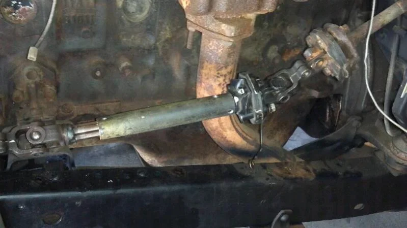

Steering box and steering shaft. Tr and dl sleeved. Working out ps pump bracket now.
