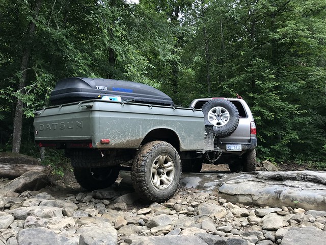

Recent Photo:

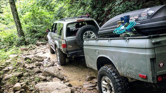

Coppinger Cove - July 2018
Bryant Cove Flat Rock - July 2018

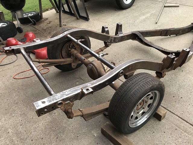

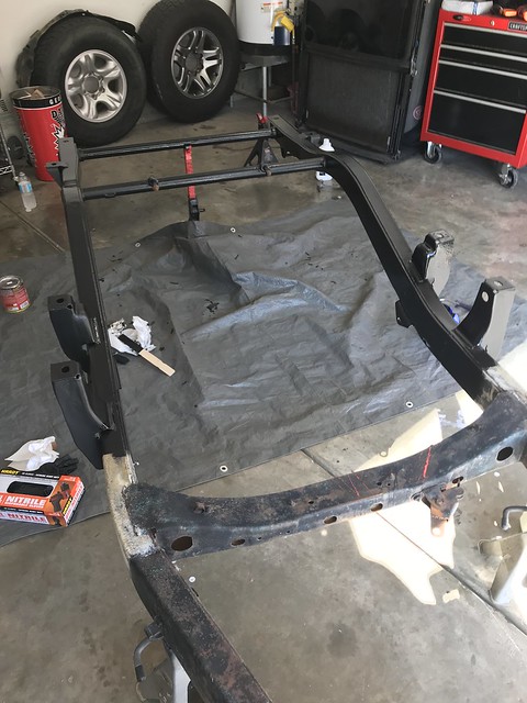

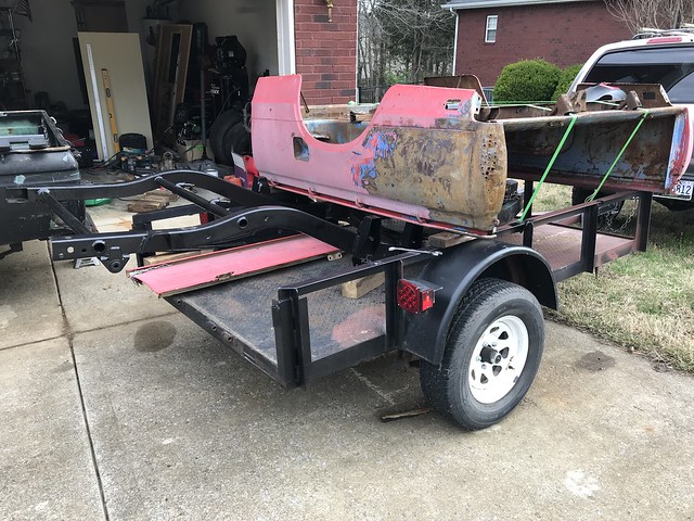

The original Junkyard Dawg was separated, the frame was cleaned and I slathered some POR-15 on everything but the tongue. My plan was to rebuild the tongue and patch up some rust rot.

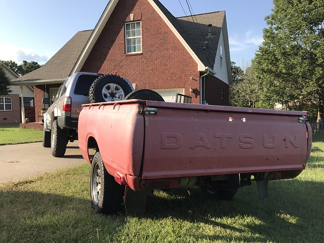

The one thing that bugged me about PJD1.0 was the tailgate. The bed/frame was a Datsun 620 (1973-79) and the tailgate was from a 720 (1980 and later). It “fit”, but it didn’t match the body lines. Finding a proper replacement proved near impossible. While searching, I found PJD2.0 and gave up on the original.
I finally put it up for sale and got what I paid for it. Sold it to one of the hosts of the Nissan Nation Podcast.

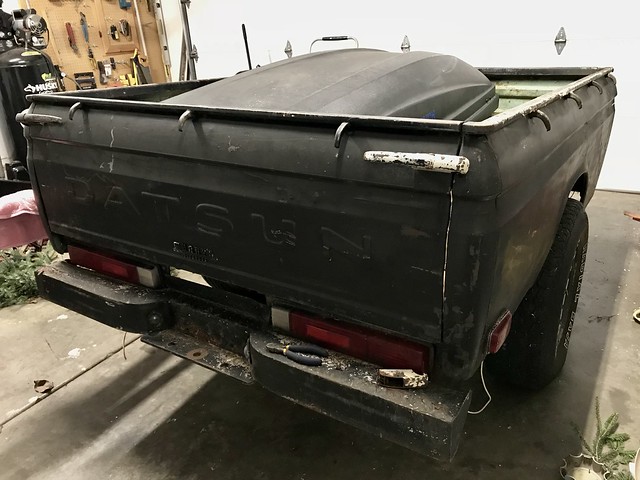

In December of 2017, I started the build by replacing a broken tailgate latch. A guy in Oregon (the hot bed for old Datsun trucks) had a spare one that he sold me for a reasonable price. My favorite parts of these old truck beds are the latches and the rail hooks. Gotta love the embossed tailgates, too.
I also used some paint stripper to start removing the black rattle can. Oh, how I wish that OE green color had been left alone.

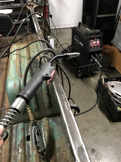

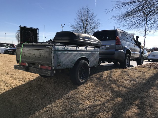

January 1, we took off to visit mom & dad in Southwest Georgia. I decided to load up the tailer to help carry Christmas presents. I also had an alterior motive...I picked up a multiprocess welder on the way down. One of the major reasons for PJD was for me to learn how to weld. I don’t have a picture from the day I picked it up, but it’s an Eastwood MP250i. I know it’s not a Miller or other name brand, but it was priced right and does what i need.
Chick fil A parking for off road trailer to be.

After getting the welder home, I got some flux core (because no gas yet) and started trying to figure it out.

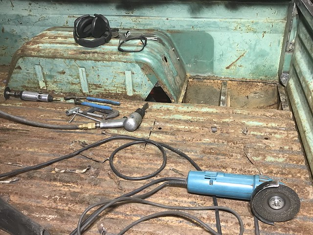

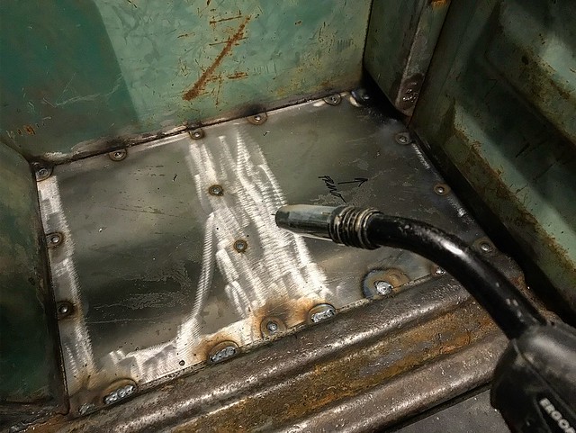

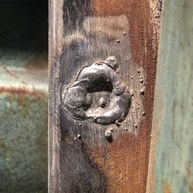

My plan is to eventually have the bed watertight for the ocassional high water crossing that I’ve been known to participate in. So, I started plugging some holes and repairing some rust rot.

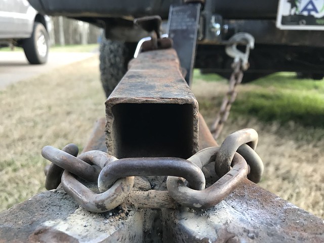

I had been using a 10 foot tree strap as my “safety chain”. I remembered that I had a length of chain in my shed and went to welding again. Having a welder makes some repairs so easy and convenient.
It might be ugly, but it worked. Forgot to put the hitch pin in the draw bar just so I could test the chains. Doh!
Isn’t that tongue made by a previous owner kinda janky? I’ll remedy that later. But, for now, it works.

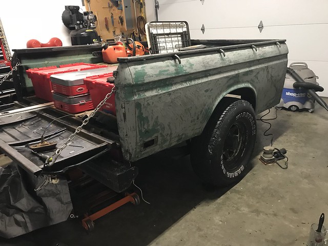

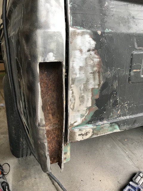

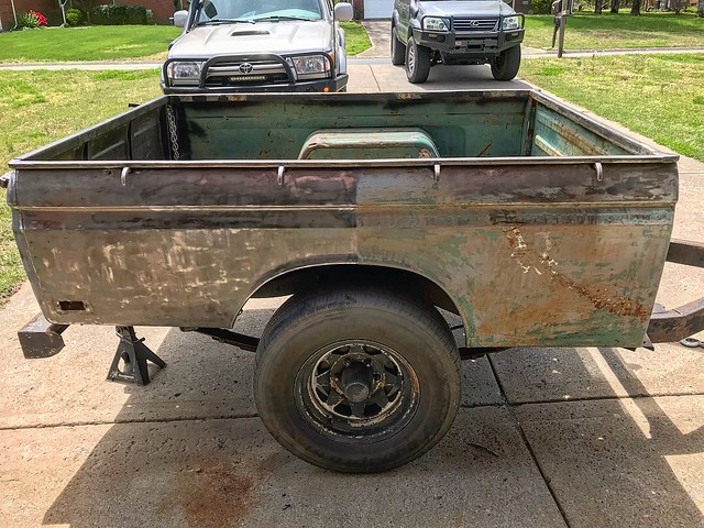

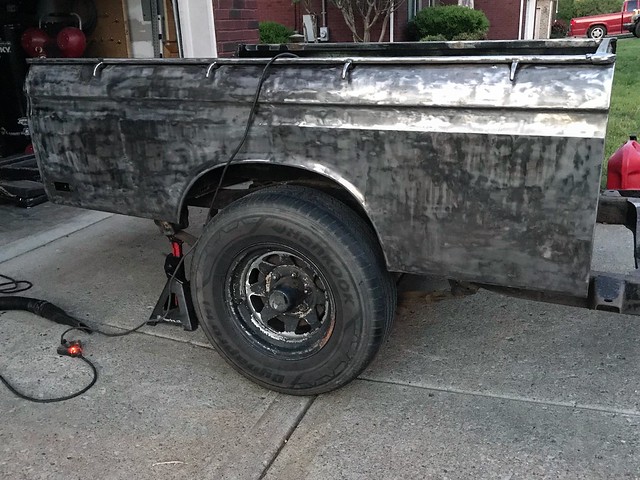

The paint stripper was very messy and toxic, so I decided to use a wire wheel instead to remove the paint. It was messy as well, but not toxic (with a proper respirator).

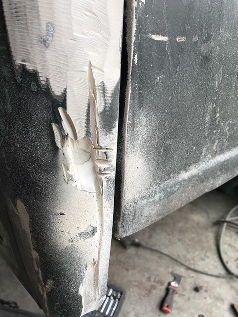

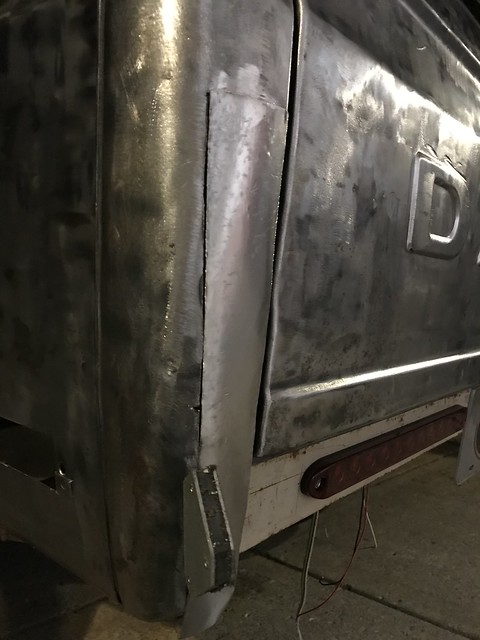

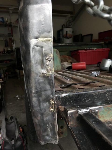

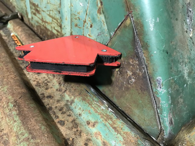

While grinding the paint off, I found some of that nasty...and very thick... Bondo. Ugh! I cleaned it off and found a mess of a repair job underneath. I eventually cut that mess out and attempted to patch a panel in. My attempt at sheet metal repair failed, so I cut it out again and have left it alone thus far. I have a plan in place now to add a water and air supply in that area with a closeable lid.
The patch panel turned out great after lots of dolly and hammering work. Then I messed it all up with my inexperienced welding. Oh well.
