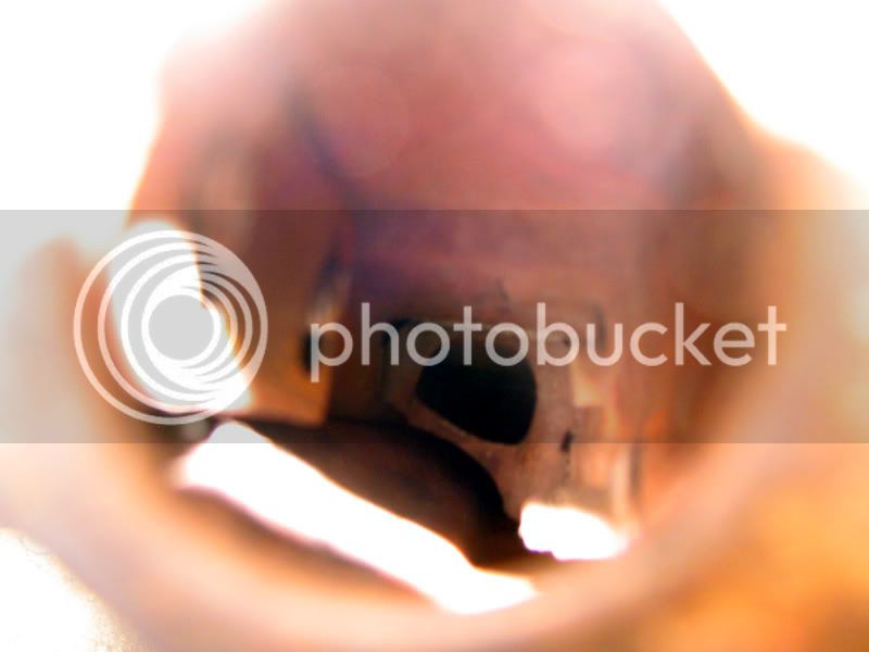

Ok, I'm working on installing my paki-top bows today and ran into a problem. I've got a factory soft top cruiser and when I tried to install the main door seam bow it would not full seat because of this.....
(does every 40 have this stopper part in the tub were the pole seats in for the hard top and soft top?)
now I'm want to cut the excess off the bow but I don't want to have any problems later. Or should I even attempt to cut out this top stopper in the tub and leave the bow alone.
I need a third opinion before I cut the bow right now....

I feel like I dropped acid when I look at that picture.
Take a better picture from farther away so I know what I'm looking at.
i actually think i know what you are talking about.. normally i thought there was just a bolt that loosened/tightened onto the tube that goes into the B-pillar (not sure if that is right) it is very possible that the stock bows didn't have as long of a tube.. i would cut the tube before i messed with the tub.
AntFj - Your right on the money, that is what we thought over here so I'll chop the thing right now.....
thanks for your advice.
S.B.FJ - I hear what your talking about but with out a strong light source hitting dead center on the post hole it comes out as a black hole. I took about two dozen shots and this is the best one. To better explain its the hole where the hard top poles line up, I have to go with AntFJ term as the b-pillar. Nevertheless, I'm going to cut it tonight and install everything tomorrow.

just a tip --on my camera there is a setting called macro and super macro that take really detailed up close shots in sharp focus
that might help you for pics like that

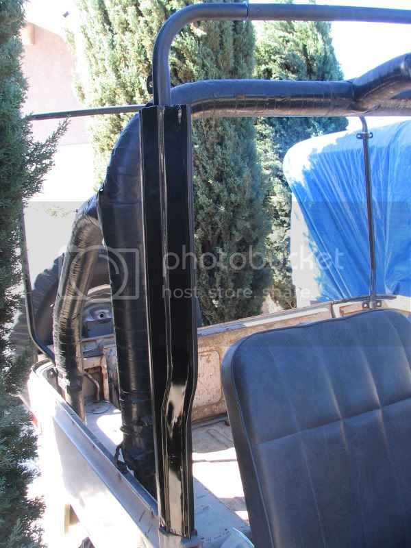

yep, i put my bows together and fit it. I ended up cutting 3 inches off...fits perfect now....
I got this far:
measured it out and realized that the post needed to be cut in half which works out to be six inches since the post is about a foot long. I'm heading to work right now but thought I'd post up the solution, it worked out good

I got this far:
I'll be done with it tomorrow.
