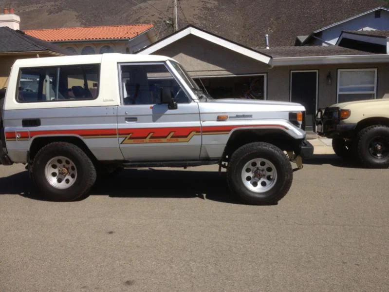

Would this fit a 2010 70 Series?
16x8, 5 on 150 Bolt Pattern
Backspace = 4 in.
Max Load = 2200lbs
Finish = Polished
Hub Centric = No
Offset = -11mm
Thank you
They fit my 1986 BJ73. Not sure the back spacing as I got them used but they came off a Chev. Silverado 2004.
it fits but it get your car to wide, the tire will be a Little bit out of the body in the front axle, the new 70 series is wider than older models
Thanks, but what about the hub centric would it fit?
