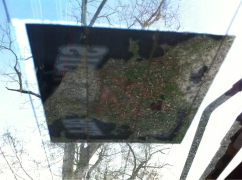

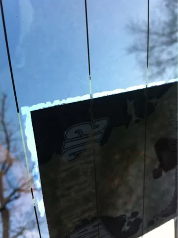

There is no aftermarket tint on this truck i had it looked at but I gotta man I know what your saying but I have 1999 Lc and in the back window at the bottom in the center someone before me that had the truck had an "A" sticker for the university of alabama I would assume... it looks to be was inside the window but the dealer that I bought from took it off and it took the tint with it! I'll upload a pic if I can get a good pic of it ,I have out sticker covering it because you can notice it

Oh no if u scratch it from the inside of your truck you will see it's not on inside of the glass - fact
Then you either:
Have a rare 100 series that came without privacy glass, and the PO tinted it himself,
OR
There is additional tint placed over the rear privacy glass.
Any film on the windows did not come from Toyota. They use solar tint glass that has the bronze coloring cast into it (as mentioned earlier).
Either way, the film is aftermarket. Remove and replace. Done.

If you have rear defrost on your 99 like I have on my 2001, you need to proceed with caution!
These guys are telling you that the "factory" tint is built in the glass. I agree and there is no way to damage the "factory" bronze tint because it is "in" the glass, not "on top" of the glass.
There is the little gold pinstripe looking things that are your defrost. You can definitely screw this up if you scrape with a razor blade on the inside of the back glass. You can tell that these little gold stripes are applied to the glass, NOT "in" the glass.
I may be reading what you are asking completely wrong and my advice may be way off. I am just concerned that you are going to take one of those blades to the inside of your rear hatch glass. :doh:
Looking up with hatch open
